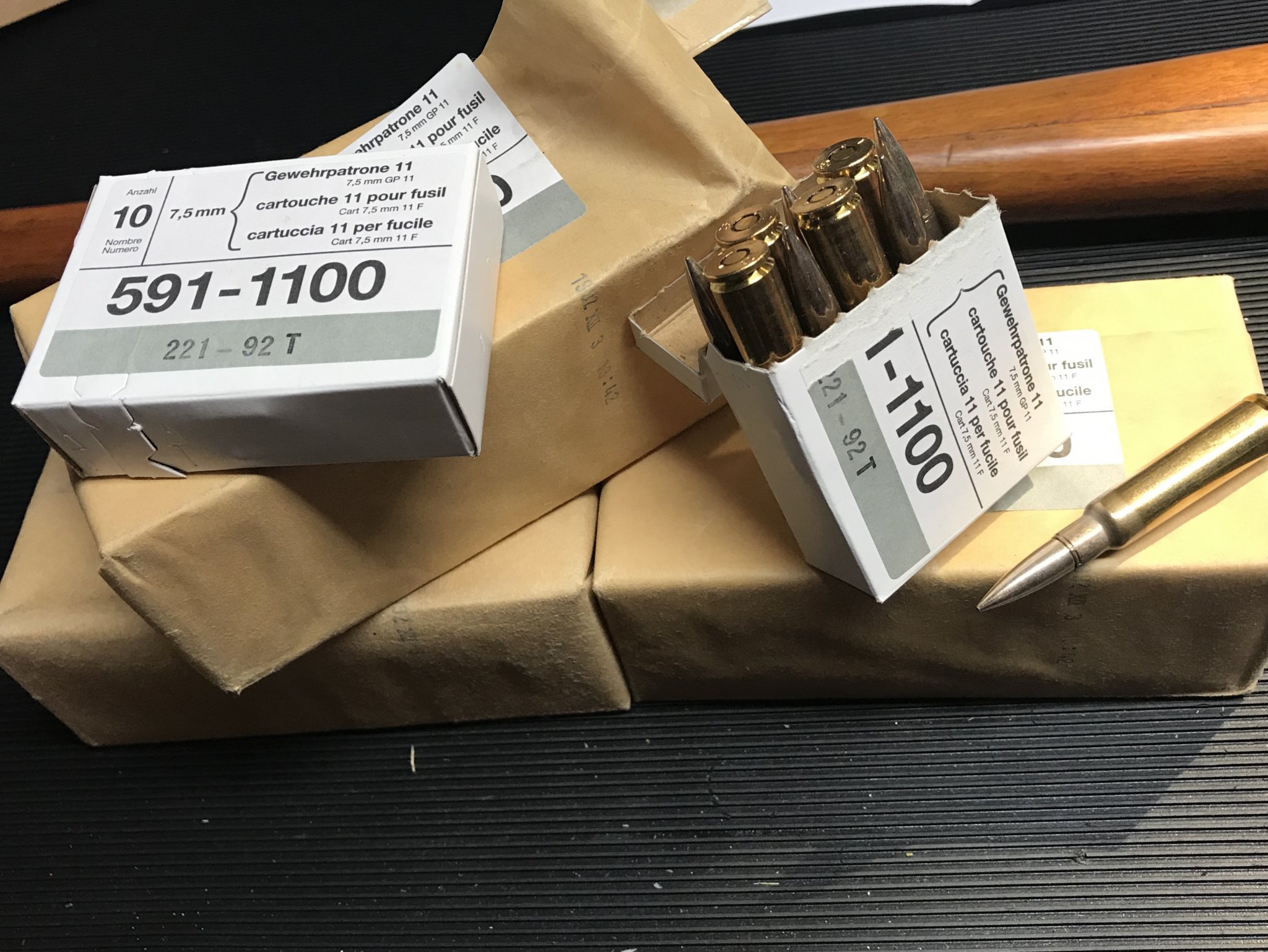

Aye. Good quality surplus but berdan primed makes it a tough take.

Match grade Berdan primed I might add. Good stuff? Yep. Not worth it at the price IMHO. To each his own however. Party on and enjoy!

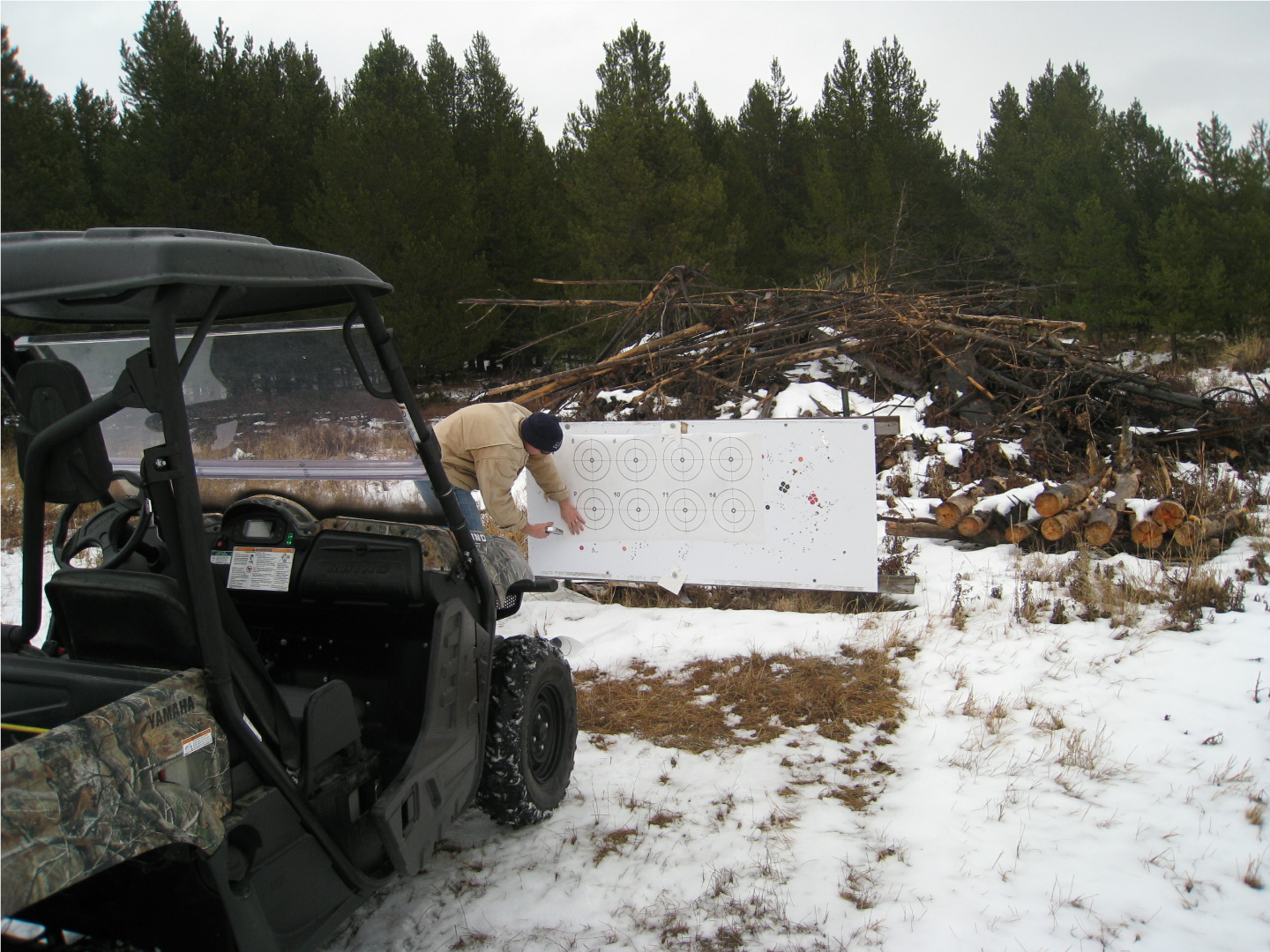

I received my custom Hornady case for measuring. I had to get a bit innovative with the comparator rod as I have the straight one (as opposed to the curved) and the length and shape of the receiver required a bit of “work around” to get it to work. Unfortunately, the results with the 175smk left a bit to be desired. It appears to be a rather long throat. In order to obtain a .030” jump, the bullet needs to be loaded quite long. It still fits in the magazine, but the amount of bullet in the case mouth is not very substantial. I’m getting a steady reading of 2.515” CBTO using the 175smk and the .30cal comparator insert. I have a test spread loaded with the 165gr PSPCL and the plan now is to see how these shoot before I start experimenting with yet another bullet and powder.
Work once again calls, so all this will be put on hold for another week to 10 days while I go out and do what needs doin’.

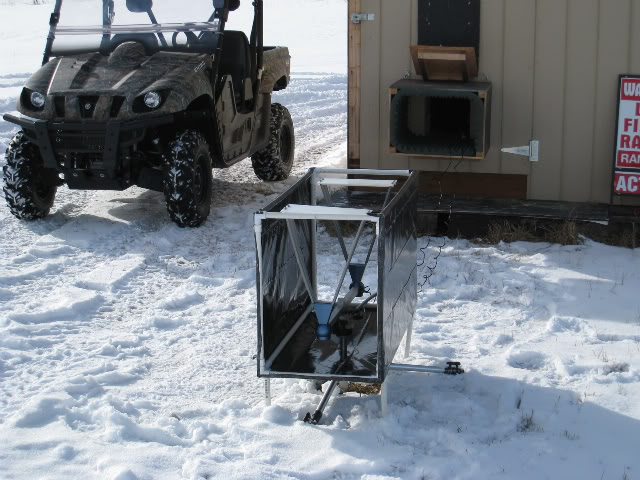

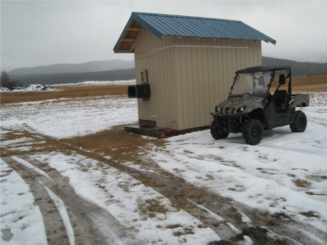

That 175SMK should be a very accurate projectile with the right powder, shallow seat depth and the right neck tension. If you feel like it, give me a buzz on the Swiss Products help line some time. It's on the opening page.
-32 here in Lost Prairie this morning, but with the heated ShootShed, it doesn't stop those who aren't faint of heart. LOL

Yea, its been quite the winter in the upper plains/midwest too... Lots of snow and cold in the Dakotas...
Thanks for the offer. Just might take you up on that. Let me see where the 165s take me. I have two other projects in que as well. A final test on a .300wm load, and a mid-process development with a 7mm RM. if I get too into the weeds with too many projects, NOTHING gets done! Lol
Quite the setup you got there. I’m jealous. My 100yd “range” backs up to the patio door, so my biggest issue is the dog barking at me because he thinks gunshots=playtime.

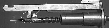

Some aren't aware that the Swiss straight-pull rifles often won't fire if the bolt isn't fully closed before pulling the trigger.
The symptoms are always the same: "the primer was lightly indented but didn't fire." Sometimes this is followed by "I know the bolt was closed because I checked after the misfire."
When the striker falls with the bolt not fully closed, a shoulder on it hits a projection on the operating rod -
7060985
If the operating rod isn't all the way forward, the energy of the mainspring tries to push it the rest of the way. If there isn't any abnormal resistance, it will usually succeed - simultaneously rotating the bolt sleeve to the fully locked position by the action of the middle section of this same projection on the sleeve's cam slot.
Since all this pushing and rotating uses up a good part of the energy stored in the mainspring, often there isn't enough left to fire the primer. The result? "The primer was dented but didn't fire. I know the bolt was closed because I checked after. . ."

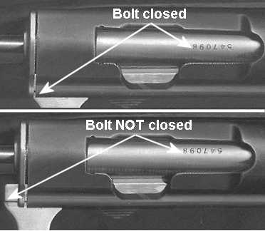

If you're having this kind of problem, try checking before pulling the trigger. With the K31, it's easy to see if the bolt is closed by looking at the serial number on the sleeve -
7060990
If that number is not at the 12 o'clock position, the bolt is definitely not closed and a misfire is likely. When you're in shooting position, cheek on the comb, concentrating on the sights, you can't see any of this and it feels like the handle is all the way home. On the 1889 and 1911 actions, the serial number doesn't rotate, but you can still check to see if the operating rod is fully forward.
With factory ammunition or good handloads this kind of misfire seldom occurs because the incremental force needed for that last 1/2 inch of op rod travel (when the extractor has to snap over the rim and the final compression of the mainspring occurs) is very small. The momentum of your arm and the bolt does the job easily.
Cases insufficiently resized and bullets seated too long are the usual reasons for enough added resistance to cause a whole string of these "rifle" malfunctions.
*Thanks for the photos Eric*
