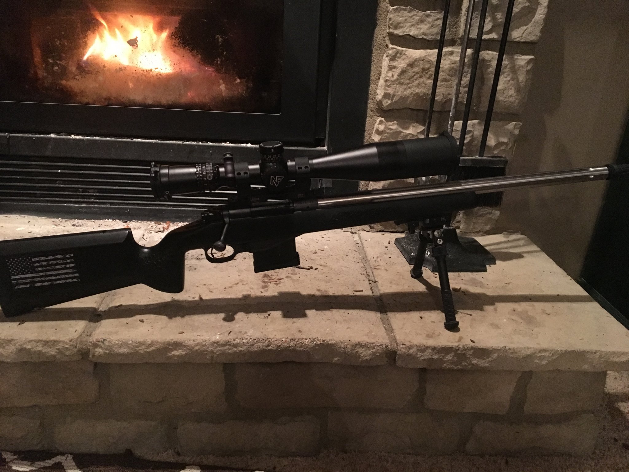

nice looking rifle.

The claw is the main defining characteristic of the pre 64 design. I’ve never heard of one without it, but I’m no historian neither

35
That is what i gatheresd..the question then becomes
1 is the picture wrong and my action actually has the claw vs
2 the description is semiaccurate i i boughy a crpf (control round push feed) action...which would be not great but noy terrible either. Ill have to call an check tomorrow

I can't get the attachment to load but that could be my isp ! . My first rifle was a post 64 push feed 30/06 light weight carbine with a pencil contour 16" barrel . It shot OK and never failed to feed or extract , it did beat the shit out of my shoulder and I got alot of dirty looks from anyone on the bench next to me while testing loads . I full length bedded the action and barrel and got better accuracy , my first venture into accurizing !
Either way these actions are solid and the triggers are very good also . Hmmmmm ! , I better check my credit union account balance .

The rifle action in the first link is definitely a push feed. Hopefully you get what you wanted.
I think your right. The part of tge bokt thats burnished was what I thought was the kick out on the extracter. Still, the crpf actions are flat bottomed, stiff and generally pretty straight. Plus it comes with dbm and rail... still not a bad buy.
The heading says pbr action. Dead give away. All pbr actions where crpf.

FN had three versions of the M70SA
CRF - Claw extractor
PF - Push Feed with sliding plate extractor, cartridge is pushed into the chamber and the extractor snaps over the rim
CPF - Sliding plate extractor with bottom of boltface machined out allowing the cartridge rim to slide up under the extractor
To my knowledge all 0.470" SPR's are CRF. PBR's can be CRF or PF, depending on when they were made and what chambering. PBR-XP's in think are CRF.

The SPRs have a pretty big firing pin and with higher pressure loads, or softer primer cups will crater and blank badly. I bushed mine to .062 and cured that.
The action in the first link is a CRF. The picture appears to show a push feed, but the text description states that it comes with a CRF bolt.
These actions are a pleasure to work on and are very true out of the box.
Dont bother buying an aftermarket trigger. A competent smith can make the FN trigger into a fantastic trigger.
If you need any drawings for the tenon, floorplate or pillars, i made and posted technical drawings and solid models of my work on grabcad.com

HEy...good to know there are win70 crowd in a rem 700 world. Lol.
i think i will be happy either way. I think the win70 crfp are fine, just confused as to what i just bought. If it is a crfp i can see not investing as much in a build.
buffymaster nailed it with the listing of win70 variants. Intrestingly the win 70 crpf is most lkely the forebearer of the mcmillian crf action.
i called midwest but the lady answering the phone was not all that familiar with the technical minutia. Not that i would expect her to be. I may call back and ask to speak to an in-house technical guy.
the burnished area looks like it may have housed the connecting ring for the mauser claw. dont know what would cause that burnishimg patern on a crfp.
i will keep yall updated.

Mine is a Benchmark Sendero contour, finished at 23".
I vote for the Proof Research sendero. The carbon fiber looks uber cool.
