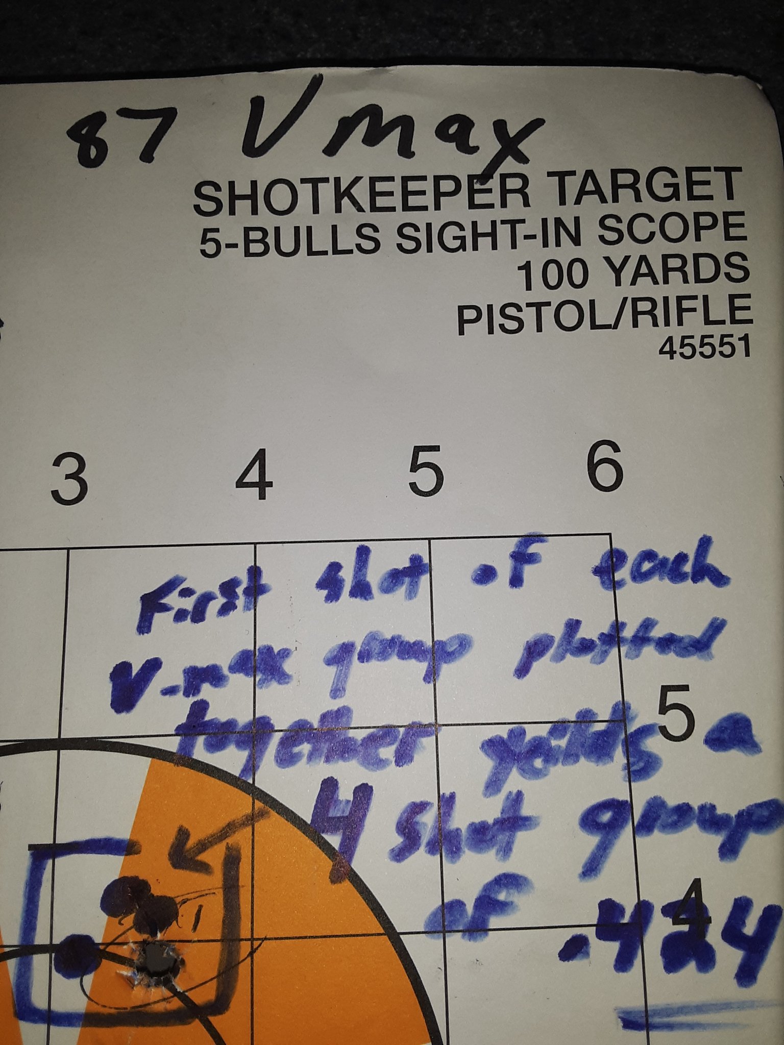

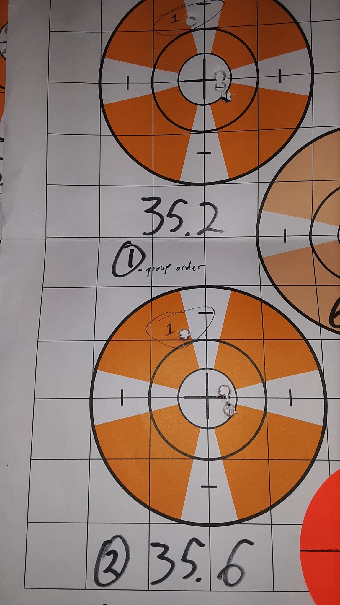

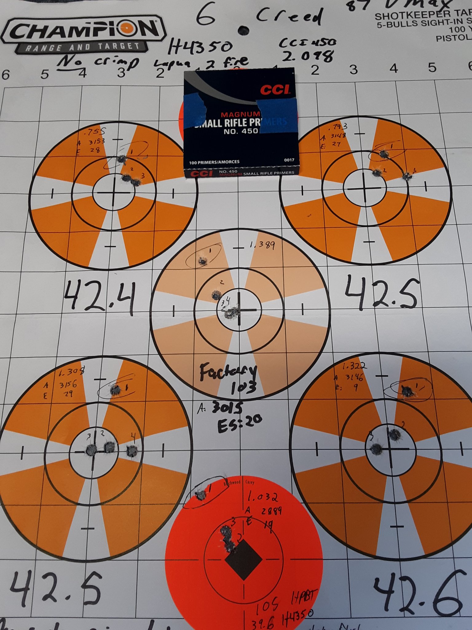

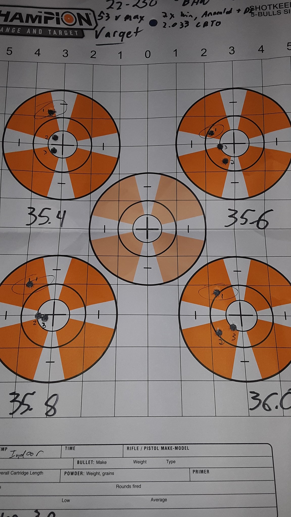

I have a rifle / can combo that is doing this. See thumbnail. I tested 3 different bullets, including a factory load. There was just a few minutes of cooling between each group.
Rifle: 6 Creed AR10
Can: Dakota Silencer Varminter 3.0, 30 cal
Whats odd / frustrating is that this same can / rifle combo did NOT do this initially. I want to say the first 500-600 rounds did not show this. Also, I use this same can on a Desert Tech, and it does NOT do this.
So what gives? Are maybe the threads on can, rifle, or both not lining up the baffles with the bore perfectly? Even so, why just the first shot of the group?
FWIW, the first shot of each group was very consistent.
