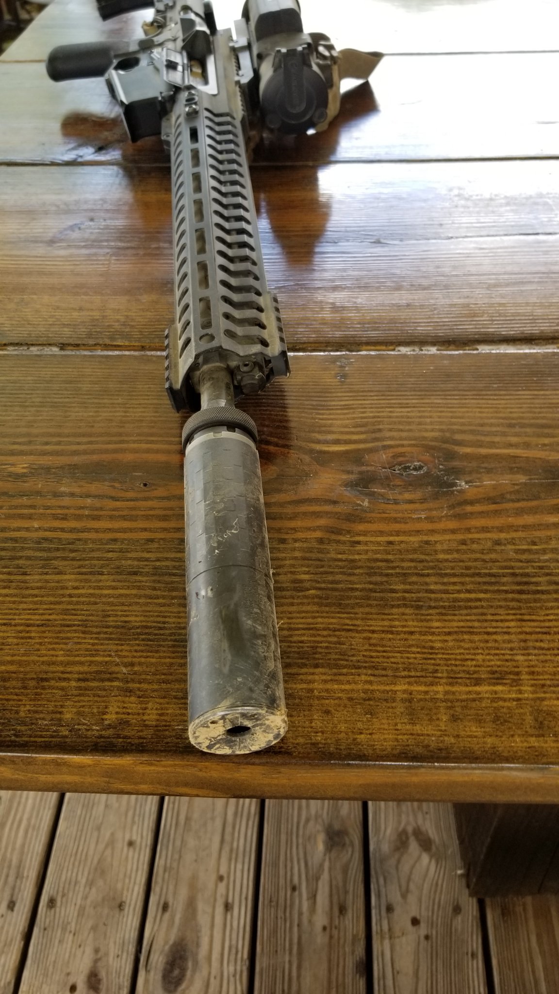

Get a 6.8 SPC or 6.5 Grendel in a ~12.5” configuration, throw a suppressor on it, and a Reap 35mm. The weight is a non-issue and you get all the knock down power you need. I have also killed a truck load of pigs with a 5.56 10.5” with 55g projos.
You’ll be able to PID much further than you would ideally be shooting. The problem with your 300-400 yard range requirement is, everyone thinks they want to long range thermal hunt because they long range day hunt, but it’s more challenging at night in total darkness. Without a LRF, you’re pissing in the wind. Once you get away from the idea of LR night hunting with thermal, you will realize you can easily creep in on hogs and be significantly more affective at stacking them high.
Do yourself a favor and get a tripod if you haven’t already.

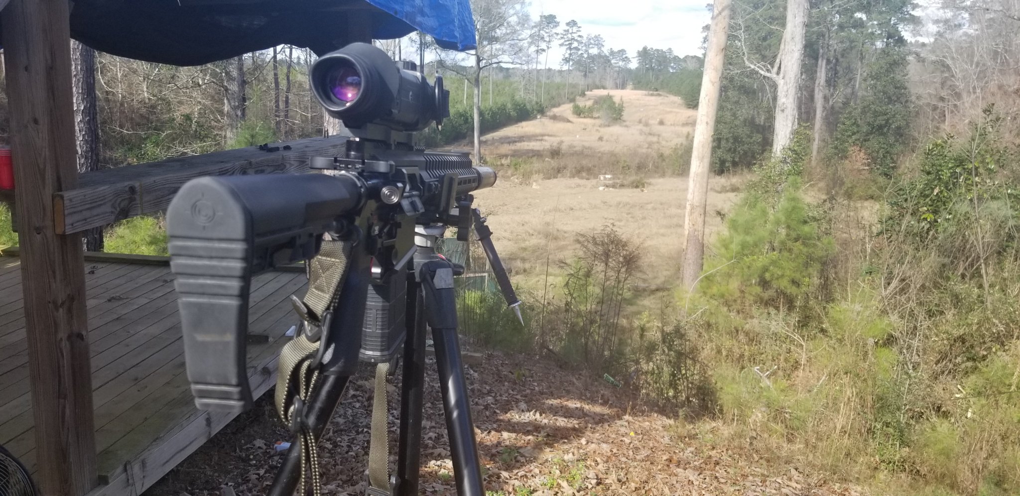

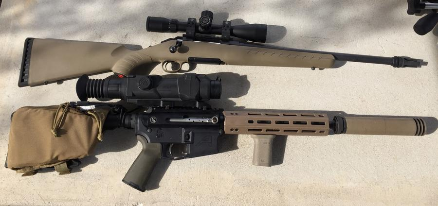

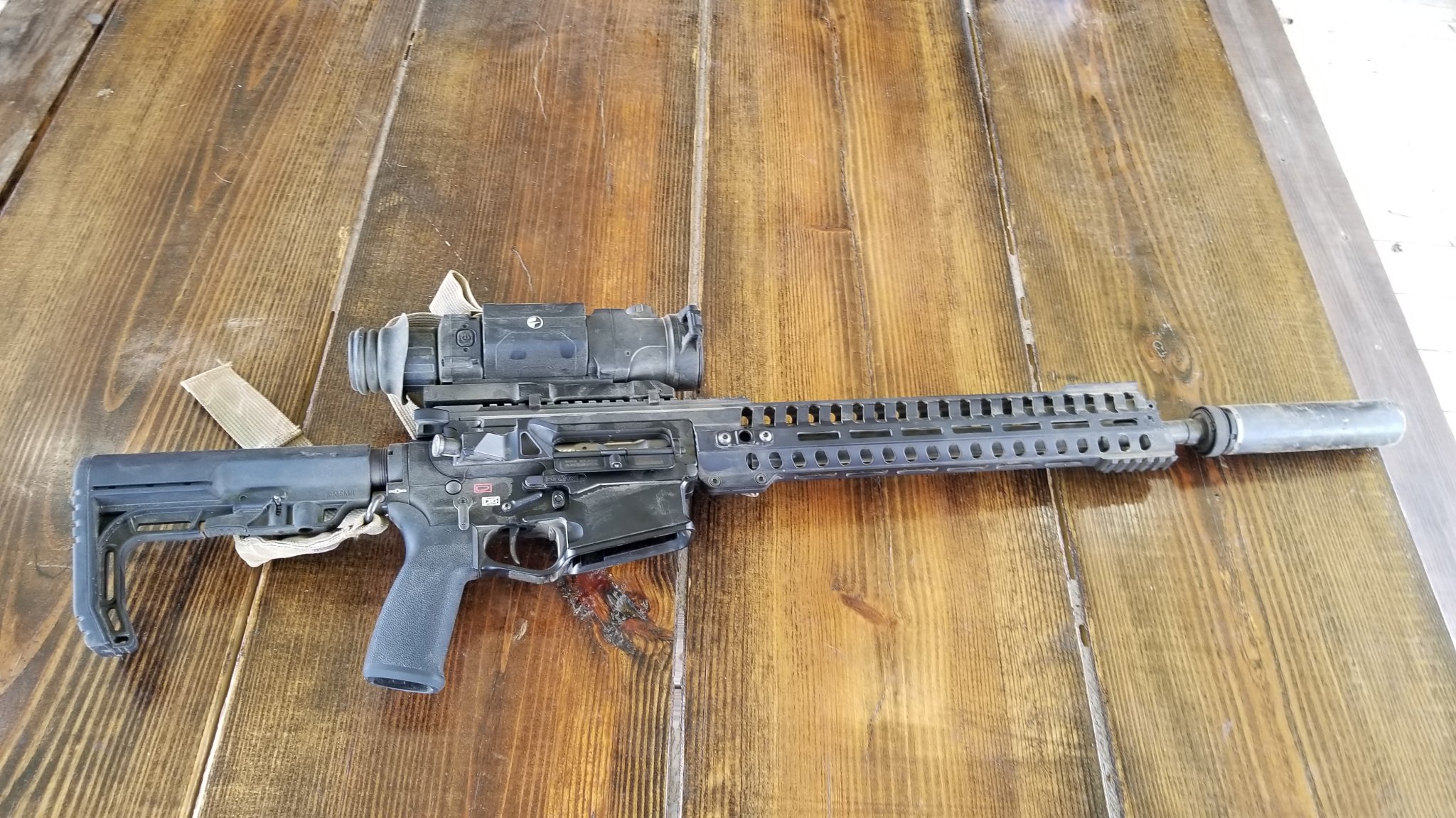

AR15Performance (ARP) 12.5” 6.8spc sbr suppressed (of course), Geissele SSA, JP SCS, Hdy 120SST. Mostly shoot at 50-150 yds but has gotten job done at 300yds/hogs and 350yds/coyotes. A compact Ti can such as 6” Crux Nemisis30 keeps it light and nimble enough for maneuvering in/out the truck or UTV - not Hollywood quiet but close enough to hearing safe, least for me, & I can easily hear my hits.
Currently running a 4 yr old Zeus 640/30/3x 75mm which has served me well, and for my son a 1 yr old Pulsar XQ50 which is fine, but next purchase will be a Trijicon MK3 or Reap/IR. Leaning towards the Reap but not sure about that joystick control vs. the MK3 knobs, esp since I’m lefty. Pulsar seems to be best value for now with lots of neat features, but I really like the build quality and performance of theTrijicon, even with its additional cost.
I’ve used and/or hunted with folks using 5.56, 300bo, 6.5g, 6.5cm, .308. While all excel in certain areas, the 6.8 is efficient in shorter barrels & provides me with best balance of stopping power, range & hunting ammo selection (factory - not currently reloading) for nighttime spot/stalk hunts in the AR15 platform. The .308 & 6.5cm are absolute hammers, probably best option for stand hunts but I’d hate to lug one 500 yds across a muddy bottom field to shoot a couple hogs like I did last night.
Just my opinions - like grandad said everybody got one!
Edit: agree 100% with amcardon in regards to tripod/grip (I use a Reaper grip). Used a Trigger Stick for years as I didn’t want the weight of a full tripod grip but once I got one it was, like thermal, a game changer for me.

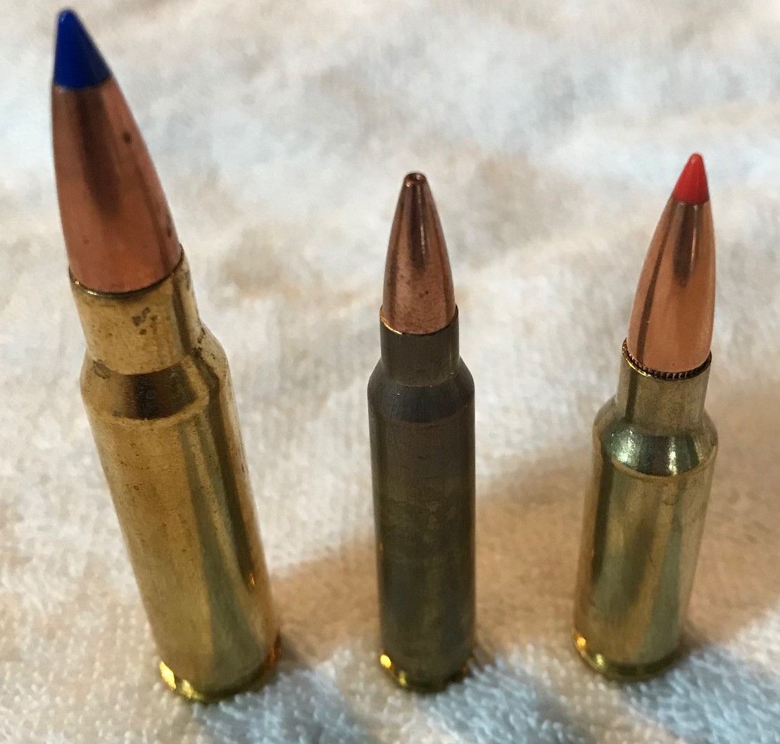

I use to have a 16" bolt that I ran the thermal on initially. I started by thinking I would be sly and hunting subsonic "so I could shoot multiple pigs before they knew what was up." The first shot they scamper regardless so the one benefit I was hoping for doesnt pan out in the real world. With 220 pro hunters on 12.1 of cfeblk it gave 1050 fps, shot well on paper but was sort of tough to use at night through thermal with that much arc to its trajectory. Had too many high or low hits on the animals and even some that I know were good thanks to the dvr that still resulted in the pig strolling away.
Here is one showing how the pigs will walk straight up to you in the dark, took a sub to the head point blank and took off. Luckily it circled around and was the final pig you see go down.
http://instagr.am/p/BXLGlMyFlBs/
With 150 gamekings it was pretty great. It was in FC brass on 19.4gr cfeblk and got them moving at 1800 fps. It has much more autority and actually anchors pigs. This shows, again,how close they will walk up to you at night so long as you dont make any noise.
(for some reason its only linking and not embedding the second instalink)
http://instagr.am/p/BdbYNwZF9-2/
I now have an AR with a 10.5" barrel. Im shooting a 125 pro hunter now over 19.5 gr of cfeblk which is putting them out around 1750 I think, I havent fully vetted it just yet as I got a quick load for hunting and then just havent gotten back to it to fully fill in its velocity etc in the calculator to see its longer range effectiveness, I probably never will, for what I use it for at or under 50 yards Ill never need to know. Ive only got 1 pig with it thus far but it seems to be working alright.

agree. like to see how the POF revolution is doing on the piston gun and see how Di will do . I stopped using my Scar 17 while hog hunting since having 2 rotator cup surgeries and carry the 300 blackout now. been looking at getting Fix\Christensen mpr or POF in bigger caliber though
I have the piston Revolution. POF nailed it with this design! I shoot the Federal 168 SMKs.704006970400707040071704007270400737040074
