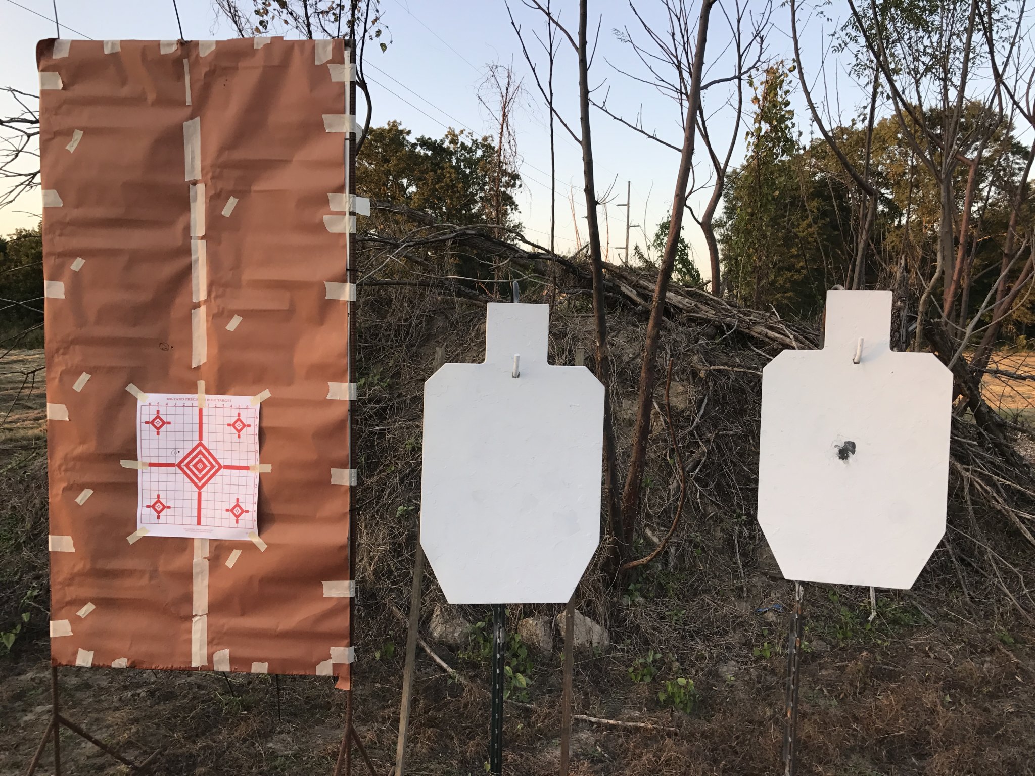

Found some pics. This was the setup. I was wrong about an initial group to confirm dope before the “cooling mirage” began. It was just a single shot, on the right IPSC. Elevation was 8.0 mil, and was not changed throughout the entire test. When the weird mirage first began to develop I switched to the paper target, aim point was the center bull. I forgot to take a pic to begin with, so this was taken after I had already fired two rounds on the paper (ie 20 minutes into the test).
Reactions: morganlamprecht

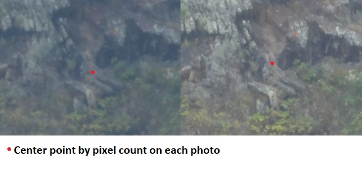

I've tracked roughly 2 MOA worth of image shift on my Nikon D5100 (~10x zoom lens) doing time lapse. In some circumstances with an absolutely fixed 32x rifle scope I've watched the target bounce up and down almost a full mil.
Seems to be related to sunshine as far as I can tell. The entire image grows/shrinks with varying light, but also tracks up & down at the same time. I did one across a valley, about 200 ft above the deck across most of the valley (cliff wall looking at a steep hill) to see if it was mirage off the ground, same results.
Here's the two most extreme examples from the time lapse. Roughly 450 yards.
7096953
Have to remember the "invisible lens" that the atmosphere provides between you and what you see. Variable densities cause variable indexes of refraction and light takes the shortest path between two points-- not necessarily a straight line.
Nothing new.. Old timers used to say, "Lights up sights up, lights down sights down", and astronomers never look below ~45 degrees because of all the BS the atmosphere causes.
