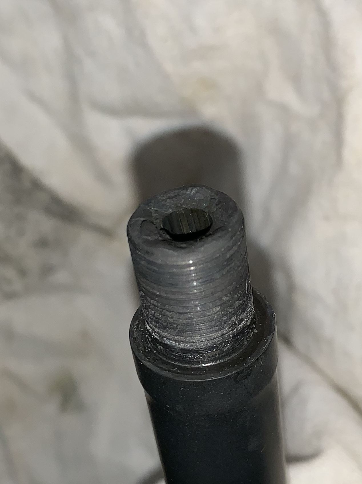

I never loctite a muzzle brake; hand tight is usually enough. I remove the brake and clean the crown every time I clean the rifle. Carbon build up in the brake can become an issue and cause bullet strike so I keep the brake free of carbon as well.
Damn, that's one ugly crown. On another note, I prefer a flat crown vs an 11 degree target or recessed crown. With a flat crown you can use the edge of a plastic card to remove much of the carbon. In a worst case scenario, carefully using a razor blade held at a very, very shallow angle can cut the most difficult baked on carbon.
