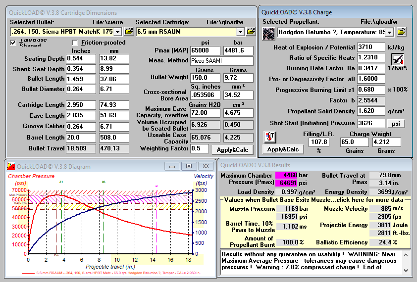

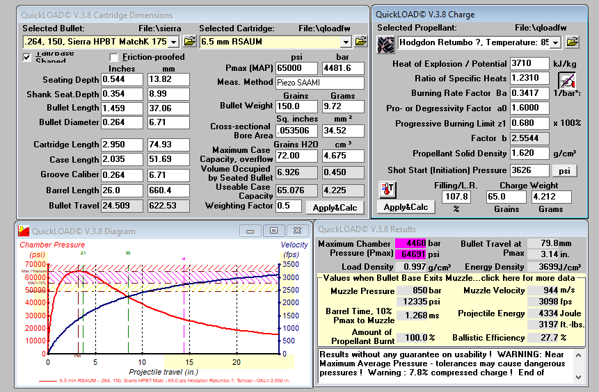

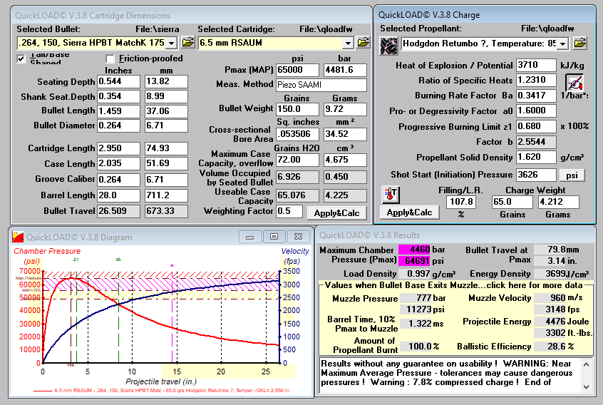

With respect, you are proven wrong daily here. Here is 3 samples, 20" barrel, 26 &28". There is a 100% powder burn in the 20" barrel. The majority of the time, 2" more barrel equal more speed with no trade offs other than what extra barrel lengths do for maneuverability.
One popular case where people don't stray much from powder mainstays is the Dasher, so proof that faster powders can accomplish more speed with little side affects.
