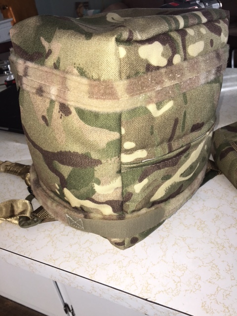

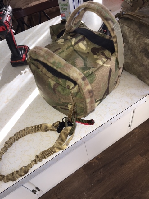

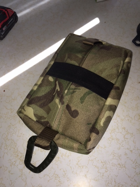

Here is our best attempt to recreate something similar to the pump pillow and the str8 laced bag with a few differences. The main difference being the adjustable velcro straps that go around the bag. The fill is a micro poly fill purchased from amazon that seems to be just a little more fine than what Wiebad is using. 1000 cordura and other materials purchased off eBay at a reasonable price. A local seamstress hooked us up on the sewing! Very happy with how these bags turned out. Any questions feel free to ask. Check us out on instagram at kingpin_precision_shooting for other shooting content and DIY projects. image_49431.jpg

Those came out great. I'm thinking about trying to make the same thing. I'm going to have to find somebody who can sew, as I dont think wrapping it in duct tape is going to work.

Think I may try making some custom bags as well thanks for the post

It has been a while since your post, but did you make the bungee too?
Doubt it.
I make a lot of my own "DIY Budget" stuff too with some basic materials(cordura, hook/loop, webbing, etc) and hardware.
But when it comes to some of the lanyards, for my purposes/uses it is hard to beat some of the dirt cheap options on Amazon/Ebay.

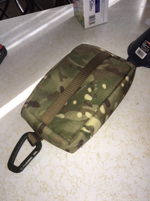

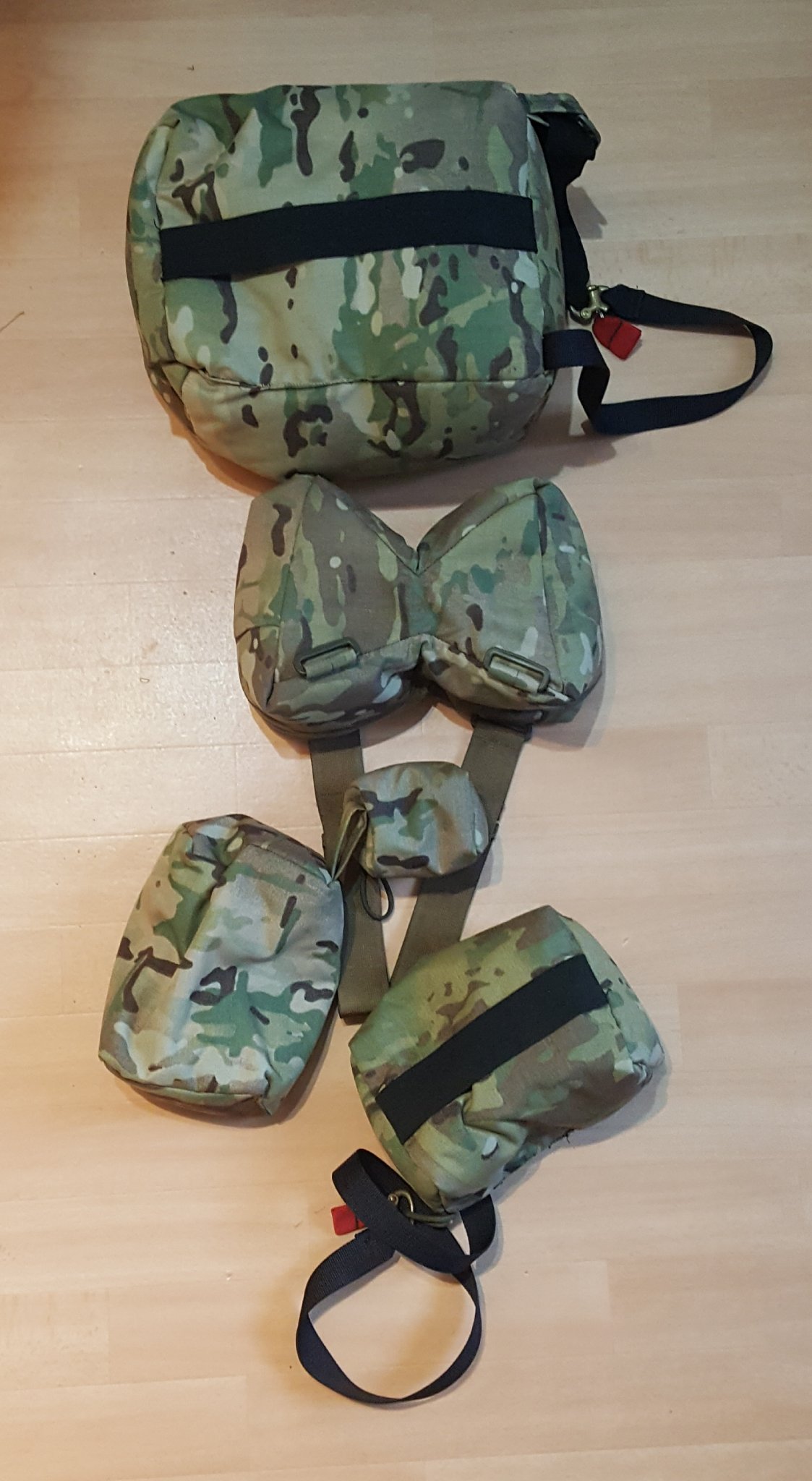

I have made some shooting bags, too. Base material is multicam cordura 1000 and I experimented a bit with a bunch of accessory cords.
The big one and one of the medium ones are filled with super light styrofoam balls of about 0,05".
The others are filled with PE granules of about 0,15". The weight difference is nearly 1:10 for the same size of bag.
I made 2 medium bags of the same size to compare weight and handling.
Personally I prefer the heavy fill for front support a lot and even as rear bag.
Only with very big bags the light filling is better. For hunting, I prefer the light ones for obvious reasons.
The "gamechanger" is much much more stable with heavy fill.

Damn I'd like to have one of those big bags. That looks awesome!

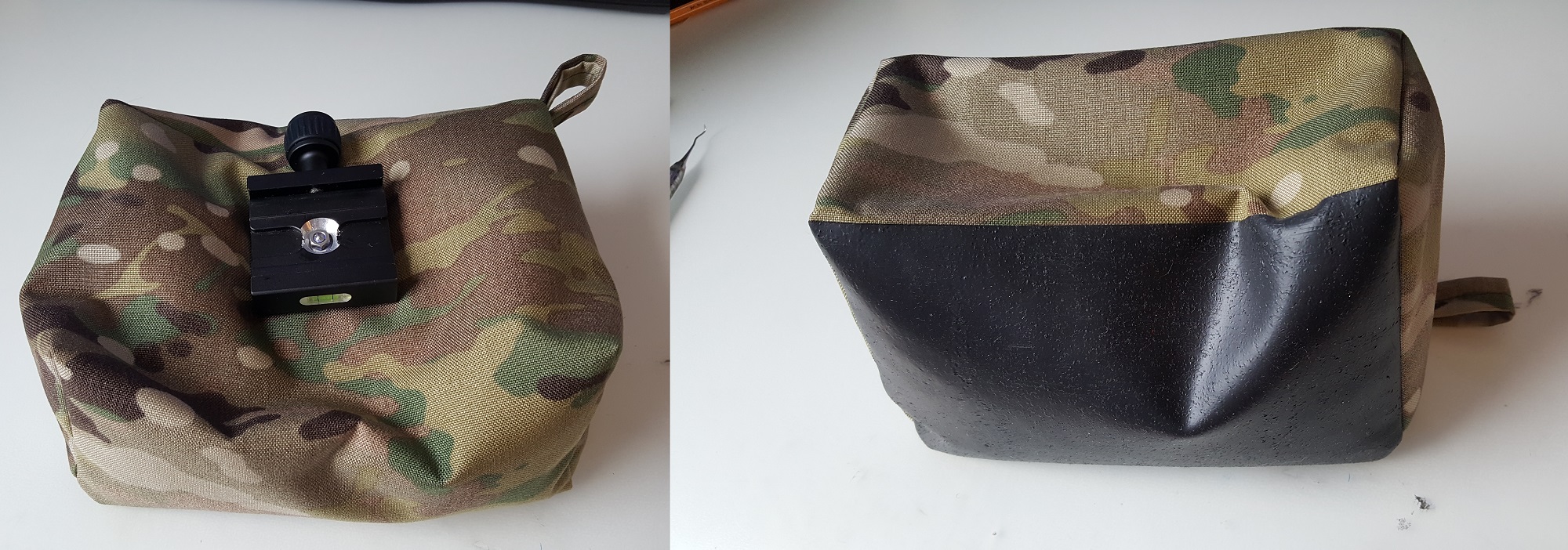

Hi Guys,
did a little experiment today and will try it in the match this weekend.
Medium sized front bag with non slip (silicone) on one side and an arca rail adapter on the other.
Lets see how good it works. It is medium heavy fill but I could imagine that a super light fill could be good for a bag that is attached to the rifle.
Has anyopne of you experience with arcarail bags?

Hi GuNinja,
I was not using the bag very much as the gamechanger is still a more versatile bag. A fixed bag is not so well for threading through holes.
During training, though I found the bag too wobbly. So either one needs to have a longer arca attachment with 2 rivets or the bag needs substentially more filling material. Maybe I will experiment with both...
PS: The arca rail for the bipod is awsome enough to get one;-) I am running it on my 6.5 and 22lr trainer and with different bipods.

Where did you find the camo velcro? Or did you Rite dye it yourself? I find the hardest part of making your own bags is finding the preferred material colors.
