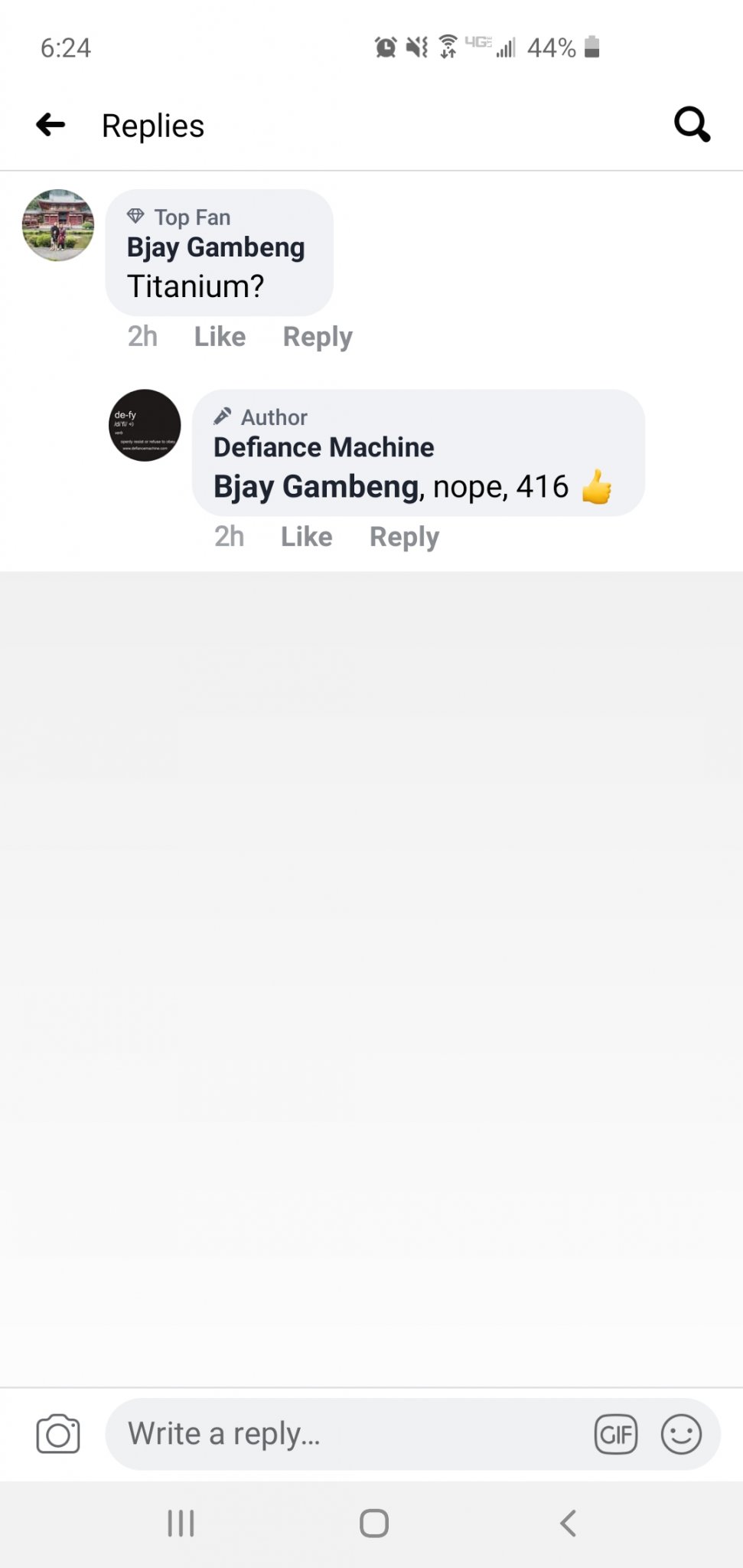

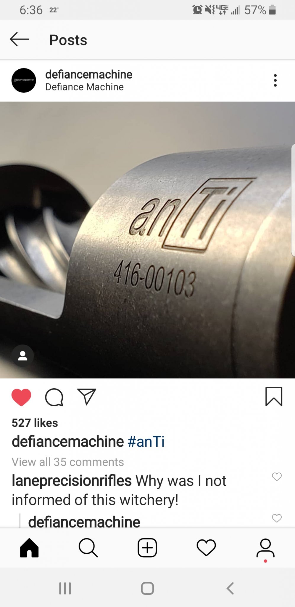

Titanium defiance action sounds cool for a sheep rifle. How does titanium behave in cold weather, like -40F?
Gunna need you to substantiate that claim, chief.
Defiance said it wasn't titanium. 416, which is part of the serial number on Facebook

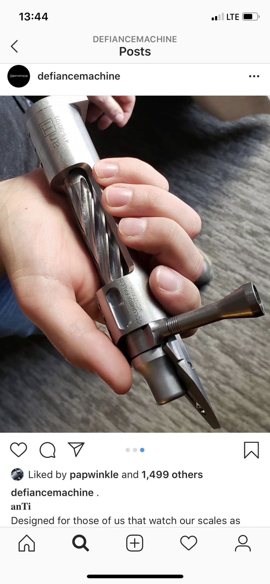

I wonder what the backend looks like. The ejection port looks massive almost like the left side is the same as the right. Might have just taken a lot of unnecessary material out to hit the target weight they had.
That is the defiance sheep port,They have been cutting actions like that for years,can’t wait to find out what they have done though!

Maybe they’re being clever with the answers. May be some sort of hybrid design. Metal inserts, an internal sleeve, etc. Interesting either way.
Edit: that bolt has some ridiculously deep flutes.

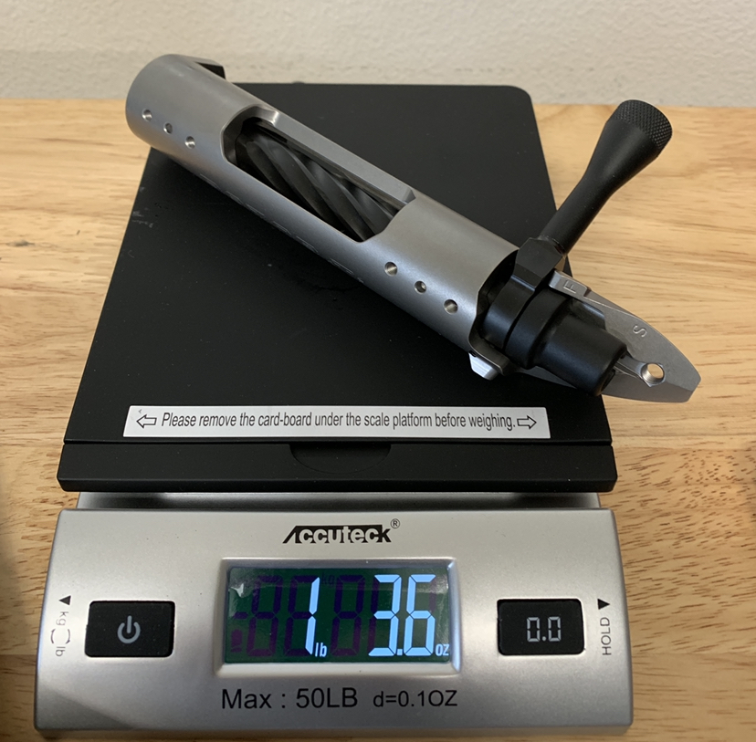

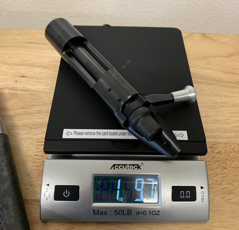

Here’s a Ti Lone Peak Razor short and a short Remington with a modded bolt knob for comparison. Note the Lone peak has an integral lug like the anTi, and the Remington has no lug in this pic, so it’s a little heavier than shown.

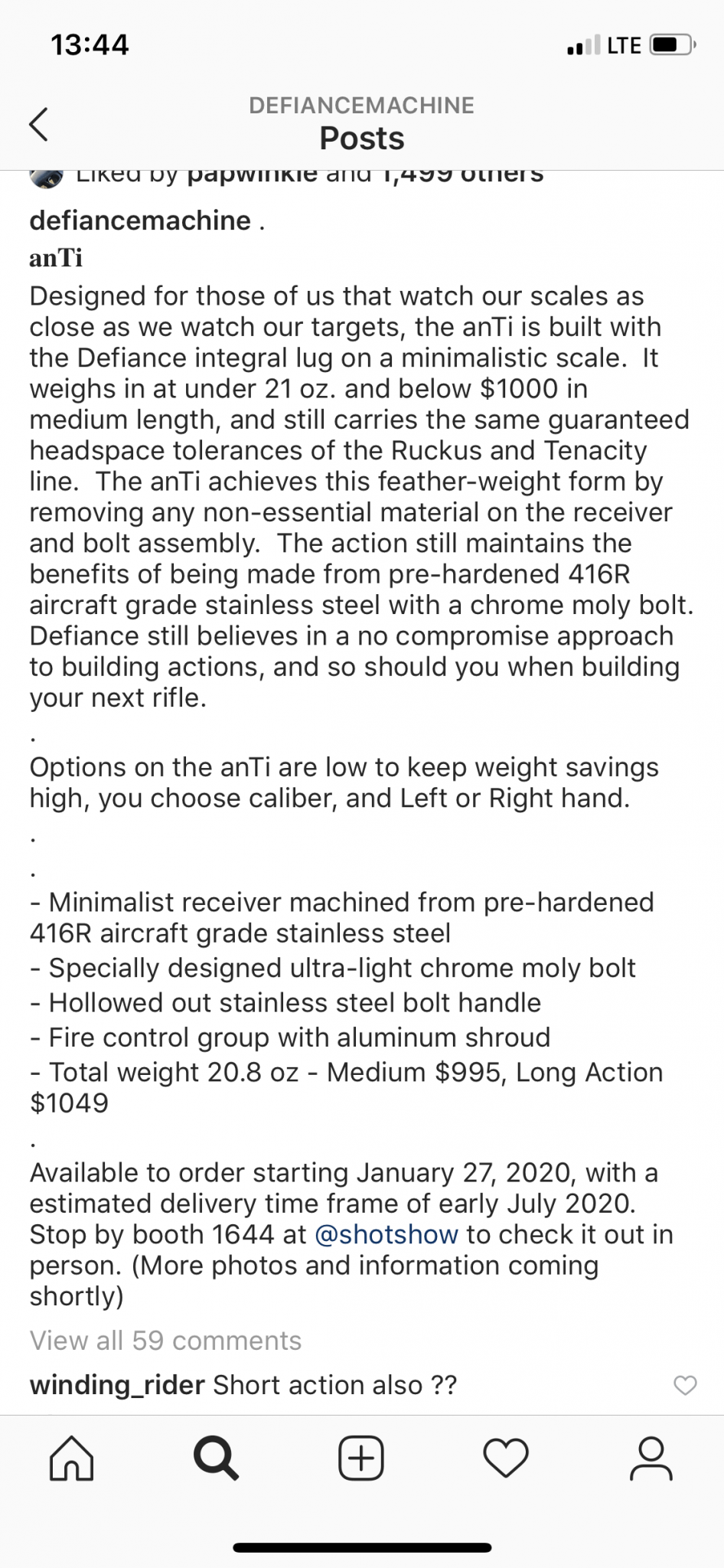

First post here. I've been planning a build for a weight conscious hunting rig. I was set on the Bighorn TL3, but this new action has me curious. Defiance using Pre-hardened 416 stainless in the AnTi is the same material that Bighorn uses in the TL3, it looks like there is a 7 oz difference between the two (21oz AnTi vs 28 oz TL3). Are these actions fairly comparable? Any insight on one vs. the other from what is known so far?
I obviously don’t have the aNTi but I have a deviant ultralight and a tl3, both are amazing actions for a hunting rifle. Both very smooth and feed great no complaints from me on either. I think the anTi will be the start of a short, lw hunter in the near future for me. I don’t think you could go wrong with either but for the sake of keeping weight down the anTi has the edge
