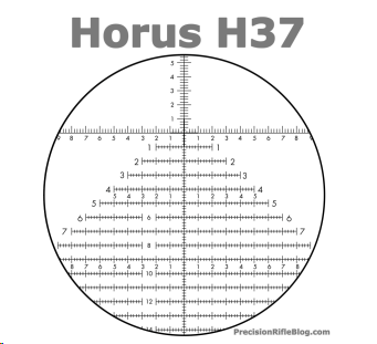

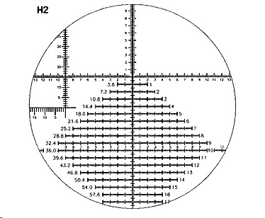

In other words, in order to do what you want, you'll need a much higher MOA base and rings, but you'll lose all elevation decreases below 200. You'll also put your zero in an area of deficient optical clarity. There is a scope out there that does what you want. I ran across a scop that has crosshairs in the top third of the tube. Similar to this.
7039486
Or this one.
7039487
But these depend on hold overs, not actually dialing your elevation.
