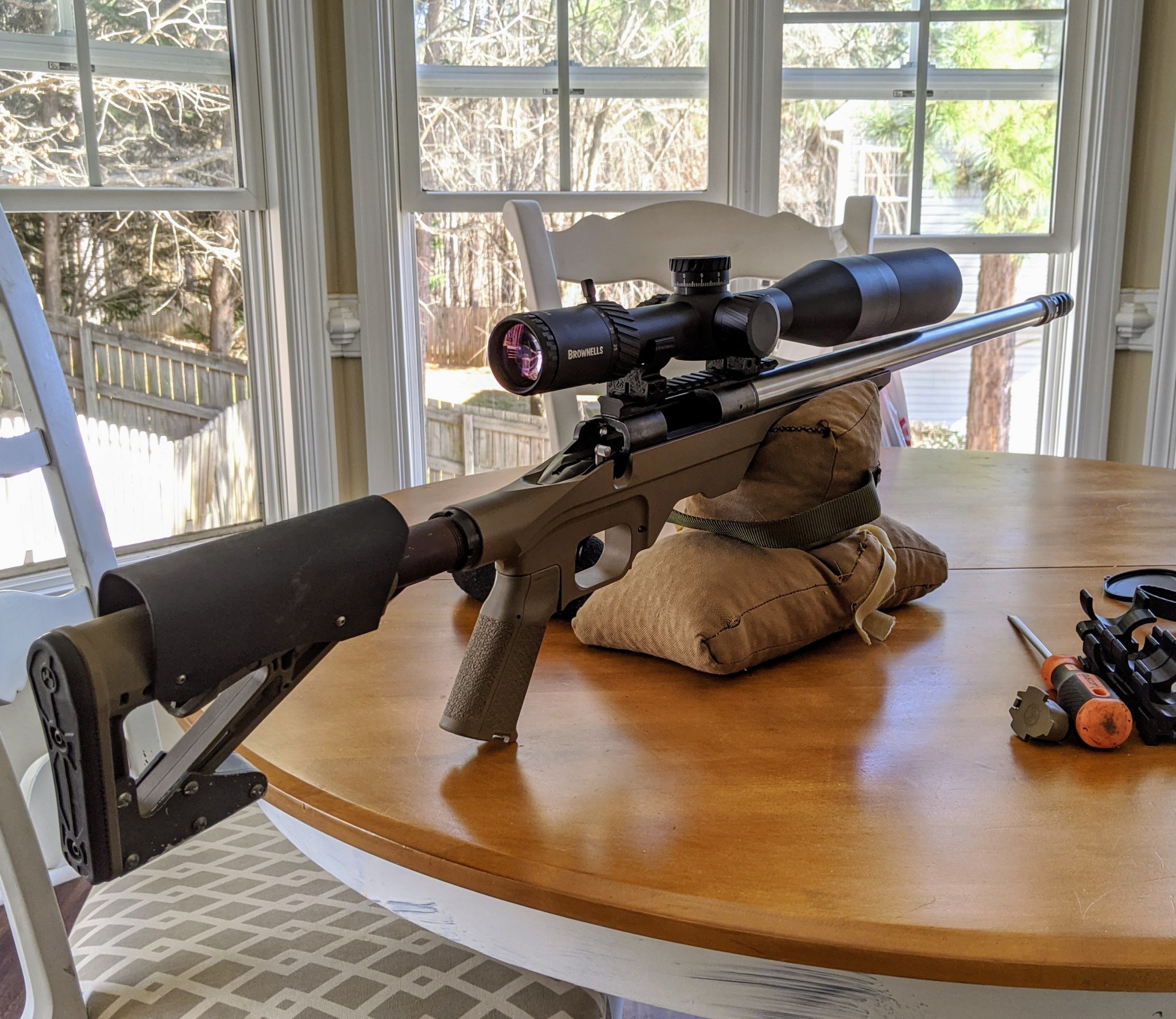

The more I play with the MPO the more I like it honestly. The eye relief is so long compared to the SWFA that it is distracting to me. Oddly I'm really not noticing the distortion nearly as much now? Maybe I was just being hyper sensitive to it before? I might need to edit my last post...
After adding some height to my cheek piece the eye box has gotten a little easier to work with. When you move your head out of position with the SWFA it's almost as if the image sort of fades in to view where the MPO has more of an all or nothing, light switch effect.
Take it all with a grain of salt
23" barrel and this monster covers over half. Lol
Oh, I'm only getting 19.2mils of total travel (and yes that is TOTAL travel, not limited by the zero stop). Right now that's my biggest issue.....

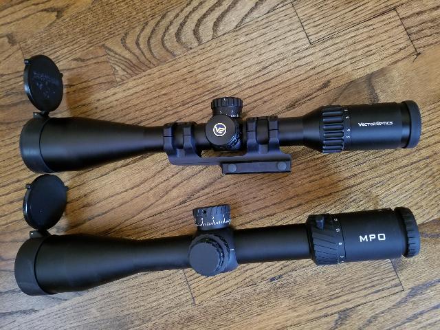

The MPO is on the bottom. The one on top is the scope now on my 338LM. Its 6-30x56, BUT SFP versus the MPO FFP.
I really liked the MPO, and LOVE Brownells return policy, but the scope on top cost me $380 bucks on Black Friday, and the glass is actually clearer, and brighter than the MPO. The turrets on the MPO are much nicer though. You do get what you pay for there, but I will be using Strelock pro instead of turning knobs on the scope. I think my next scope will be the PA PLx 6-30x56 Apollo reticle for my 6.5. Dimitri's reticles are awesome!
Not sure why Brownells accounting dept is so screwed up, but I have been waiting for my refund since Jan 14th. Still nothing!

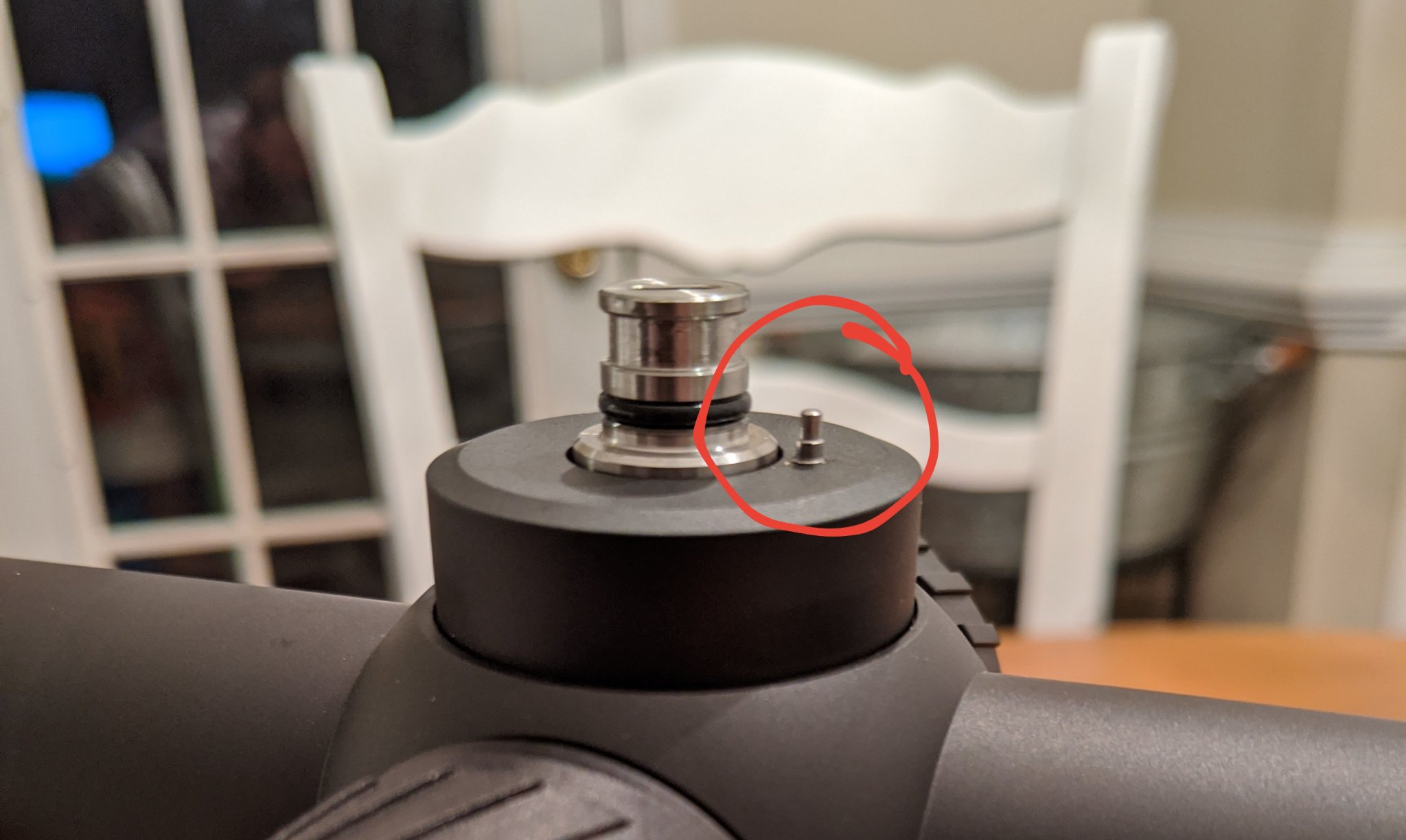

Ok, so I can't shut by brain off when it gets started on a problem. I have determined that my MPO actually has 23.8mils of elevation, not 19.2. The problem seems to be in the post that acts as the hard stop for the zero stop. As the turret revolves it is essentially unscrewing and moving up. The first rotation flips the stop mechanism around and any subsequent complete rotations should clear the post (pictured below). This is how the 3-18 model can have 40mils of elevation, right? I believe the height of the post on my scope is slightly out of spec and does not allow the stop mechanism to clear at the end of the second revolution. The thickness of the mechanism is why it is shy of 20mils (2 FULL revolutions). If mine protrudes too much and is out of spec I want to send it back.
Could somebody with a pair of calipers please check the protrusion of their pin?
I asked this question through the Brownells Chat thing. What they said was, since these scopes don't have a revolution indicator, and are geared to newer shooters, the elevation is capped at 2 revolutions (roughly 19 MILs). This is a hard stop built into the turrets. They will be coming out with an upgrade turret that allows full rotation to the internal MAX should you want that.
So in your case, scope is fine and don't start filing down nubbins.
