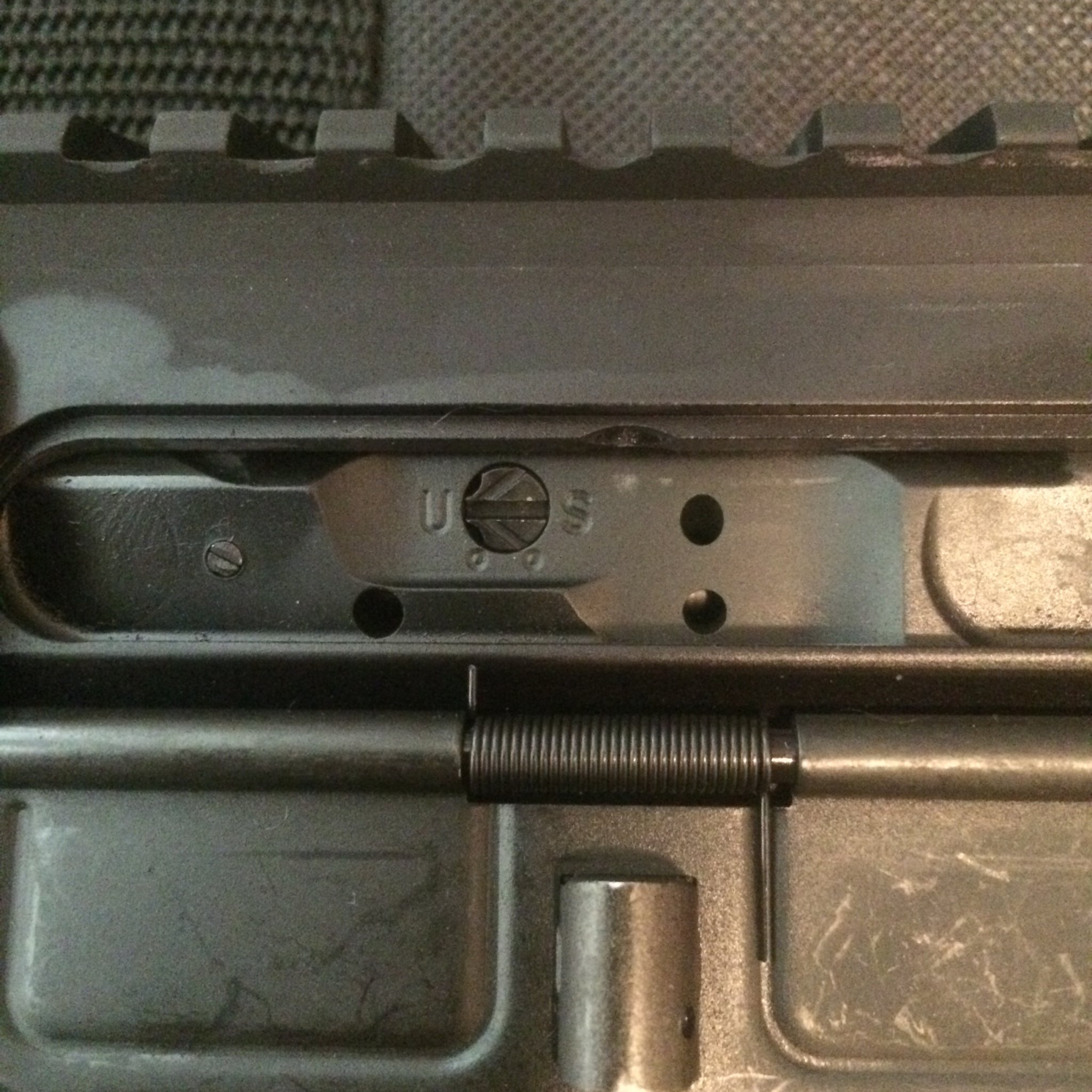

Has anyone run a bootleg carrier in a large UU kit, specifically 6.5g? The lack of an adjustable gas block concerns me so I was wondering if this would be a solution.

I had the bootleg in a 223 and with the settings and shooting not suppressed it cycles or not. Meaning with it on the setting for less gas it never locked back the bolt. So, I think they are pointless unless shooting with a sup. Grendel may be different though.

The Bootleg carrier has 4 settings, not just suppressed and unsuppressed. Sure you didn't use a Gemtech or something else?

Then your rifle was properly gassed and didn't need any further gas reduction. Did you not understand what that adjustment was for, or how to determine if your rifle is gassed correctly?
The whole point of the Bootleg carrier (and others like Gemtech too) is to adjust gas for suppressed use. If you're not using it with a suppressor, and your rifle is already tuned right, there's no reason to use an adjustable carrier.

No, it doesn't go inside the gun. The Bootleg carrier vents gas out the ejection port; it's a bleed off system rather than a restriction. The whole point is to dump excess gas when you switch to suppressed shooting; it does that well. It's not intended to be a replacement for an adjustable gas block.
If you just need a method of tuning your rifle unsuppressed, an adjustable gas block is a much better choice. Only add a Bootleg carrier after that if you plan to shoot with a suppressor some of the time.

The issue is if a adjustable gas block is not practical for whatever reason.. and they all have their own drawbacks and limitations, would the bootleg provide some relief in an over gassed gun?
Yes, it can help a little bit. You just won't get the range of adjustment that you can with an adjustable gas block.
I sometimes use the Bootleg carrier in my SBR Grendel this way, unsuppressed - the gun is tuned for my normal loads (using 8208XBR powder), and with one other load (129 ABLR and Leverevolution powder) it's pretty overgassed so I turn the carrier adjustment to position 2 when shooting that load. I pretty much only use that load for hunting, so it's not worth changing the gas block tuning, and it's easy to visually check if the carrier is adjusted for that load.
Alternatively, you could consider an adjustable gas key, which you'd install on the bolt carrier you already have. I'm not a big fan of adjustable gas keys, but if you don't have the equipment to change a gas block, it is a functional option.
Of course going to a heavier buffer is an option as well.
