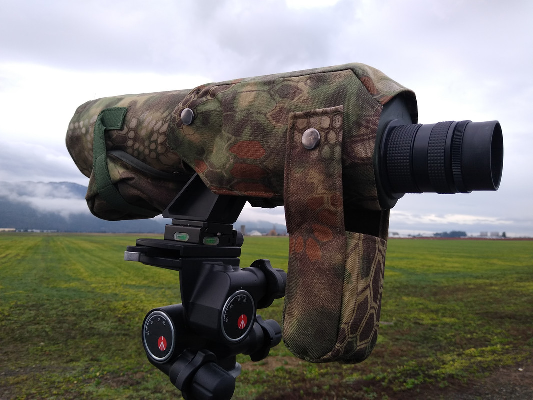

I like the geared heads for spotting scope use. I use the 410jr. It's a bit heavy, all aluminum construction with bronze gears.
I've been trying to talk myself into buying the Manfrotto Xpro
The Xpro is lighter weight, but plastic:
The geared heads are useful for fine-tuning the position of a spotter reticle over an object for ranging.

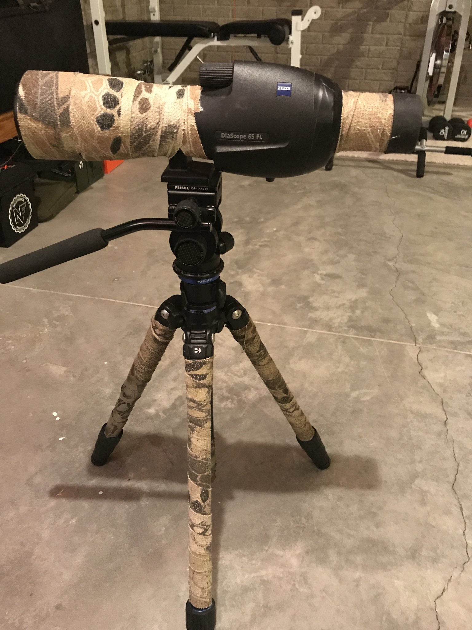

Got my Zeiss Diascope 65 FL on a Feisol VH-40 on top of a Benro tripod. For range and hunting use, it’s been great!image.jpgimage.jpg
