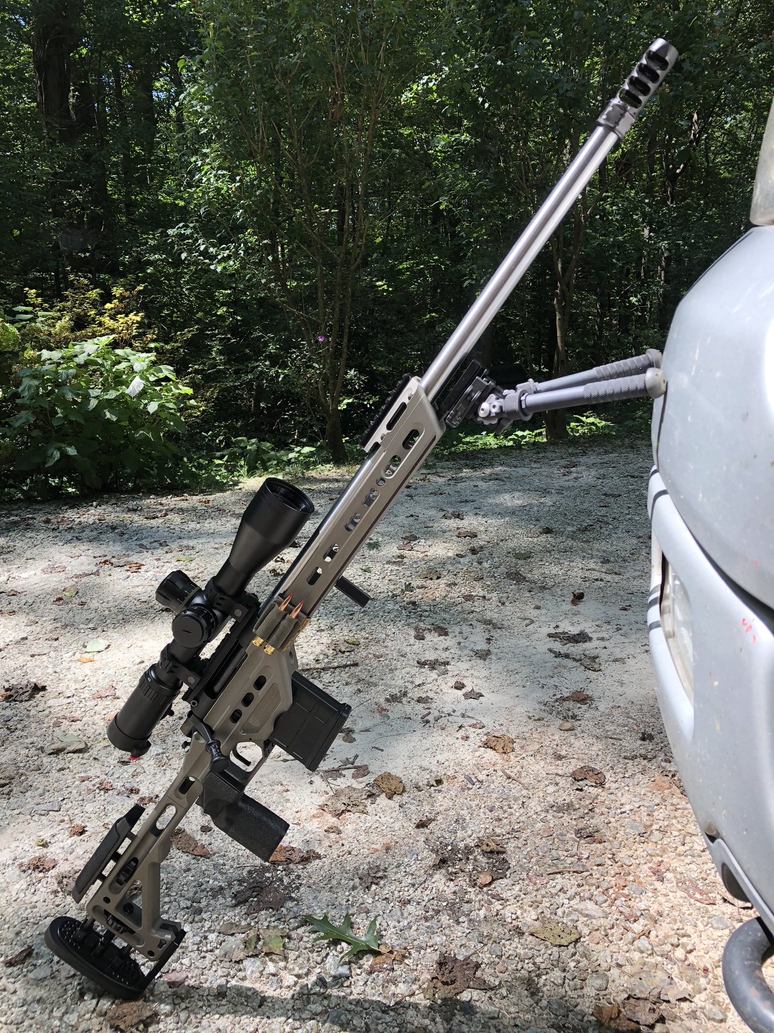

I just got my VG6 Lambda in today. Fit, feel, and finish is pretty damn good. Pretty damn sizable. IMG_3094.jpegAs soon as my barrel nut arrives I'll head out and get a feel for it. Buddy put on his 308 and the reduction was pretty damn rad. Anxious to see what it does on a 6.5
308pirate
Gunny Sergeant
Belligerents
Apr 25, 2017
5,973
4,085
119
I just got my VG6 Lambda in today. Fit, feel, and finish is pretty damn good. Pretty damn sizable. View attachment 6936264As soon as my barrel nut arrives I'll head out and get a feel for it. Buddy put on his 308 and the reduction was pretty damn rad. Anxious to see what it does on a 6.5
Damn that's a BEAST! I have a Gamma 762 on my 308 Howa/KRG and it's really effective. That thing looks like it will blow the Gamma out of the water.
Where did you get it? Everywhere I look it's out of stock.
