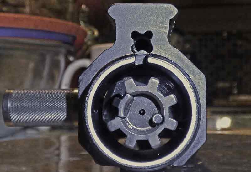

IMHO, it has worked very well for me and my AR's , Large Frame and Small Frame.
This thread show the before and after in a PSA PA65 ( 6.5CM ) , with quite a few factory loads
Please note, I also Loctite'd the barrel in place.
https://www.ar15.com/forums/industry/PSA-PA10-GenII-lower-w-PA-65-review-START-at-the-beginning-again-UPDATED-with-Tn-G-results-/301-285762/
Just the best improvements....
Some of the rounds that showed the most improvement are ... ( no specific order.. ) Again group size does not have .264 subtracted from them.
Difference in group size, FGMM 130gr Hybrid OTM..... Before 2.3660" 5rds, .... After .9580".
Difference in group size, .Hornady 140gr ELD Match.... Before 2.2045" 5rds, .... After .9290".
Difference in group size, PRIME 130gr HPBT Match.... Before 1.9165" 5rds, .... After .9620"...
Difference in group size, Federal Fusion 140gr..... Before 2.1445"... After... 1.4355"
Difference in group size, Hornady American Gunner 140gr BTHP.... Before ...1.1950" .... After.... .7520"
Difference in group size...Creedmoor Sports 140gr Nosler BTHP... Before 1.5135"... After... .8770"
I am not a big fan of the Wheeler Tool though... it needed to be wrapped with tape for a "truer" fit into my various uppers.
I use the Pacific Tool & Gauge version... much, much better fit. As in , you better lube that shank.
Since that test, I have done it to all my uppers.
All of those barrels TnG'd ( trued and Glued ) in place , have produced excellent results.
After the purchase of the lapping tool, ( $30 ) it is just a matter of minutes to lap the upper receiver face truer.
I will continue to do it to every AR I own

For my 6.5c big AR, a member here loaned me a large frame lapping setup. I could see light on one side as well. It took 5 minutes to fix and to me the advantages outweigh any inconvenience.
Also, instead of loctite I used 1” wide .001 stainless shim stock to tighten my barrel. Heated with a heatgun and installed the barrel, rapped it with a mallet to seat and once it cooled it was tight as you could ask for.
Shim stock is available on eBay cheap.

Ultimately, I believe Lapping the upper receiver face has helped minimize the dreaded flyers. And results in much more consistent groups.
My FN barrel .308 , after TnG'ing Shoots damned fine groups with about everything... who says a CHF CL Mil'Sped barrel won't be precise.... the photo is 10rds, 100yds, benched scoped bagged front and rear.. rapid fire. ( Horn. 155gr AG )
Every time I think about it... I think about the barrel extension ( when heating up ) not being able to "shift" in the upper ( no matter how little ) ... like that noise you hear when metal goes "tink" after get warm.
I realize that is an overly simplized comment... but...
