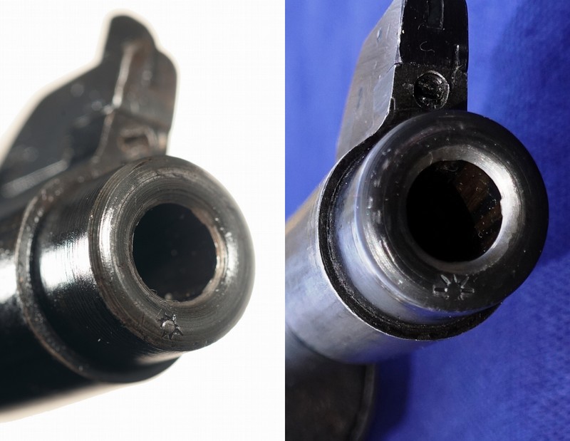

The SRS won't be able to tell you anything on this particular serial. I have all of their records and already looked.
Isn't that Blue Star Arsenal, or similar. A 1980's 90's reimporter?
Cheers,
Sirhr

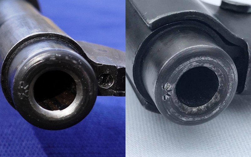

That is the star guaged muzzle stamp of the 1940 NM order. His rifle is consectuive to a NM that was shipped to the Marines in 1940. All the 1940 NM's I've seen have had a 3/39 or 6/39 barrel date. The stars on the 1940 shipment are different than the earlier ones. The reasoning it seems most likely in the documents, these NM rifles were put together at Frankford Arsenal instead of Springfield. I'm guessing Springfield was on Garand Production and had Frankford put together the last shipments of NM rifles in 1940.
Now the rifle above he posted pics of, the receiver does not have the NM polished rails. But maybe if his grandfather had it refinished. If refnished the only tale of a NM rifle would be that star stamp at the muzzle, and the star record number on the top of the barrel. That number would be a letter followed by a number. Like say a N 353 or M 2456. Something like that.
But if the rifle doesn't have a star stamp at the muzzle and the star record number on the top of the barrel, then it wouldn't be a refinished NM.

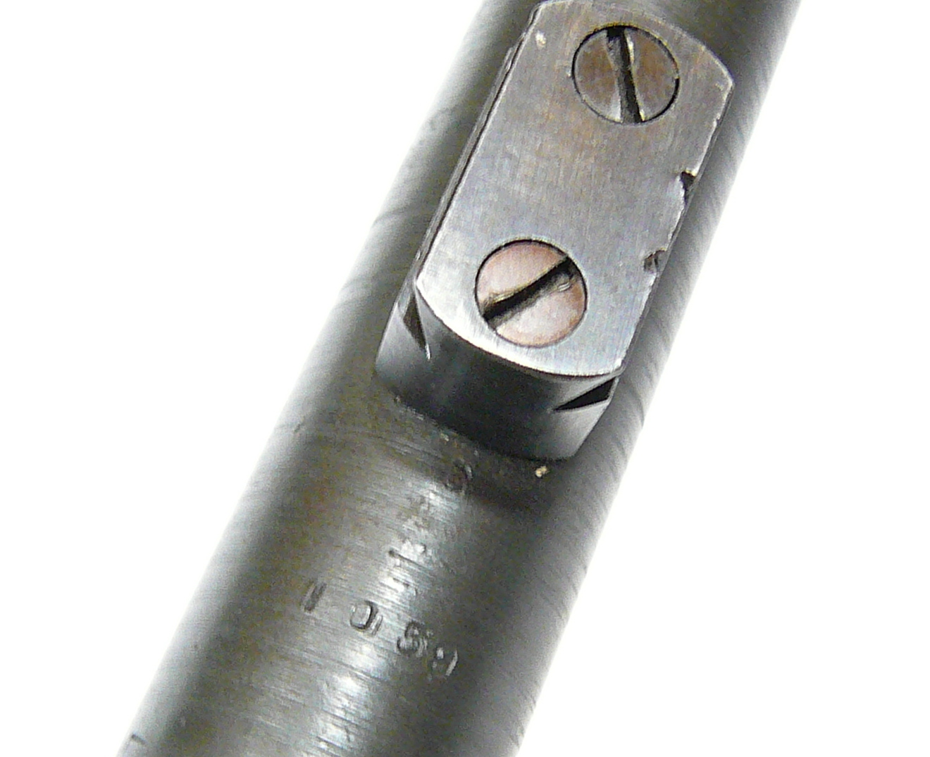

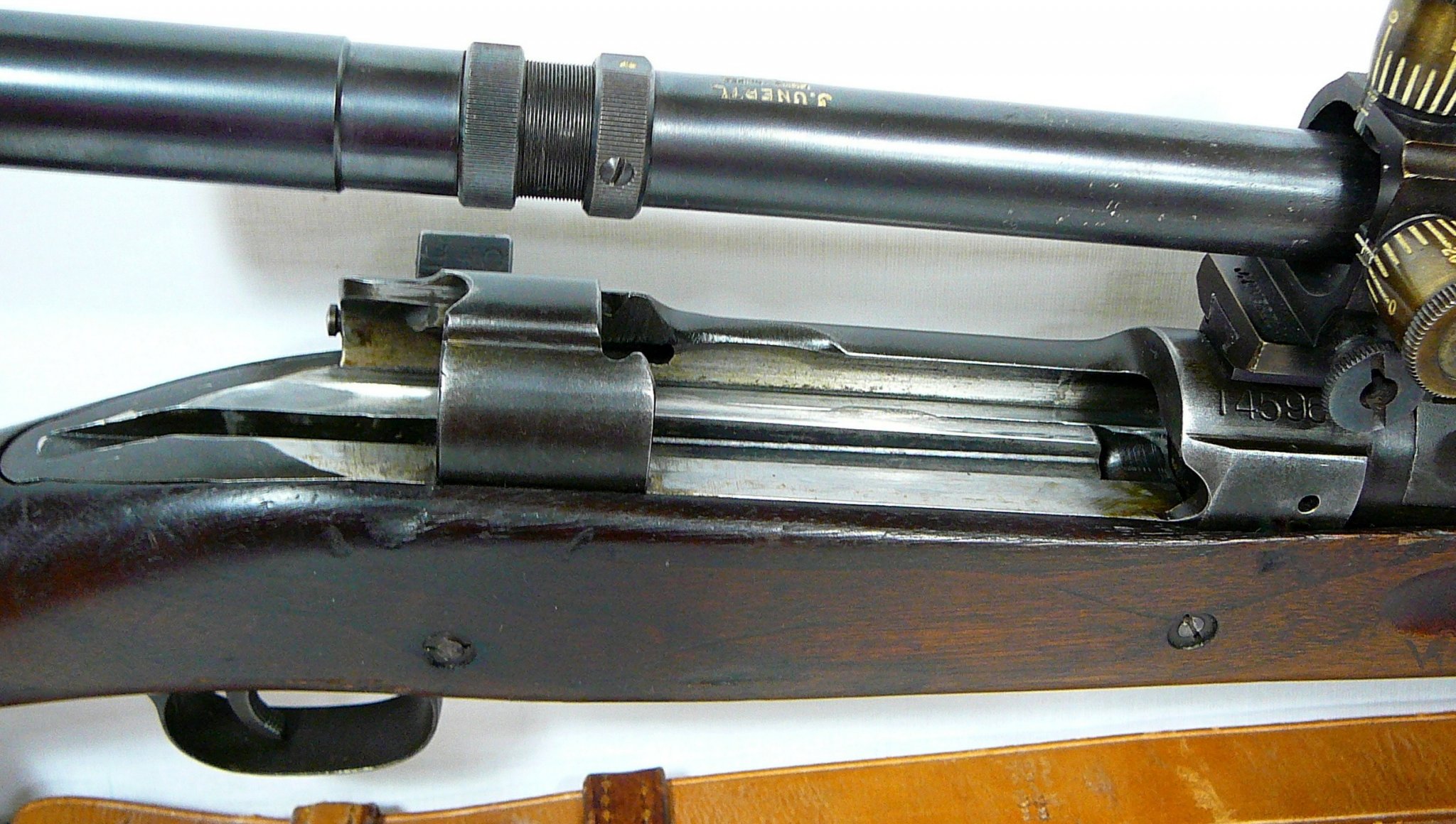

Yeah what to look for in a National match is first the polished rails and follower of a NM. LIke this.
Then if the barrel is the original star guaged barrel. Which all that meant was they used a tool to make sure the barrel was close to straight as possible. It had this mark at the muzzle. The left one is the earlier version you see the most often. The one of the right I've only seen on the 1940 shipment for some reason.
Then this is the star gauge record number under the handguard. This is a Letter followed up by a number. At one time you could have have got a card of how the barrel guaged at SA. This was the number that corresponded with that record. This isn't the best pic. There is a letter and number. I think it was a G and 1059

Yes, there is this mark on the end of the barrel on the 152xxxx rifle.
Star Gauge Mark meaning that the barrel was individually QC controlled.
It doesnt really mean there was any difference in manufacturing from a standard service issue barrel but it does mean that it was pulled from production, gauged to meet a tight spec than marked accordingly.
Likely quite a few service barrels could pass a star gauge but they were never "certified".

All markings I posted are on top of the barrel.
I have another barrel that is not on a rifle, and it's only mark is the 'P'. Not sure what it is....no identification anywhere else on it.

Thank you for the additional photos. That helps a lot.
Your rifle does indeed have a star guaged barrel and with that serial number I do believe your 1.52 rifle was a National Match and one put together for the 1940 NM season.
The rails on your rifle are not polished. But looking at your barrel several of the marking are very light. Especially the SA on the barrel. It appears likely that your rifle was at one time refinished and might have been buffed some. Another way to tell a refinish, several of those stampings should be in the white, and are not.
I think that is why your rails don't show the NM polishing. If you take a NM and refinish it. All you would see is the NM markings on the barrel. That would be the only clue, if the original stock was gone, and bolt swapped.
But your rifle is literally one digit off a known Marine 1940 NM rifle. So that is very good company.
On the P mark on the barrel, usually on the 1940 shipment, it is in the area of the barrel that is visible on the front band. Usually on the earlier ones it is under the handugard. I've seen some weird ones both ways though. But it just means it successfully fired a high PSI proof round and didn't fail.

Another site I was on is having a "hey show me yours and Ill show you mine" contest right now.
This was my contribution...
If you buy anything at Perry get yourself a reproduction or an original PJ Ohare sight micrometer.
You can not accurately and repeatedly use the ladder sight on an '03 without one. This is an SBS Sales repro. Originals can be found on Ebay.
The sight micrometer is considered a necessity by me, and everyone except my friends, family and people I meet in the flesh, always listen to me.
