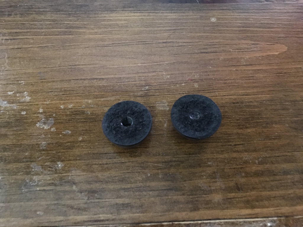

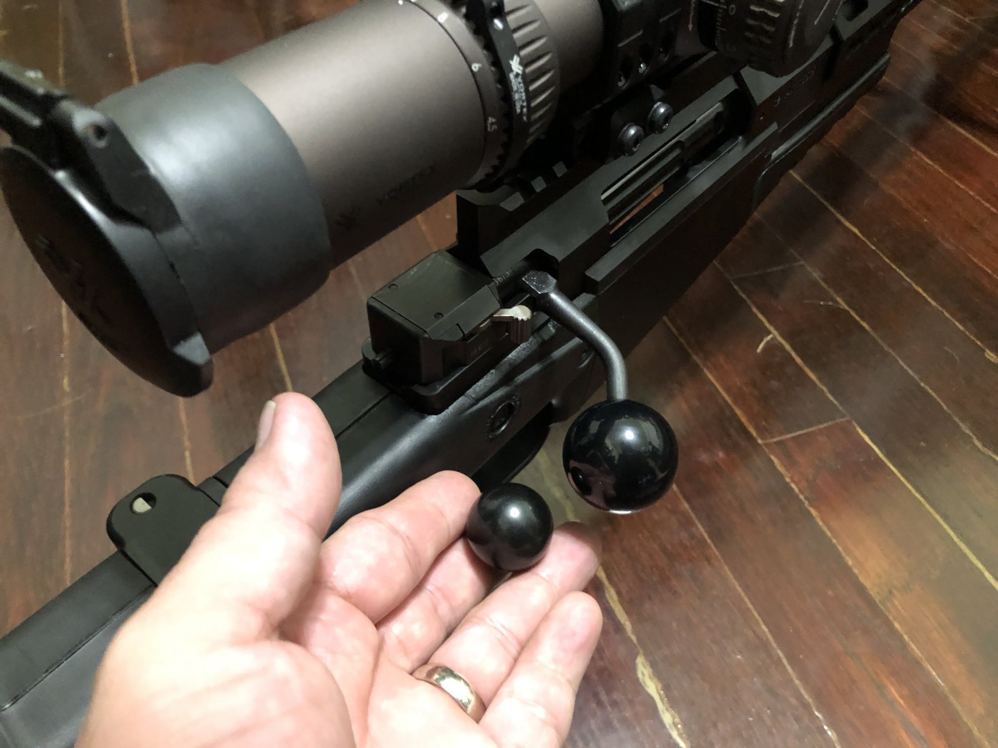

When cycling my bolt the ball knob on the bolt handle split perfectly in half where the threads stop in the ball. I have never dropped my rifle or bolt, never loaned it, can't imagine that I could have done anything to break it.
Has anyone had this happen?
What did you do?
Are there better knobs that will still allow the stock to fold?
If so, source?
Thank you
Steve

Sorta hoped maybe a kewl upgrade since it broke.....
I just superglued it. Will see if that works.
Would not mind still replacing it with something different if it isn't some thing specially made for me, thinking that would be costly.

I had this exact same thing happen to a new AXMC 308 bolt the first time I used it. Mile High didn't have the part even though they sold me the bolt. It was the last one they had and couldn't exchange.
Adam got me in contact with Lance at Accuracy International US and they got me a replacement overnighted the next day at no charge.
I'd recommend emailing AI: aina@accuracyinternational.us

Based on your pictures, yours broke in exactly the same place mine did. I was actually surprised that it's more of a billiard ball material rather than plastic or metal.
My guess is when they thread them sometimes they stress crack or when they're installed they get overtightened.
When I reinstalled the new one they recommended loctite. However, after doing some research and loctite's ability to weaken plastic I decided to just thread it on normally and snuggly. Worked perfectly and doesn't work it's way loose and is still going strong.
When mine broke though it cut the hell out of my hand so hopefully you didn't have to go through that.

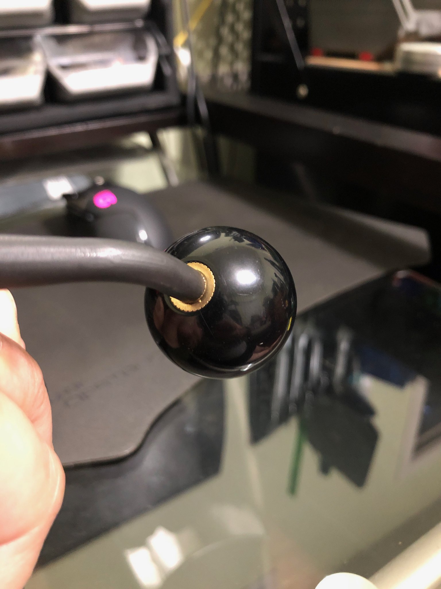

Mine broke in May after three years when I overtightened it. I emailed AINA the SN, and had a new one with a few stickers two days later.
The handle has a little point on it, and can create a pressure point if overtightened. The new one they sent has deeper threads so it doesn’t bottom out on the handle.

I also experienced this failure with a brand new AXMC last year. It seemed like the bolt handle was overtightened either by the factory or somewhere along the way before it made it to me. The knob cracked and was split down the middle like this after the first round was fired.
I contacted AI and they overnighted me a new one. I really hated the look and feel of the shiny plastic ball anyway, so I replaced it with a carbon fiber round knob from here: https://www.boltknobs.com/bolt-knobs-carbon-fiber/
As jwood mentioned, the AXMC thread was M6x1.0, so I bought one of these so I wouldn't have to attempt to drill new threads: https://www.boltknobs.com/m6-thread-adapter/
I hated that I had to do that on a $6000 rifle, but the CF looks and feels much better, IMO.
