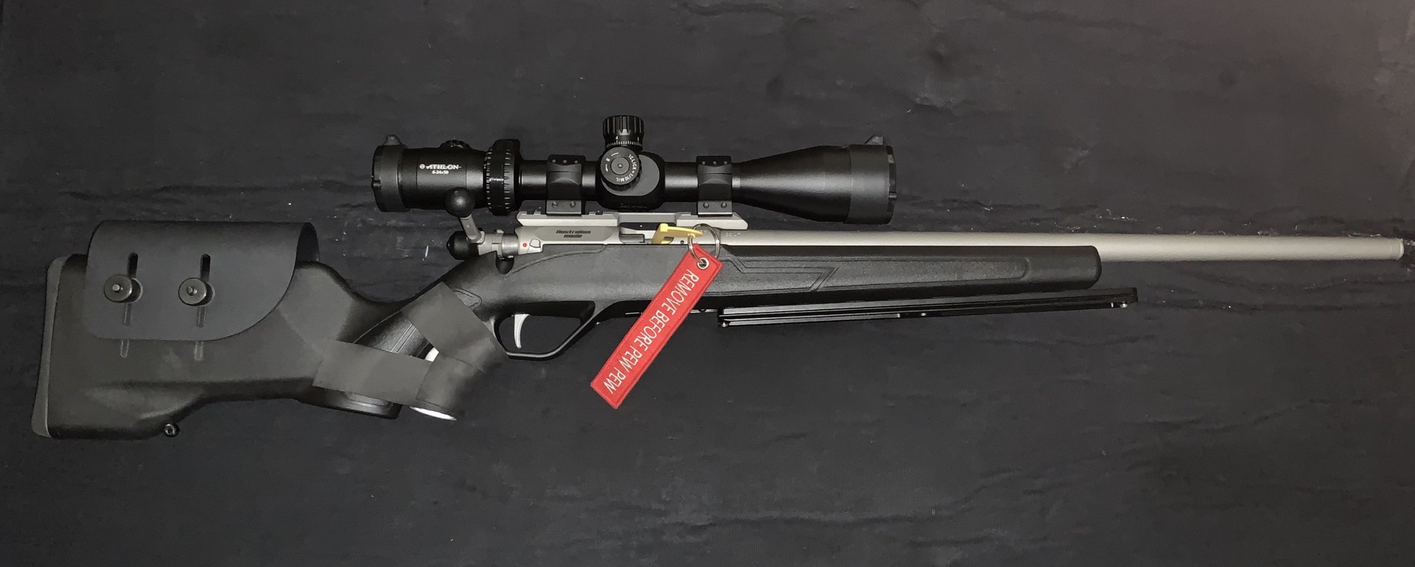

B73F6727-AC23-4C9A-8F9D-18E0A88C3A28.jpegHere is what I ended up with...
The grip is a 45 angle 3/4 pvc. It is notched on the inside of the angle to fit onto the stock and trigger guard. It then has two holes drilled through it with sheet metal screws locking it into place. Then the sticky backed foam sheet over for a surface cover. Kinda ugly but she immediately said her and and trigger finger are in a much better position. Hopefully someday someone will make a chassis for this... not going to hold my breath though.
