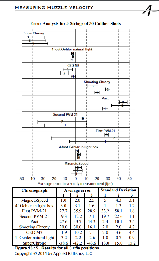

http://www.appliedballisticsllc.com/Articles/ChronographChapter.pdf
Get yourself a good one and you dont have that much to worry about. The lab radar in tests is always right about the same as the magneato speed as well.

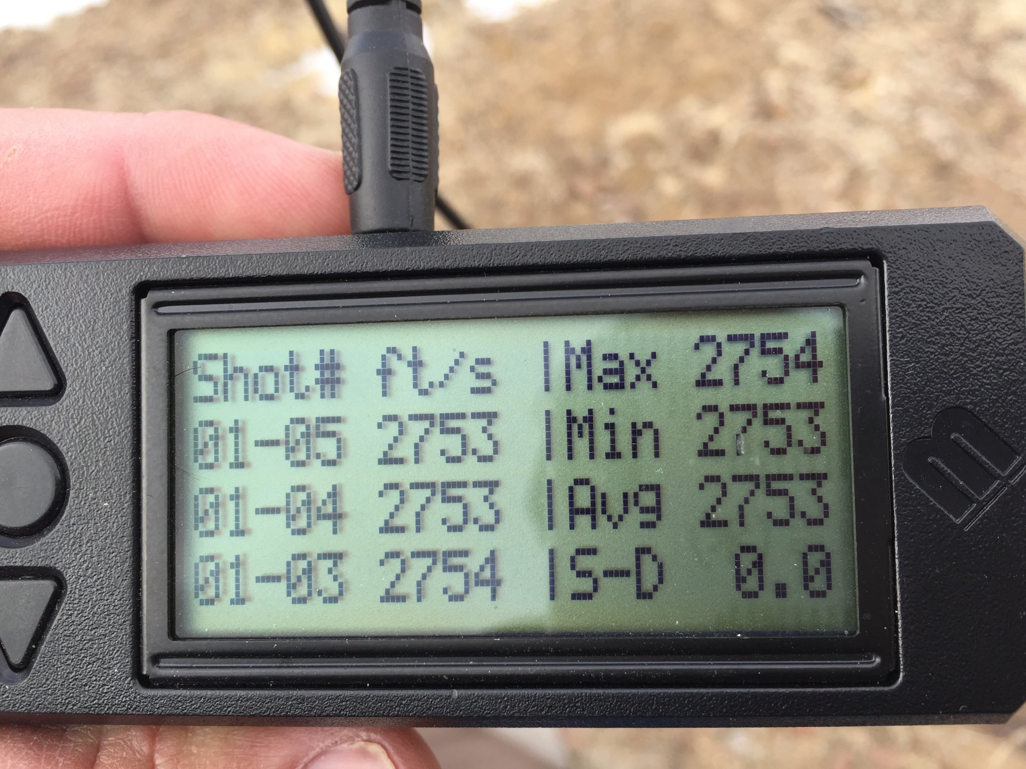

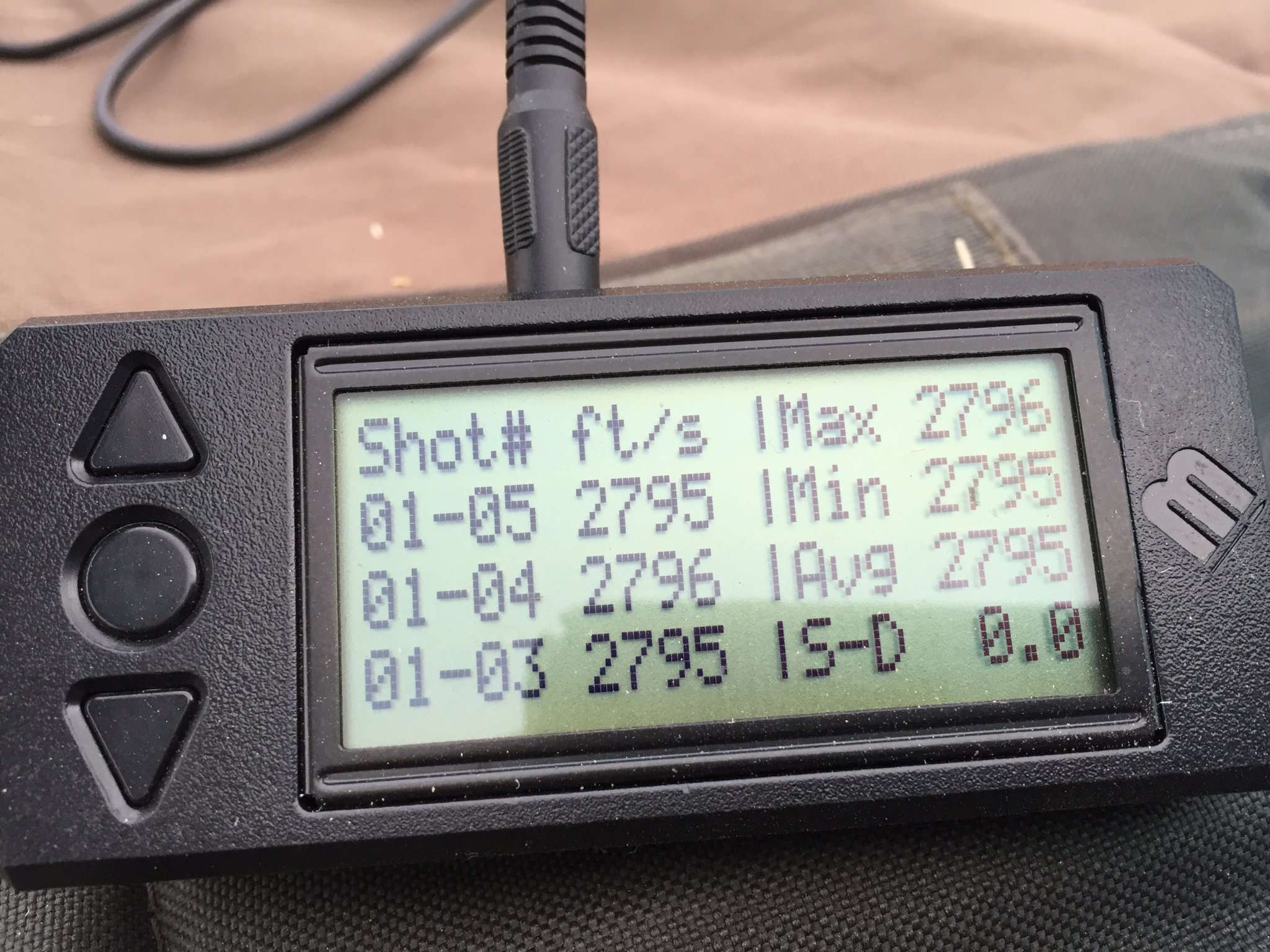

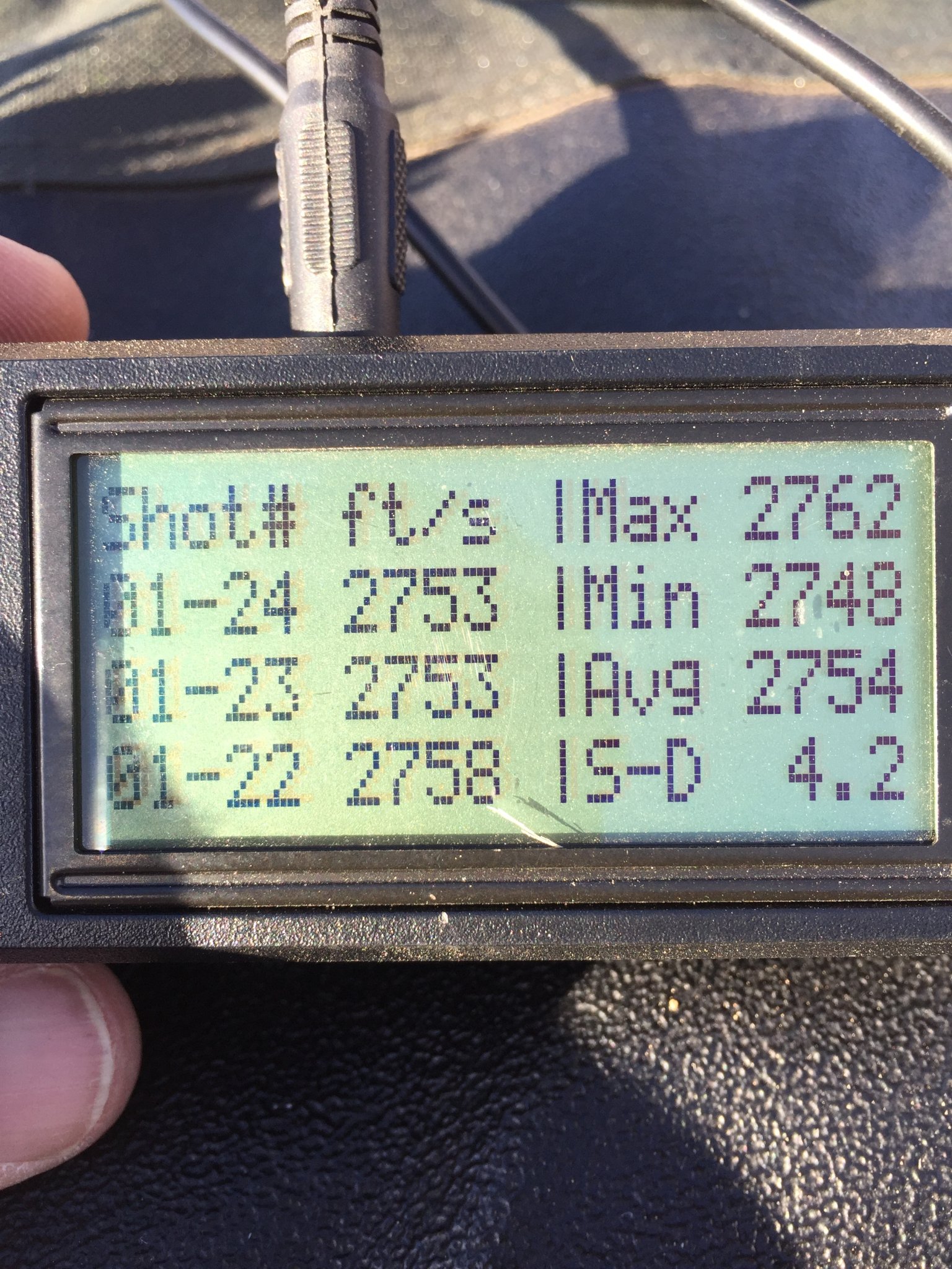

i shoot my entire load development over the magneto speed once I find a load I’ll shoot at least 25 over it...I’ve got several 0-1 and 2fps ESs with 5-10 shots but when I run 25+ over the chrony I always end up in the

The first two are the same load...5 rounds then 24 rounds...3rd is a different load.
