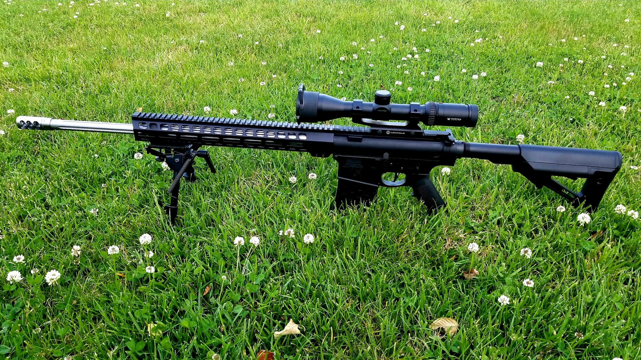

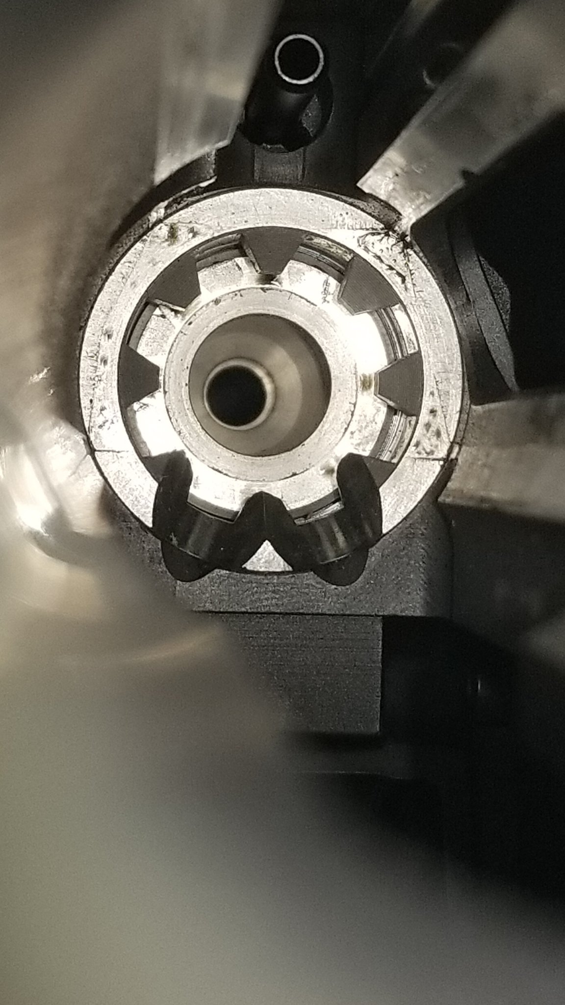

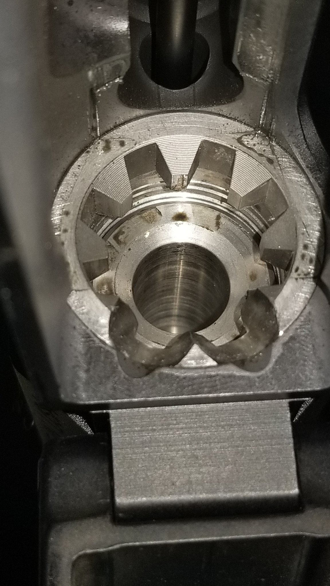

Hey! Nice build! Question for you with that barrel and receiver combo: are there any sort of feed ramps cut into either, and if so, do they match up?
zmannz1984
May 28, 2019
2
1
6
You are the man! I appreciate it. Looks about like mine. I have had feed issues with some projectiles so I may attempt to blend the ramps in the upper to the barrel, but I am going to try modding the feed lips first.

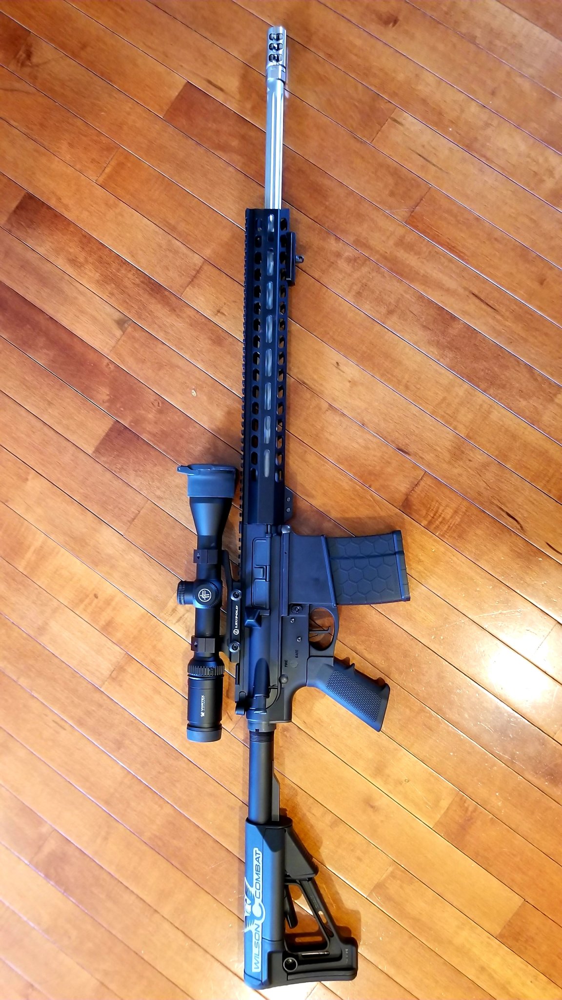

Could you post some chronograph results with the 107 Sierra match Kings???
I'd be curious to see the difference in velocity between you're rifle and a 6MM fat rat.
My 6MM FatRat is pushing the 107 SMK at 2860 and I believe the 95TMK and just below 3000fps
