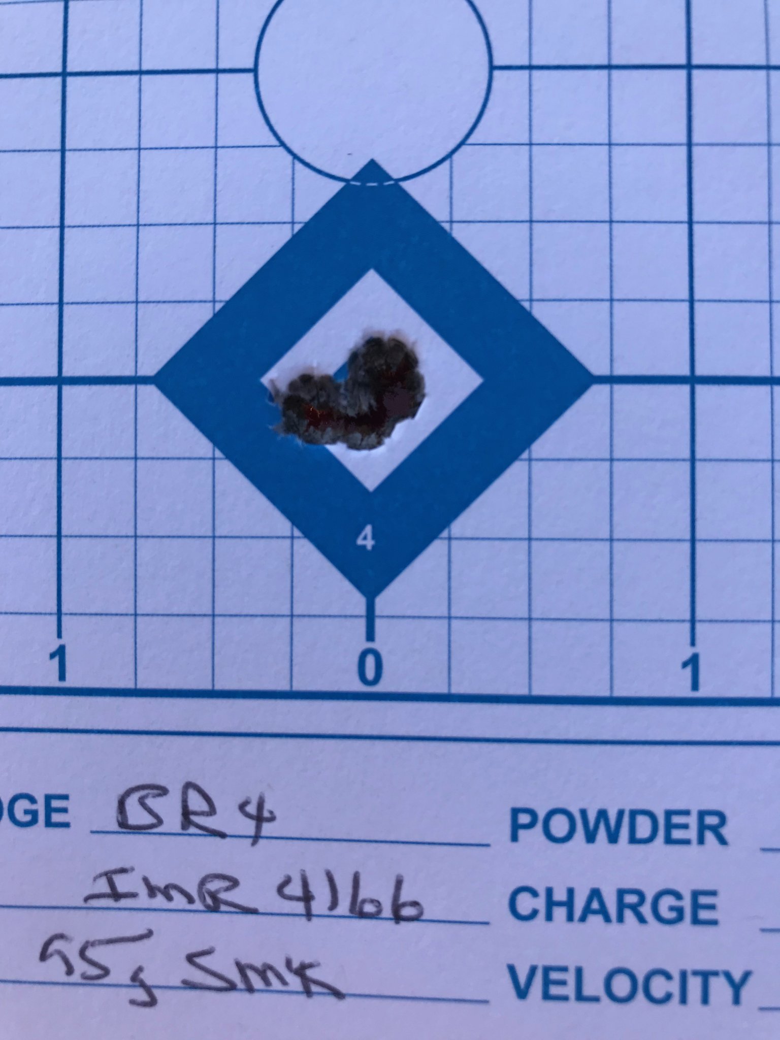

This load only works for me and my application.
always workup your load and mine might not work for you.
Current load is holding fine. Lapua brass, CCI450 primers, Sierra 95g smk 31.85g(A&D FX120i scale) IMR4166 @3033fps
Just had to move bullet, .001+ 600 rounds. No pressure signs. Case is plenty full

No you don't need a small base die.
I use Forster micro seater and their custom FL sizing die honed out to .267 for Lapua brass
I anneal and FL size every time. That's what works for me.

Thanks all. Ranger188, does that give you .002 tension? You"re my man- I've got a bunch of 4166 to burn.
Ranger188
Belligerents
Dec 13, 2018
301
150
49
A little less. ( .0015) I know of a few that go .266
The .267 has been working for me, so I see no need to change.
This is with a no turn neck chamber.
