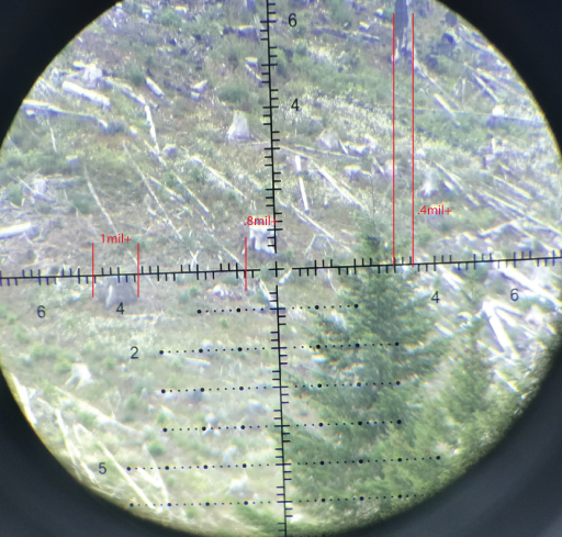

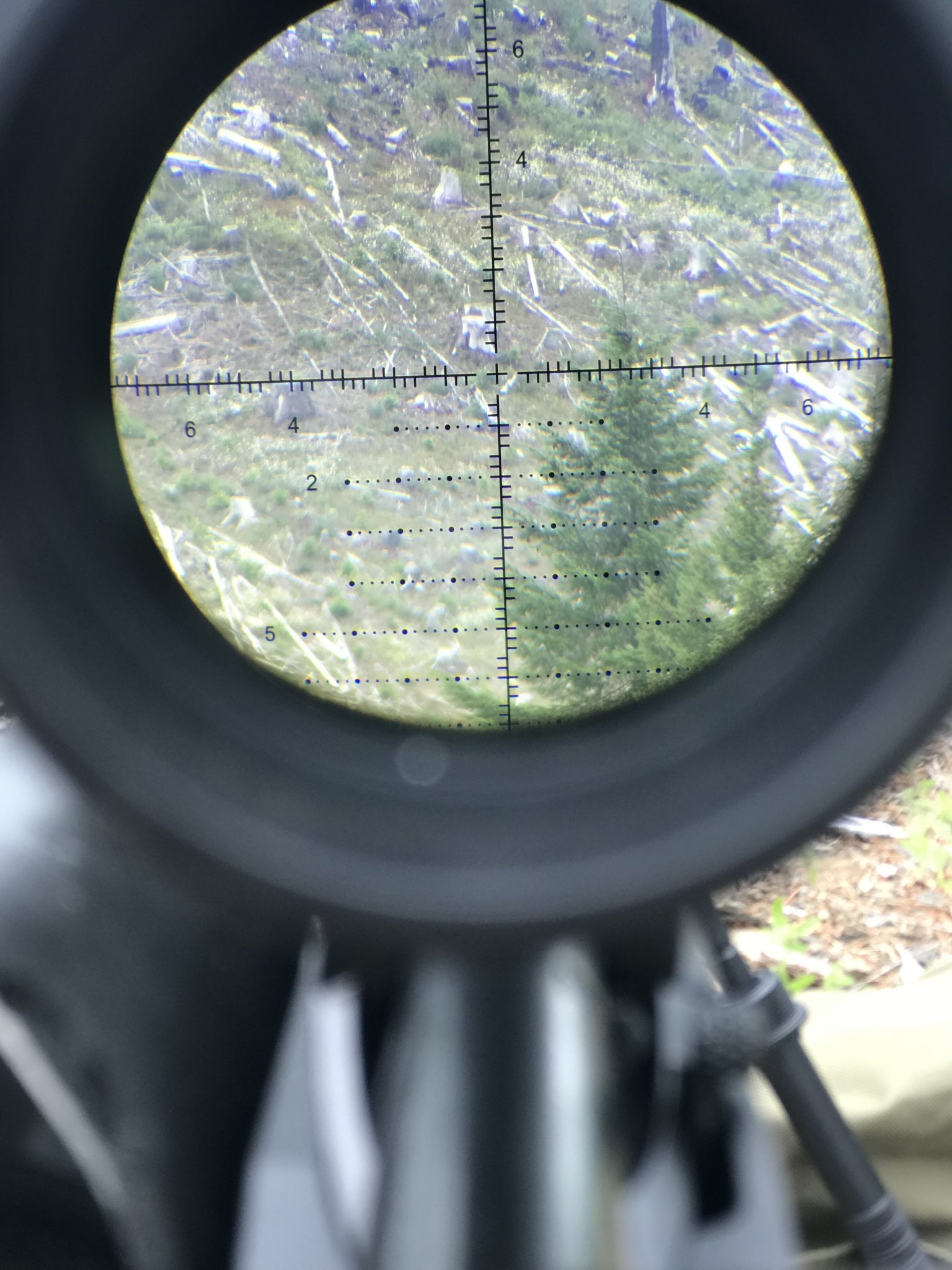

Last Saturday.
260 Remington at approximately 1900 yards.
147 ELD-M at 2780.
Can you help me understand what we are looking at in the scope?
Mostly what where you shooting, the stumps??
That must be some hard shooting as I do not see a thing in the scope that would indicate much of a impact with a 140.. It'd be rough with my 338s.
Also, not sure but those stumps are either giant, MUCH larger than the trees at your FFP or this is like the dinty moore stew can in shooter.. :)
I am not say that you were not shooting 1900, just that that scope image looks strange to be your target area at that distance.
Left to right stump 68.5"+ - 54.75"+ upper part of the tree shown for comparison
Look 1 mill to the right and . 6 high of the center.
That is a 16” plate there.
Hits at that distance are really hard to spot.
I only saw 4 of the 9 shots I fired at it.
That’s a really small target for that distance and I’m lucky I hit it even once.
The last three shots were all within about a 24” area.
Kinda proud of that fact.
Those stumps are Oregon old growth.
They range from 36-60 plus inches.
