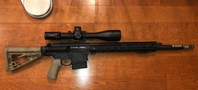

I was recently inspired by a 6.5 creedmoor build on another forum using the Dracos Jacket 6.5 creedmoor barrel. So far I haven't done any shooting past 400 yards or any grouping past 100 yards, but I figured I'd share my thoughts so far and update along the way.
Purpose of build: Sub MOA and Minimal (relative) weight - 200-600 yard hunting/200-1000 yard target
Many of the longer range gasser builds seem to have a total weight from 13-15lbs. That's heavy and I don't like to carry heavy things very far. Or at all really.
My goal was to have a bare rifle under 10lbs capable of tagging steel repeatedly out to 1000 and deer sized game out to 600. To date I haven't had a chance to do either with this particular rifle, but the paper accuracy at 100yrds leads me to believe it will be capable of doing either without too many issues
The weight of the rifle with optics/empty mag (and without the 14oz bipod) is 10lb 12oz. That's keeping on track with my purpose.

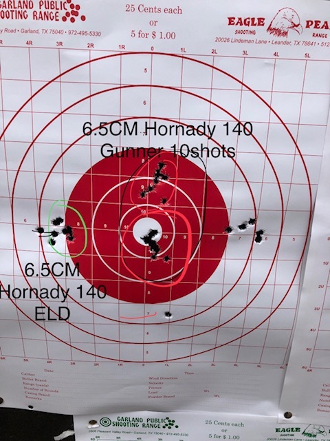

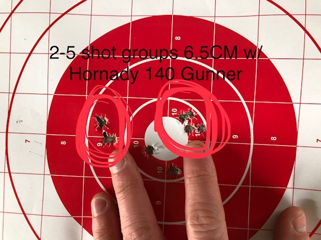

The two pictures of groupings are as follows:
Top - Left group - 7 shots with Hornady 140 ELD box ammo; Middle - 2 separate 10 round groups using Hornady 140 HPBT Gunner; Right - Different build in 6.5grendel
Bottom - Two separate 5 shot groups with Hornady 140 Gunner
The barrel has only had 100 rounds through it so far. I suspect the groups may tighten up in the future after the barrel has a few more rounds and it isn't so damn cold. I'm a step above useless when the temperature is below 50 degrees.

Build List:
Upper 2A Xanthos
Bolt Carrier - JP Lmos with RCA Adjustable Gas Key
Bolt - Aim Surplus Nitride 308
Barrel - Dracos Straight Jacket 6.5 Creedmoor 22"
Rail - Midwest 15" Mlok
Brake - Anarchy Outdoor Titanium 30cal brake
Lower - 2A Xanthos
LPK - Spikes
Trigger - CMC 3.5lb
Rogers Super Stoc/BCM Grip
Buffer - JP Silent Capture Spring
Optics - Kahles 624i
Mount - Aero 34mm SPR

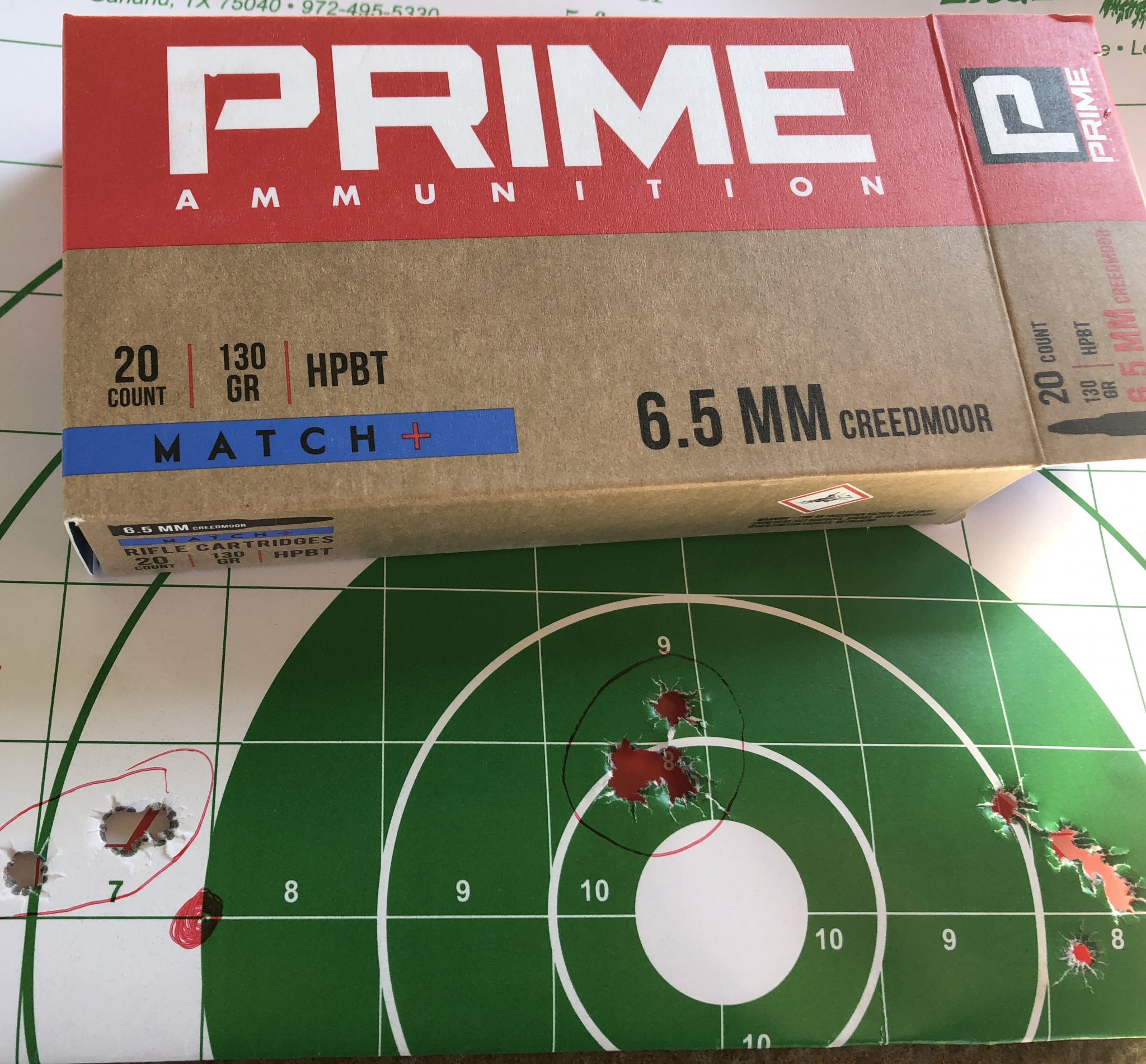

Had a chance to run some Prime ammo through it today. Was pretty pleased with the results. Both of the circled groups are 5 rounds at 100 yards. The group on the right is 5 rounds of 140gr Hornady gunner ammo. Since I’m apparently a sucker for marketing and things that are lightweight, I picked up one of the BSF carbon jacketed barrels. I’ll install in the next few weeks and see how it shoots. The BSF weighs 36.5oz compared to the Dracos at 57oz.
