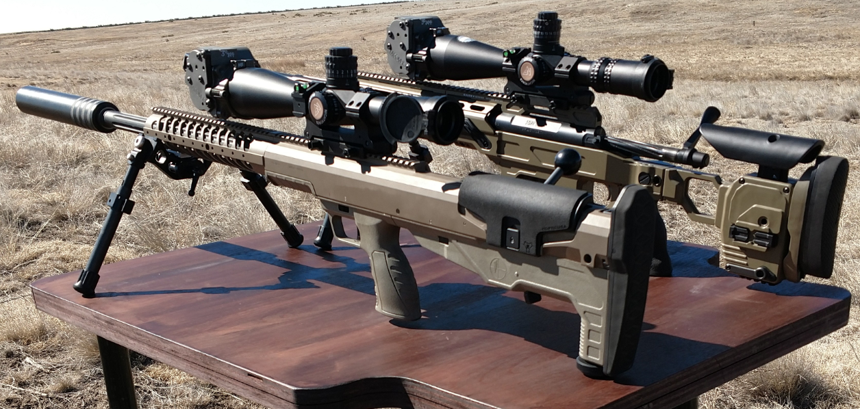

To get the most out of your elevation turret on the 7-35 requires a 15-16 mil mount. I used the ERA-TAC adjustable cant mount to achieve that. Then, with a 100 yard zero you'll have enough elevation to get you out to 2640+ without any holdover on the reticle. Anything beyond that will require using the reticle or going to a Charlie Tarac unit. I think I still have a pic of my old rig I'll try to post.

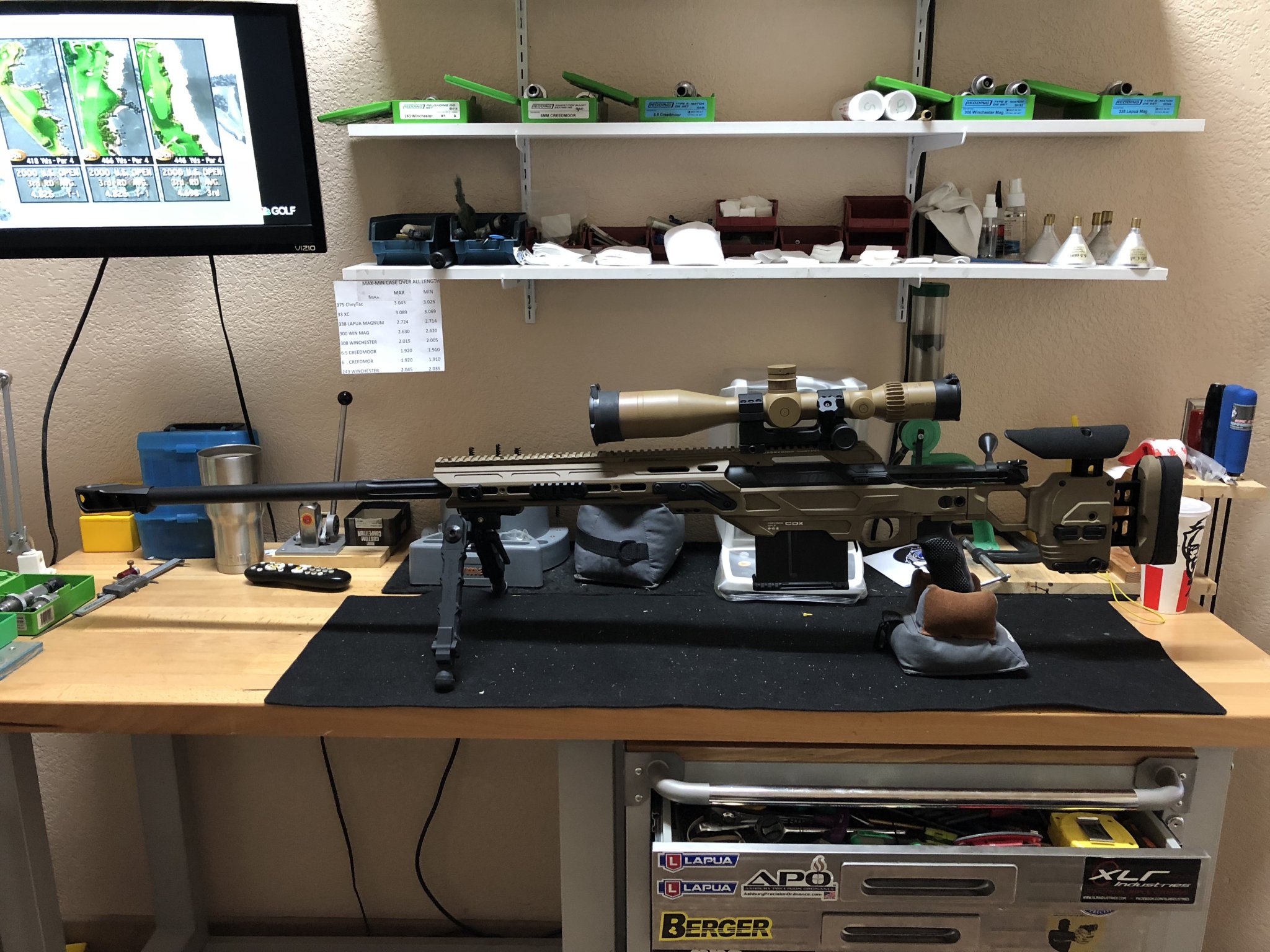

The other way to go is get the IVEY Adjustable scope mount. It goes from 0 to 60 mils. I just got my Cadex Shadow 375CT and plan on a 100 yard zero. I am using a S&B 3X27 35 mil of travel in the scope and it should have about 2 mils left after i zero it. So i will have about 93 mils of come up.IMG_0203.jpeg
