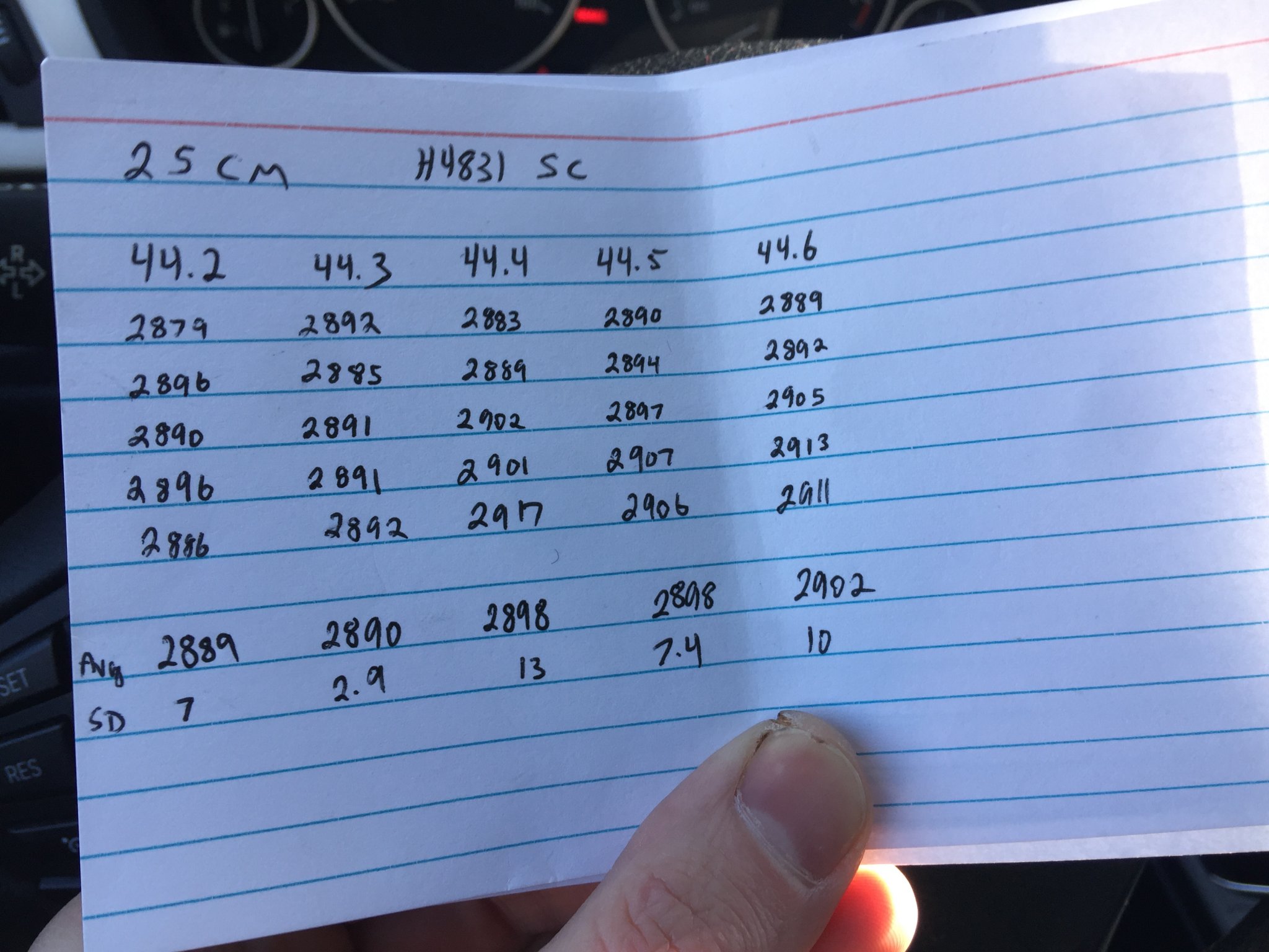

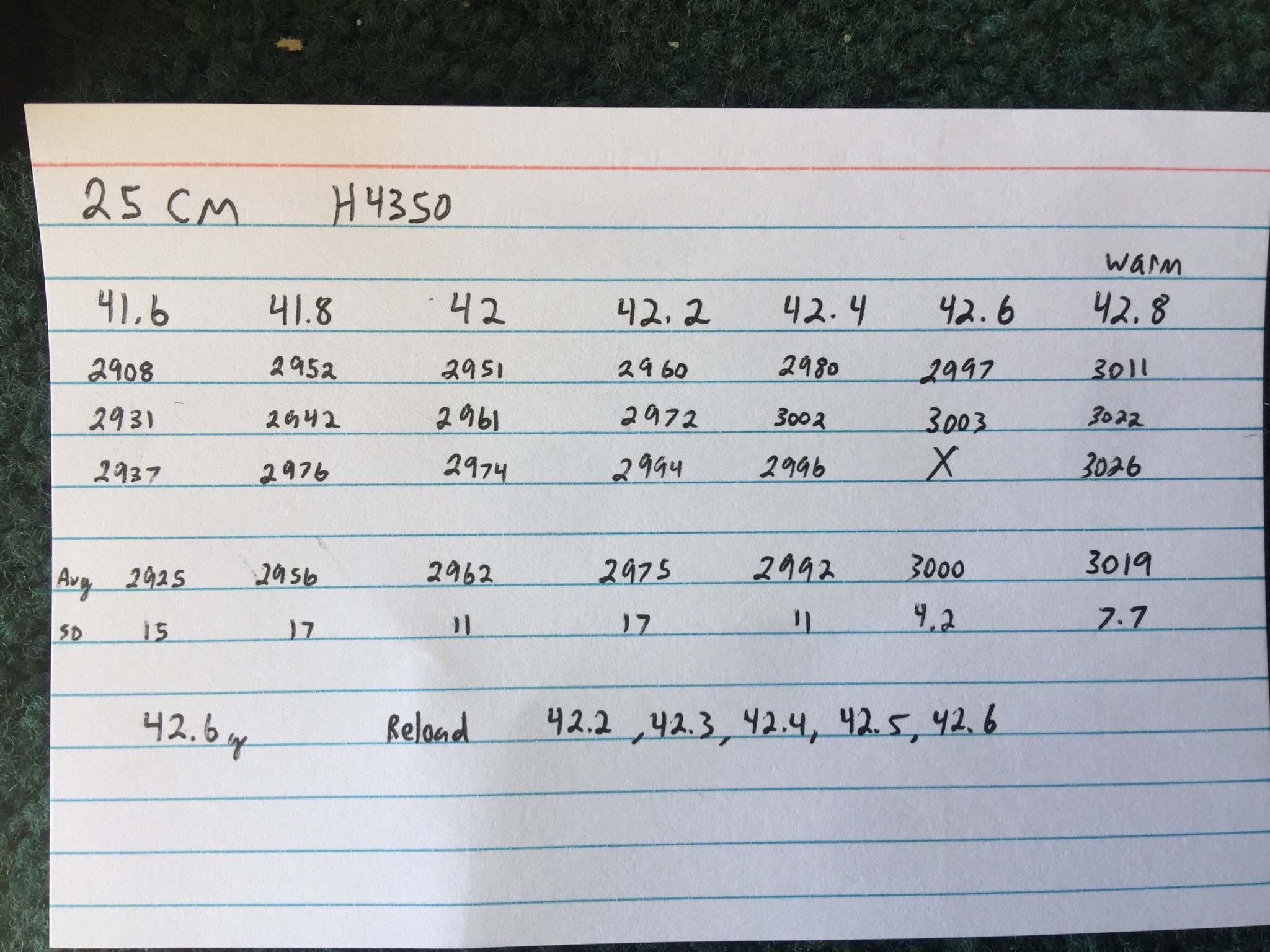

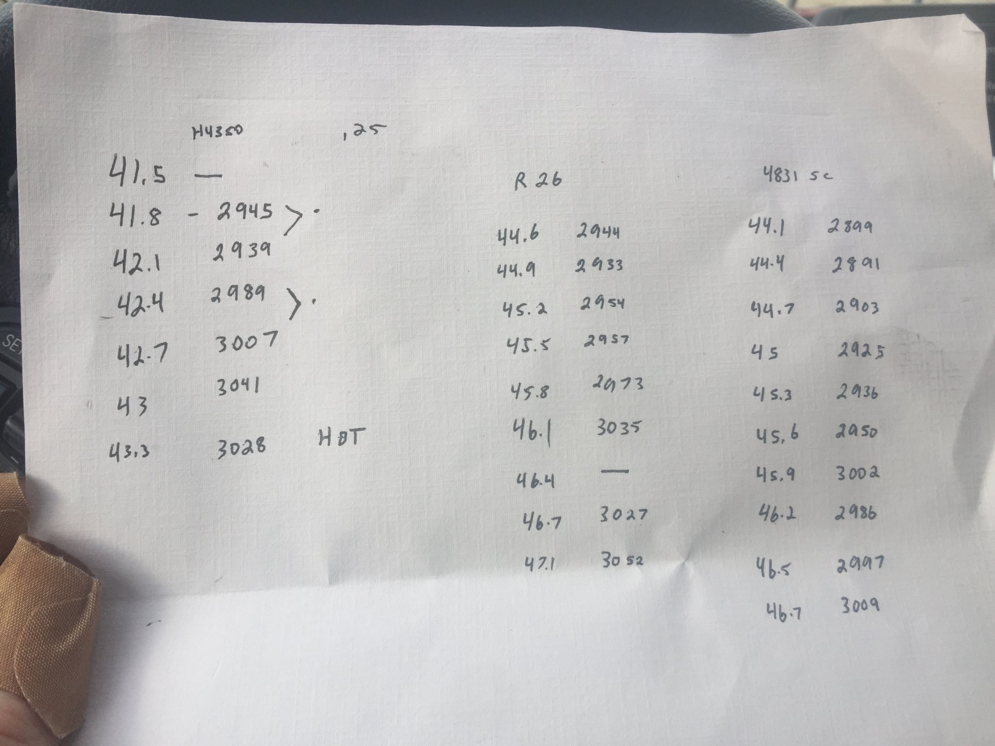

I loaded up some .25CM with H4350, R26, and H4831sc and conducted a broad ladder test. I choose to then test potential nodes. Below is the data. R26 didn’t gain much over H4350 so I excluded it.
Edited to add: Peterson 6.5CM SRP Brass, .281 bushing, trimmed to 1.910, CCI SRP, 28” Bartlein with gemtech dagger suppressor
1317E77D-F84B-475F-8828-49779D52D140.jpeg2FE353DD-E9BE-4B3A-AE6E-A08D155068F3.jpeg8C12598C-6576-4F60-BDA1-3BAD391ABF29.jpeg

Can you please add bbl length, the brand of brass and primer that you used for these? The different manufacturers of creedmoor brass vary greatly in capacity and will effect the results of these tests.

Edited above post, thank you.
