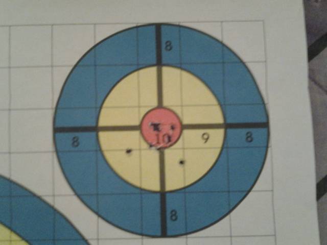

You may consider this ammo.
AMERICAN EAGLE RIMFIRE SUPPRESSOR
https://www.federalpremium.com/prod...le/american-eagle-rimfire-suppressor/ae22sup1
10 rouds at 50yd, ruger 10/22 sparrow suppressor.
Gun was still fouled with match lube residue, lots.
The fliers were do to high cal brake shooting next to me on a connected bench.
Will clean the bore and try for a better groop soon but was fairly happy with initial sight in.
They claim to shoot cleaner suppressed, we will see.

Well I cleaned the bore and my groups got worse not better with the A E suppress ammo.
Don't think I will continue to copper it up.
Evedently my E R Shaw barrel won't eat tofu or shoot copper coated anything worth a damn.
I figure maybe something to do with the tight tube tolerance, feeds and ejects most anything.
Has a (benz ?) Chamber so not the vudoo tight chamber (hassle).
Is the tight tube just not compatible with copper coated even though its standard velocity.
Figure I will retry cci sv and properly let the barrel grease up a couple hundred rounds before I make a decision on it.
If the only difference in cci sv and the green tag is lot controll and inspection tolerance the lead, powder and lube will be the same?
I am guessing I can swap between the 2 without change except in group sizes, more fliers?
For 10 -15 cents a shot price difference and availability it mite be a go.

First trip to the range to get acquainted with my Vudoo.
After 10 rounds to bore sight at 25 and 50 yds and 8 - 5 shot groups at 50 yds. 2 dry patches down the bore and shot these 2 shot groups @50 yds with SK Standard Plus and a Tactical Solutions Axion suppressor. I felt most of the strays were on me due to Yellow Jackets harassing me and eye box/cheek weld issues due to the loaner optic mount being too far forward. Our range also has challenging wind patterns, usually 3-7 mph and frequently will come from all 4 points on the compass while shooting 50 rounds.
Next trip to the range I'll shoot the same scenario with and without the suppressor using SK Std+ and CCI SV 0035 and see how it prints.
One thing I'm certain about...… the Vudoo is a real pleasure to shoot. Couldn't be more pleased with this function/performance of the rifle. (y)

FWIW - Here's a with and without my Axiom can shooting CCI SV 0035 at 50 yards today.
This rifle is a lot better than I am...…. currently. :)
