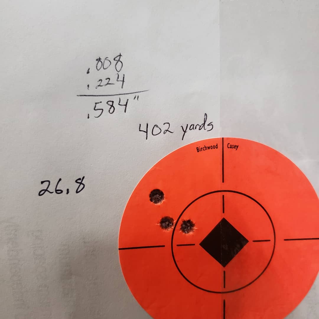

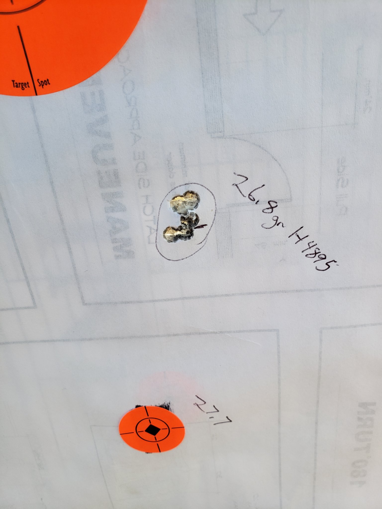

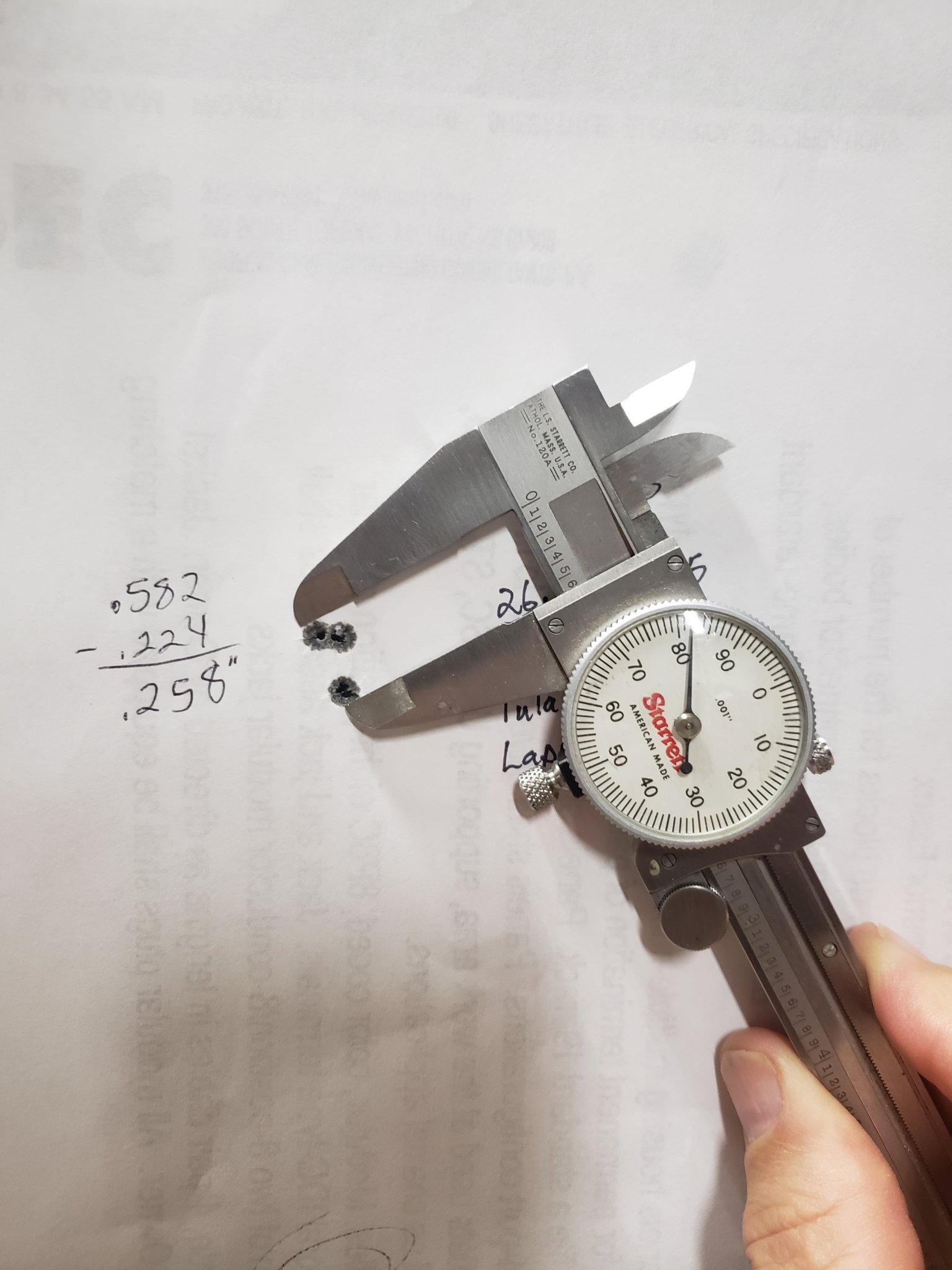

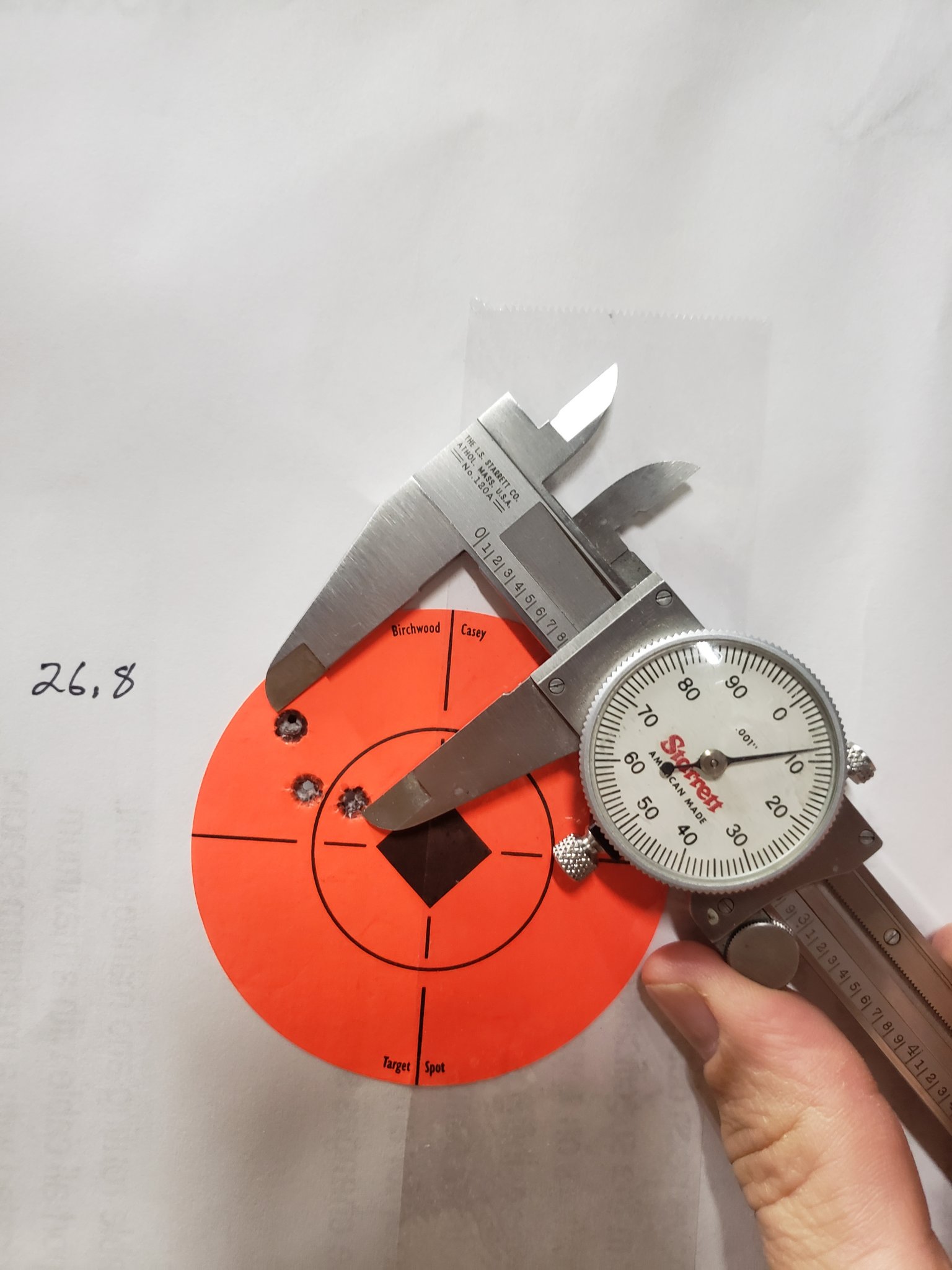

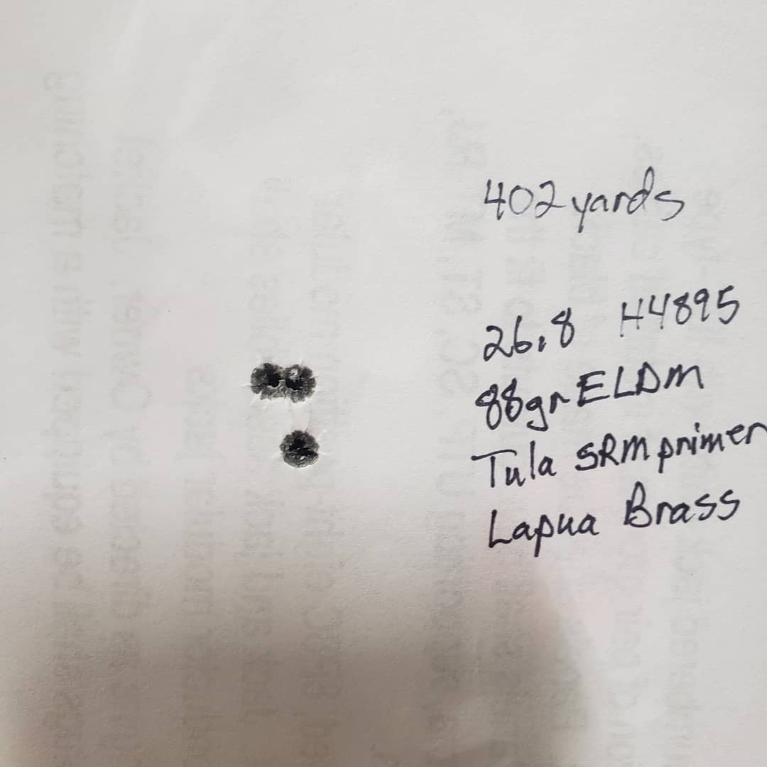

260284
Belligerents
Feb 15, 2017
1,099
266
89
Kansas
88 eldm .020" off
26" bartlein
Lapua brass
H4895 26.8
3004 fps at 43deg
Tula Primer
First 5 shots suppressed, with the MS on.
7036466
I also chrono'd 27.1, 27.4, and 27.7. Started getting ejector marks at 27.7
Reactions: BagleyOutdoors
