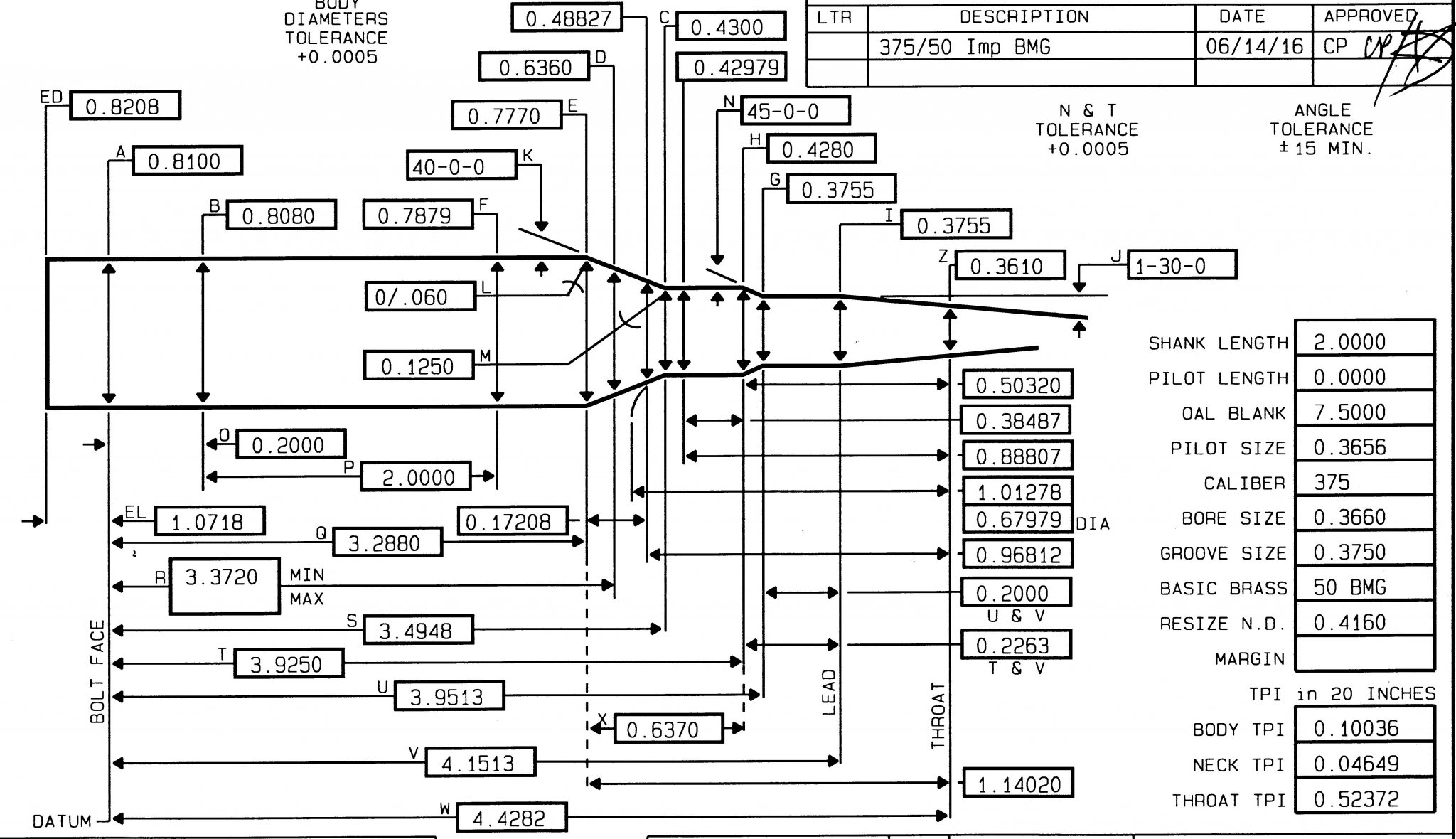

Klaus reached a higher MV than that with his Mach IV wildcat decades ago :)
The 375/BMG wildcat(s) are being revived right now due better projectile designs, alloy and more temp stable propellants. GRANTED propellants are the weak link in this wildcat but it can be worked out. Well barrel life is the weakest link but....who cares lol.
Yes that is correct MV.
Here is reamer I used but throated for longer, modern monolithics.
Sincerely,
Theis
