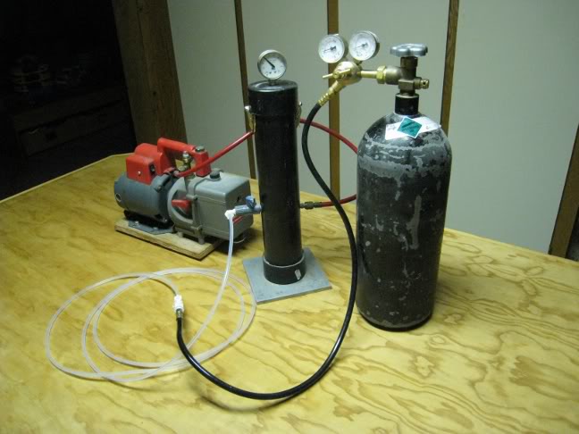

PM reply, just to save a lot of typing.
The most expensive part of this setup is the negative zero vacumn motor. $1,200.oo, but it you do a lot of scope charging, it's well worth it.
Large PVC pipe opens on one end. Loosen any lens or screw that allows access to the inside, open vacuum valve, start motor. When it reads zero, shut if off, open the halogen valve, allow to flow inside for 5 minutes, close valve, remove scope and immediately tighten lens or screws. You won't lose any halogen in that sort period.

Your vacuum motor is a vacuum pump that about every HVAC repairman has on their truck/van for $200-$750 depending on how many CFM they are rated for. I use a JB 7.5 cfm model myself.

Ma is a good bookkeeper. I did pay $1,200 for a vacuum system, but not that one. It was for the shop, however............
I still got taken to the vacuum cleaners. The old invoice shows that I paid $925.00 for that little negative zero pump.
Oh well..................
