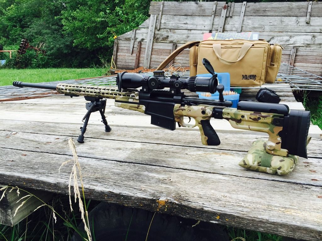

    Yesterday, I finished up developing the lo0ad for my BAT Machine actioned long range hunter 300 NM. Wicked accurate and easy to find a load.... Berger 230, Retumbo 86 gr., FGM magnum, 2973 fps out of a 24" suppressed Broughton.... hole in hole accurate at 100M. tomorrow I will stretch it out to a thousand. I am confident it will do well.

    Meet the newest addition to the family, Louise. Picked her up from GAP today. These are shots 4, 5, & 6 at 102y. I shot a nice 1" 3-shot group at 356y for the final group of the evening. Load: 230gr Berger hybrid, 88gr H50BMG, 2.847" to ogive. I've done zero load work so needless to say, I'm really looking forward to getting her dialed in! Rifle specs:
    Surgeon XL
    KMW stock in McM camo
    Bartlein 1-9 twist finished at 27"
    Badger FTE brake
    Finished in FDE cerakote

      That is really pretty! Glad to see you're back in the NM game. I'd love to hear what kind of velocity you are getting with the 50 BMG. I am using Retumbo right now and would like to see if I could get a little more speed.
      CJ97

      Thanks CJ97. I haven't chrono'd that load yet - didn't have time. I'm expecting it to be in the 2875-2900 range. There were no pressure signs so I'm moving up to 89gr and 90gr. I'll post velocities to this thread when I have a chance to get out and shoot again.

        I bet 2750. It is too slow for this case. RL 33 is the powder for the 300 Norma
        Jack

                                                  Picked up the new GAP hunting build and I found a screamer of a load right off the bat! Double based powders (N570, RE-33, etc) are where it's at for the Norma - lower pressures and high velocities.
                                                  Berger 215gr Hybrid
                                                  Norma brass - 3x fired
                                                  FGMM 215 primer
                                                  88gr N570
                                                  .015 jump
                                                  Bartlein 27" 1-10 Sendero contour
                                                  3063fps
                                                  SD: 5.7
                                                  These velocities are through a brand new barrel - 44rds fired so far. It should pick up speed as it breaks in. Couldn't be happier.
