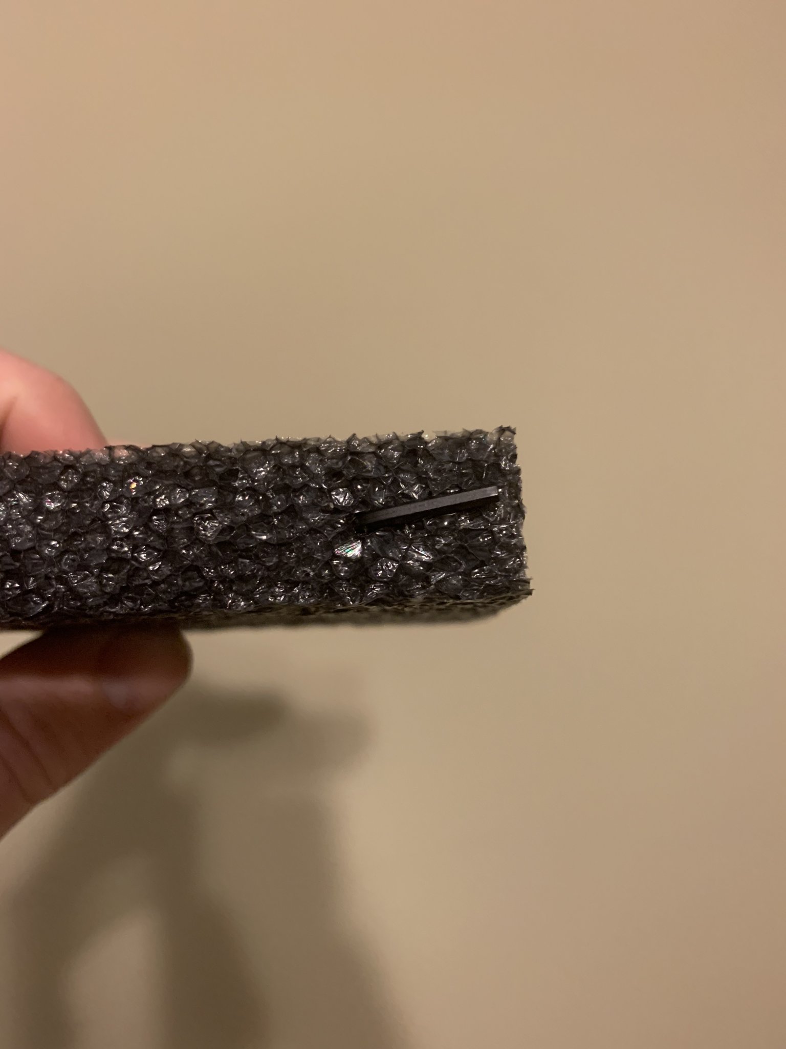

2. The hex wrench for adjusting the turrets came with mine. It was stuck in one of the foam blocks on the ends of the box to keep it from rattling around. I would hope they send at least that in the box (but then again, my spuhr didn't come with any kind of wrench...).
