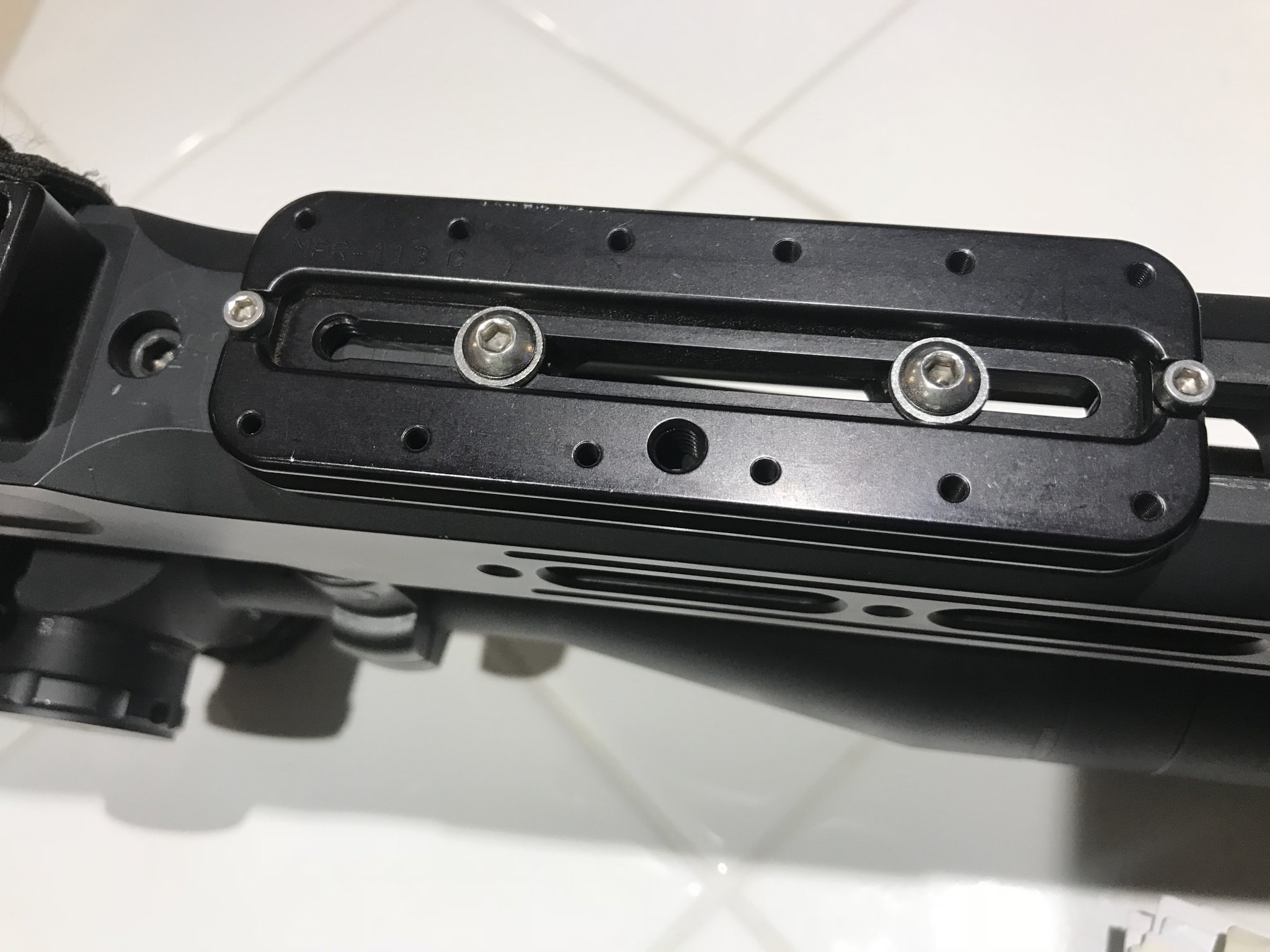

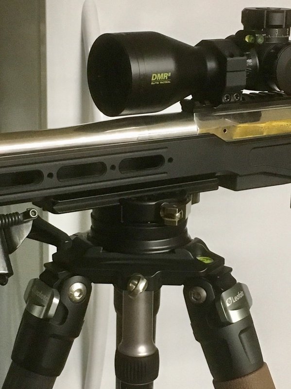

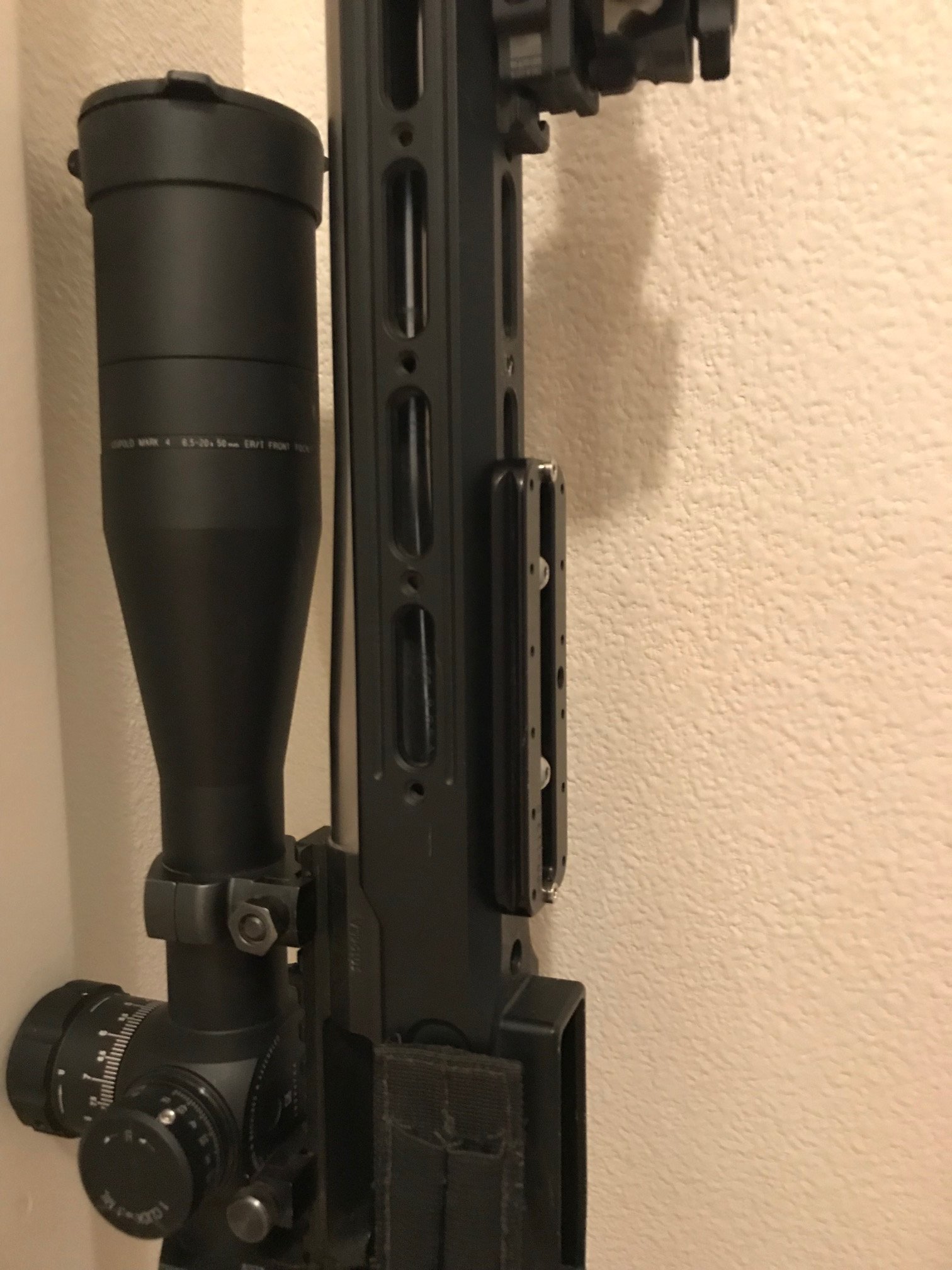

I drilled and tapped an extra hole in my Element and bolted an Arca plate to it for a tripod mount, Just forward of the mag well.
It works great.

Yep it's that rail
I picked up some stainless washers and screws . I used a spring loaded center punch (Harbor Freight) to locate the hole position and then drilled and tapped an extra hole (same thread as the other holes in the XLR stock) and set the fasteners with blue Loctite. This method allows me to shift the plate fore or aft as needed by loosening the screws. http://soar.reallyrightstuff.com/MPR-113-113mm-rail
