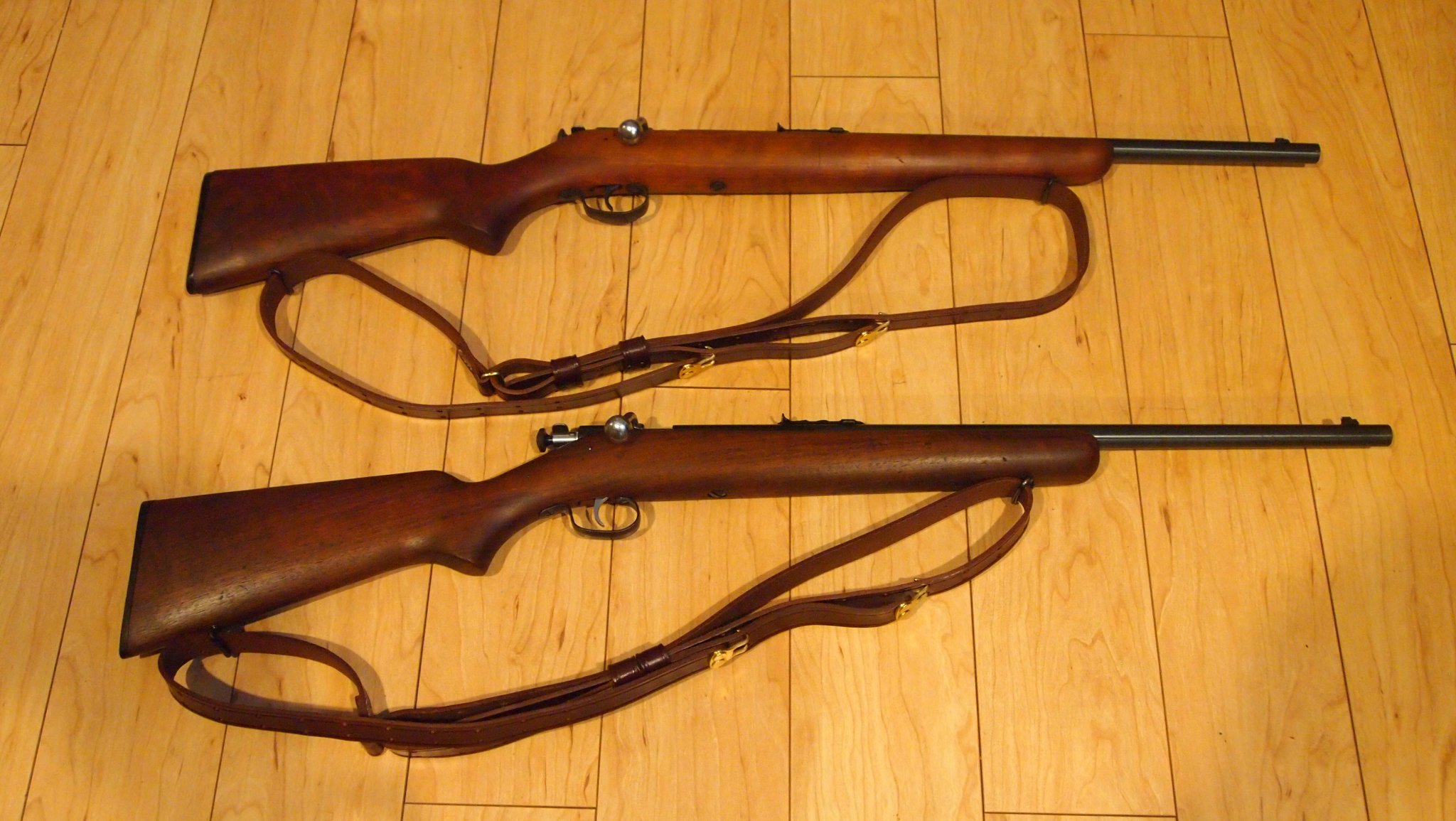

I have given each of my kids a 67A "Boys Rifle".
Neat guns but far from competition ready. As you noticed the firing mechanism is Neanderthal in its primitiveness.
Ideal trainers with their one shot, manual cock action.
The "Boys Rifle" version has a shortened length of pull and shorter barrel for well "boys" and in the case of my daughter "girls".
Its the type of gun that you would give a kid limited ammo with and challenge them with "You dont not get another round, unless you make a hit with this one."
Probably a lot of kids, families fed themselves during the depression with these rifles.

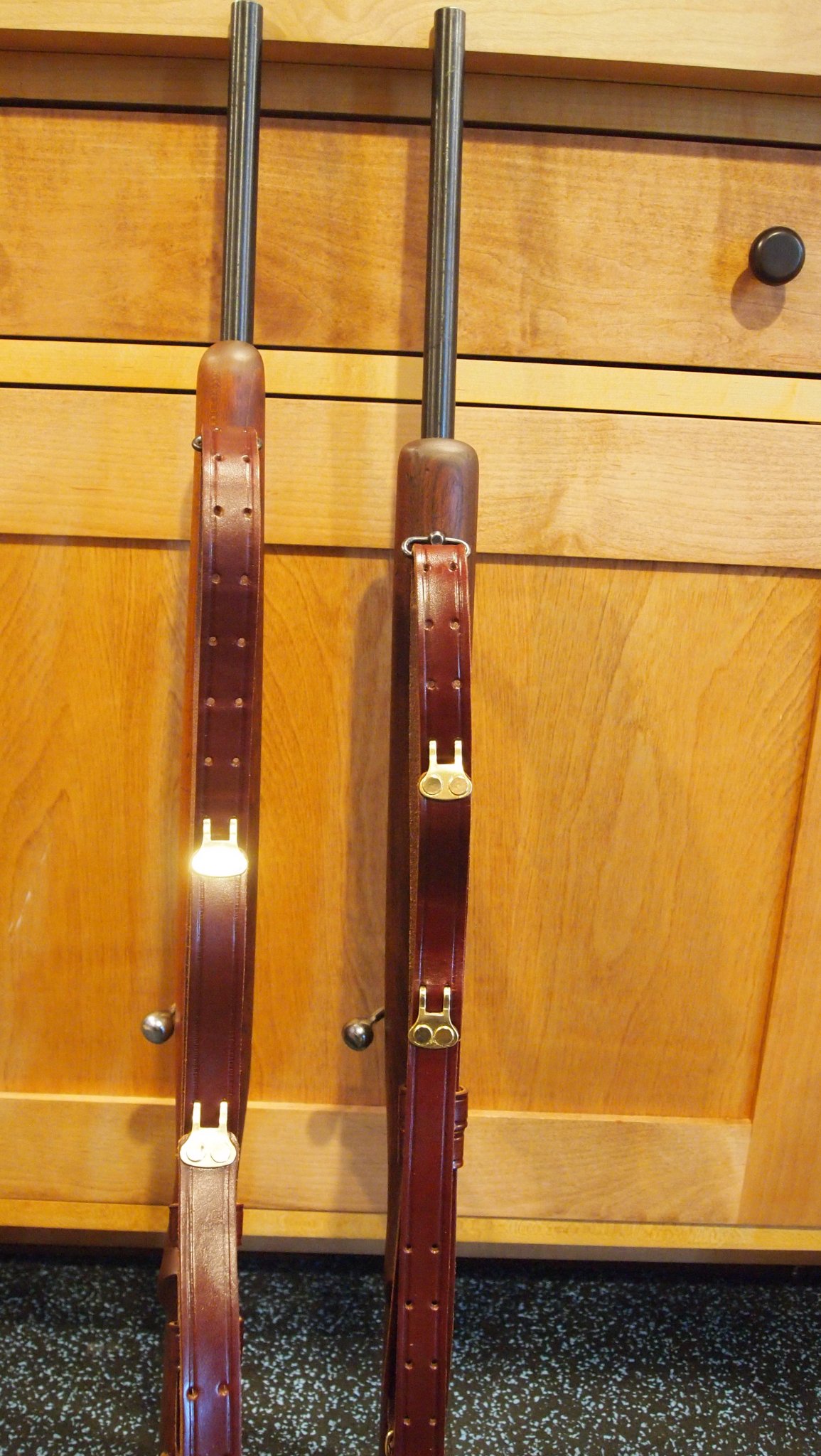

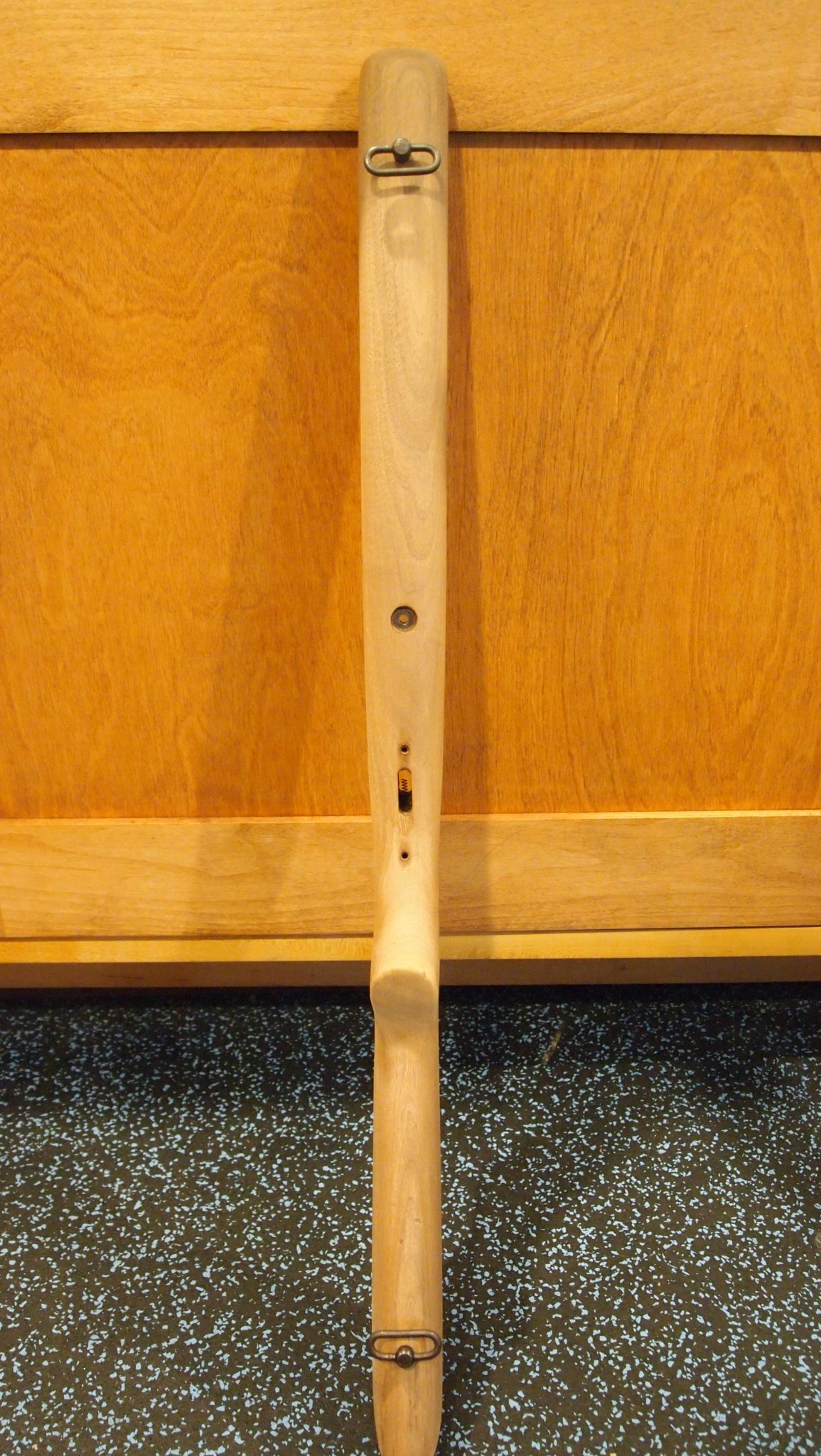

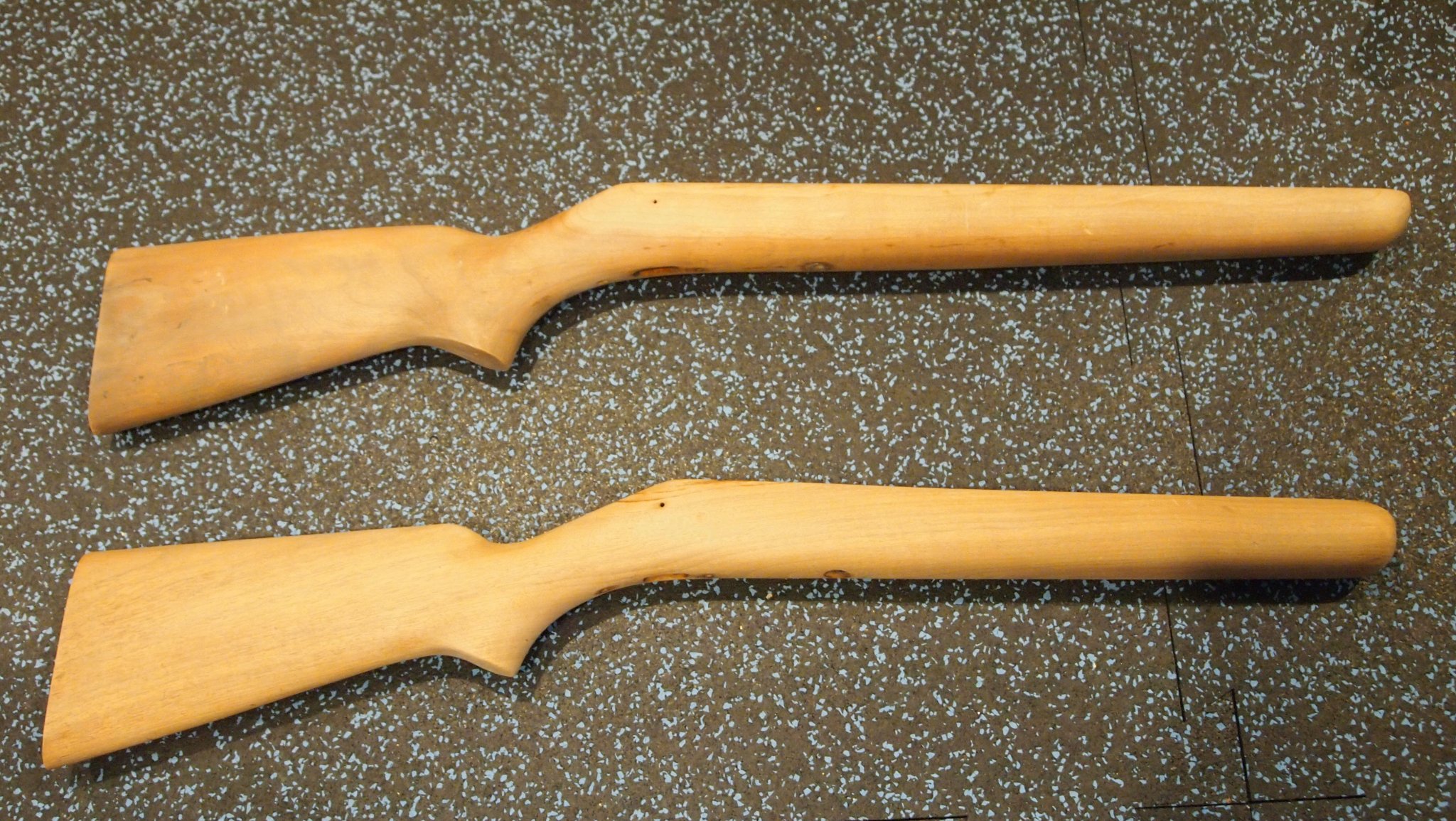

I recently stripped the stocks on my kids guns and did them up in linseed oil, added some Winchester M70 1 inch rings and mini M1907 slings for carry...
Before...
After....
Likes: spife7980

Those look great! How was it driving those trigger retaining pins out? Mines pretty mucked up, I cant even see it on one side so Im afraid Ill have to dig it out to actually remove the trigger.

I used a 1/16" punch from right to left, came right out with a millenia of goo covering the head of the pin. Later went right back in with no effort. I soaked the stock so much in stripper that the wood probably swelled some and ensured the pin hole stayed tight.
The finish actually came off pretty easy with a product called "Dads Stripper" or something like that. Nothing like the Remington RKW shit they used on 700s.
Like you I was able to get a spare stock so I still have the originals as well as my refinished stocks.

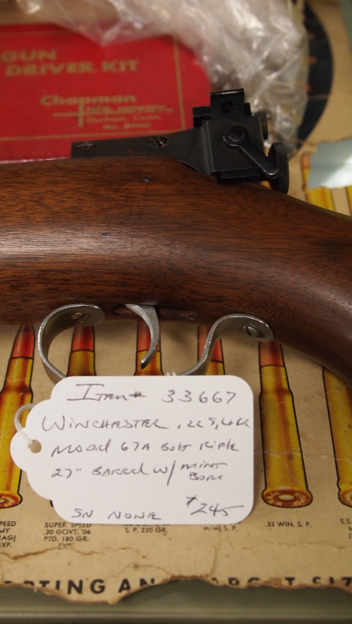

Went by the local shop today and took a look at the stand of 67As. Looks like only a couple left and some magazine fed .22.
I should have got pictures of the first one on the left with the blue trigger and trigger guard.
I did see this one with the nicely done rear sight that maintained the flip blade safety and still allows for bolt removal.

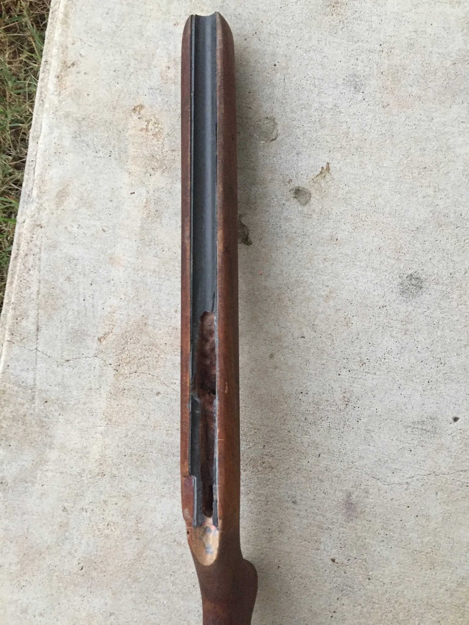

I didnt win the auction.
Its just about the ugliest bed job ever but it cant be any worse than what it had!
I didnt realize how tough it would be to do with as little effort as possible evenly as opposed to just doing the action and free floating the barrel.
Its not quite centered and it has a few voids and I fucked up and dammed it to bed behind the "recoil lug" not remembering that it has to be free for the ejector spring to pass through so it had a good bit dremeled back out but so far the 10 bucks in bedding compound Ive invested into the rifle is good enough for something that wont ever get shot. (Dad bought a martini as an off hand gun the week after I got to piddling with this one)
Maybe Ill sand it and stain it some night this evening.
