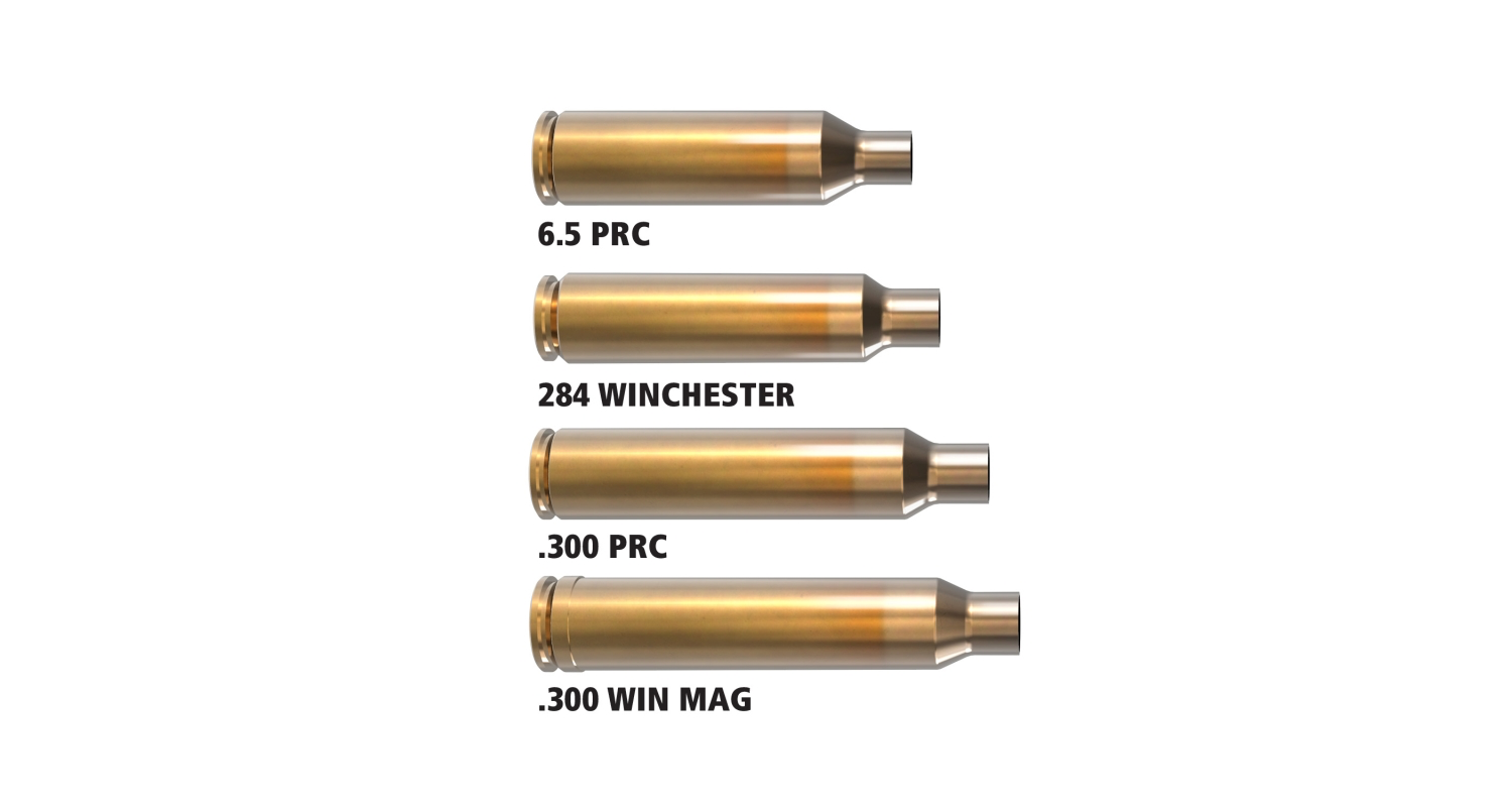

I think people are seeing through the marketing. If you are running a long throated 300wm in a CIP length mag you can match the velocity easily. They basically created a beltless win mag so there isn't any advantage beyond marketing.
That would be fair statement if they weren’t supporting it, or it wast performing. That isn’t the case though. It is absolutely a better case design, which is a step in the right direction. They also make reasonably priced match and hunting ammo for it. I think Berger is the only entity offering the winmag with very high BC bullets, and it’s several dollars per box more expensive. This is just like the .260/creedmoor argument. If you’re vested in the old dog, stay with it. Just getting into a 30 magnum? The PRC seems to be the obvious choice.

That would be fair if they weren’t supporting it, or it wast performing. That isn’t the case though. It is absolutely a better case design, which is a step in the right direction. They also make reasonably priced match and hunting ammo for it. I think Berger is the only entity offering the winmag with very high BC bullets, and it’s several dollars per box more expensive. This is just like the .260/creedmoor argument. If you’re vested in the old dog, stay with it. Just getting into a 30 magnum? The PRC seems to be the obvious choice.
Saying an absolutely better case design is a dramatic overreach. When shot from CIP length mags and throated appropriately they match each other in velocity. They feed equally, 300wm has more brass options, from load data I've seen 300wm takes a little less powder to match velocity, until people have burnt through a lot more 300 PRC barrels we can't accurately compare barrel life. So with that said the only real argument for the 300 PRC over the 300wm is the belt. People that load frequently for the 300wm know that the belt is a non-issue. Me and many other people bump the shoulder when sizing the same way you would most other non-belted cartridges. So realistically I'm not seeing any advantages other than hornadys factory ammo offerings which I will admit is nice for those who don't handload.
You’re comparing a custom throated 300wm to a standard PRC. Not a good comparison. I called a reamer manufacturer, bought a saami PRC reamer, and chambered a barrel. It’s nipping at the heels of my 300 Norma. Accuracy is exceptional with handloads, or Hornady ammo. As I asked earlier in the thread, if you were designing a 30 magnum for modern match bullets, would it look like anything like a 300wm? Would you actually leave the belt on, or delete it and turn that into powder capacity? Would you push the shoulder back and blow out the diameter to keep the bullet bearing surface out of the neck/shoulder junction? The PRC uses a fairly standard recipe for modern long range cartridges. It’s not even two years old on the commercial market. It has a military contract, and every manufacturer you’d want to make a 300 PRC rifle, already does. Because of that, do you really think brass is going to be an issue down the road?
It's actually a fair comparison.... If you are looking at the capabilities of the 2 cartridge's you would want to compare them fairly. I would agree that a short throated 300wm made for lighter hunting bullets wouldn't be able to compete with a 300 PRC throated for 225gr ELDs but no one would choose that short throat if they planned on shooting heavies.
Because 300wm has been around for such a long time you can typically choose from multiple reamers that caters to your type of shooting.
Since the 300 PRC was made with CIP length mags and heavy bullets in mind I'm comparing a 300wm throated for similar capabilities.
If I was designing a 30 Cal cartridge I wouldn't design it so its a ballistic twin to a decades old cartridge. Mine would be closer to a 300 Norma improved with a 30-35 degree shoulder or maybe a slightly shorter modified 300 ultra mag.

If I did not already have a 300 cal magnum and was looking into building one, I would go with a 300 PRC/Norma. But if one already has a 300 Win Mag, then the incremental benefits of having an additional 300 PRC is small. There's no doubt that a 300 PRC is better designed than 300 Win Mag, but incremental improvement is marginal.
Most folks already have a 300 Win Mag, hence the next logical step up is not 300 PRC, but probably a 338 LM or 375/408 CT.
Getting rid of the stupid belt, absolutely made it a better case design. People who load belted mags frequently, like myself, have been bitching about the issues caused by the belt for years. So much so, that Innovative technologies made the Larry Willis Collet die, to help us out sizing the offending portion of case, just above the belt.
We can extrapolate reasonably on barrel life. You can't accurately predict barrel life on anything, it is too variable. Using 1-5 grains more powder to push the same bullet, barrel life is going to be a moot point.
Hodgdon load data is only 1-2 grains different with h1000 and 7977 shooting 200 and 212 grain bullets between the 300PRC and 300WM.

300 PRC
No belt
Better shoulder angle
Better neck positioning
No wondering what reamer to get
Easy to get long range capable ammo
ADG brass on the horizon.
