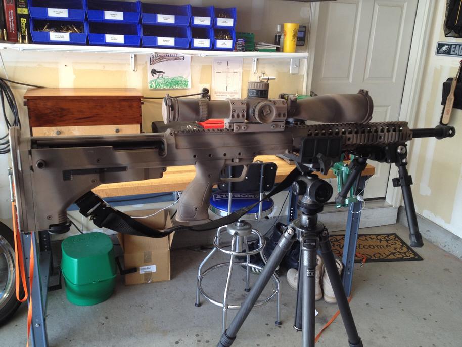

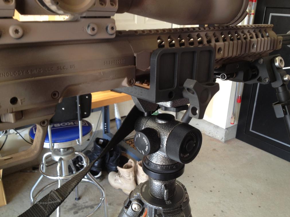

If you plan to use a Larue mount for your rifle rail, this is the only one from Manfrotto that will work. Its not because of the tripod itself, but the mounting plate on this one is different than the other Monfrotto plates. I learned the hard way. I bought the vertical grip and found out that I had to have horizontal grip as the plates are different and the plate that connects to your rifle from Larue only fits the horizontal grip. I had no issues of my .308AR moving at all and its pretty heavy compared to my .223AR. Just my 2 cents?

222 joystick head. While your spotter is on it you can turn it horizontal and rest your rifle on top of it. Its long and wide enough you can put a rear bag on top.

I just started using the 222 for my spotter literally two weeks ago and now have another use for it...sweet!

I use a gitzo. This thing locks like a champ and is very smooth with fine adjustments. It also is offset so it can get into some funky angles with my spotting scope.
I use this with the hog saddle.
When i bought mine at the camera store the guy said a Denver Swat guy also uses it.
