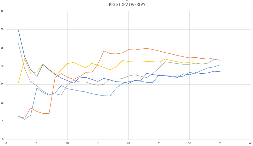

I think he means as a progression through your sample. Like if you stopped at 5 and calculated the SD, then again at 10, and you've already given the final SD of 4.5fps.
And to his point, if a population has a small variance, the ES/SD numbers will generally be small throughout. This works one way and not the other, though.
1 way:
A large sample size (we'll call it a population) has a small ES/SD throughout. Okay, then it stands to reason that a smaller sample of that population will also have small ES/SD.
The other way:
A small sample size has extremely low ES/SD. This does NOT necessarily mean that the population will have a small ES/SD. Just because you roll a die and get 5x 1's in a row does not mean that you will roll a 1 every time, nor even the majority of the time. As we know, a non-loaded die will roll a 1, 16.667% of the time.
To reiterate, however, if you roll a loaded die 1000 times and get 985 1's and 15 2's, it can be expected to roll a bunch of 1's for a sample size of 5.
Hopefully that makes sense. From the graph that I posted, the orange line (23.7gr Varget) had a SD of between 6-7.6 fps for 8 shots. However, over a 35 shot sample it grew to be effectively tied for the worst overall SD of the loads I tested. And in complete transparency, 35 is still a small sample size in the grand scheme of statistical analysis. According to many I know that do such analysis regularly, it's about the bare minimum for most applications to base any sort of judgement on at all.
ETA: to go a little further, it also depends on the variance of the population how many samples are needed to draw conclusions. Populations with low variance (small SD) will show consistent results sooner than those with large variance (high SD). Nonetheless, basing it off of 5-10 samples is still a high risk of getting hosed by an unlucky string of "good" numbers out of a population with high variance. This is where confidence intervals come into play and it's been long enough since I've done one that I'll admit that I don't fully remember how they work. I'm sure Raining or someone else can expand. My understanding is, however, that the more samples you go through and maintain those good numbers, the more confidence you can have that your samples represent the population accurately.

This topic came up in another post in the range reports section. The moral of the story is that if you're using any sort of analysis on a sample size of less than 20-25, you're lying to yourself.
This is .223 data with 5 different charge weights every .2 grains from 23.5-24.3 of Varget. Sorry for not labeling well; it was originally only for personal use. On the left side is SD in fps, on the bottom is the number of samples. It represents a running SD as the number of shots/samples increases over 30-35 rounds.
If you look at the data from 5 shots it's a complete lie. If you look at the data at 10 shots it's a lie. From 20-30 shots you're kinda getting an idea, and IMHO I should have taken this to 50 shots because I think it would tell me that changing charge weight really doesn't change SD appreciably at all.
Most notably, follow the dark blue and orange lines as sample size increases and think about how your perception of a load would be at 5, 10, 15, 20, etc.. shot sample sizes...
Now with that said, most of these ended up hovering around 20fps. Another rifle (6 creed) I shot a 30 shot sample and it was at 12.5fps SD after 30.
From what I have seen so far I would say a TRUE SD of between 10-15fps is excellent. Any 5-10 shot sampling is a waste of your time, other than potentially grabbing a quick average velocity to plug into your calculator. However, even average velocity bounces around and settles out after 20 samples, too.
I always try to explain the underlying statistics to shooters and their eyes roll up into their heads. There is something to be said about a statistically representative sample size.
ES is also a funny topic because you have two data points that you are looking at regardless of the sample size. Not really metric that I would use to draw conclusions about consistency of my ammo
1 way:
The other way:
If I understand this post and one of your previous graphs correctly, you don't believe that the specific load has an effect on the sd. In other words, load X that starts with an SD of 4 for the first 10rnds, and load Z that starts at 20sd will both eventually end up at 25sd if you simply shoot enough rounds?
In the case of that particular rifle with that bullet loaded with Varget from 23.5-24.3gr, it appears that the variance will converge as the sample size increases. It's speculation at this point but yeah, 5x of 35 samples each all kind of point towards charge weight not really playing a part in SD for that particular setup. I have seen other tests conducted by myself and others that were in the 30-50 shot or larger sample size that tested powder charge and seating depth, and everything I've seen points towards the SD's leveling out to within 2-4fps of each other in the long run. I'm not claiming that happens every time-- I'm still looking for the knobs to turn that will make it better or worse. That said, so far I haven't seen anything drastic with switching primers, powder charge, nor seating depth. It could also just be that the factory barrel on that rifle isn't capable of showing me the differences that would be present in a higher quality barrel, chamber, etc...
I intend to do some more testing with that barrel in the future, but I bought that particular rifle just for the action & stock to build a .30 cal subsonic rifle to test out some other theories (a whole different topic) and figured since I didn't care about the .223 barrel I'd shoot a couple hundred rounds to break it in, then test out my curiosity about larg(er) sample sizes with some components that have been sitting on a shelf for quite a while. Anyway, I got my barrel and reamer in for the other project, so I'm going to pursue the subsonic stuff with that action first.
In the mean time I have a couple of 6 & 6.5mm creed barrels that I'm going to do similar testing with (probably 6.5 mostly, for the barrel life aspect). Maybe over the next few weeks as life/weather permits.

ive PM'd Led from seeing this graph in the other thread he mentioned
ive been working on similar data for the past few months with the chrono numbers and on accuracy side of things
its early, but i imagine most would stroke out hearing some the common occurrences we've seen

Ledzep
Chancellor
Belligerents
Jun 9, 2009
2,429
1,508
219
NE
Unfortunately the cone of fire of a rifle is also a normal distribution and is subject to the same issues as muzzle velocity tests.
Edit: But I do agree on letting the paper tell the story, just with a larger sample size.
That's the biggest missing piece of my data collection so far. By plugging 30 rounds into 1 group all I see is the outside edge, which doesn't show the story well. I have a 1.2" group that looks more scattered than a 1.6" group because of 2-3 shots that went way out. I think from now on I'll be shooting multiple 5-shot groups and find a way to compile them to get the radius of each shot from the composite group center.
yay ballistic x
Yea, for close range you will need to get creative or get one of those fancy electronic targets.
