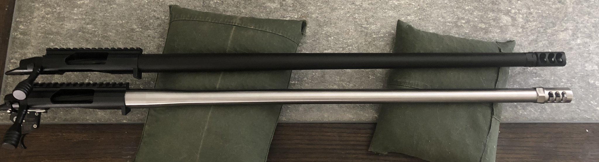

I’m not sure if it would qualify as a “trainer,” but I use my .223 setup to save a couple extra barrels a year with my 6creed. I think it also helps with my wind calls, so I guess there’s the trainer part.
Any matches that are around 800 max or only one stage over 800, I shoot .223.
A 100 round match eats up about 7% ish barrel life of a 6 creed (1500 assumed life), and .223 eats 2% barrel life (with assumed 5000.
Mileage may vary, but even if the ammo costs were the same, it’s still worth it to me to shoot 223 as much as possible.
I have them set up almost exactly in weight.

Do you change scopes and triggers when you switch? Also looks like you are running Impacts? I just ordered mine and cant wait to shoot it!
I do for now until I can budget in another kahles and trigger. But it’s so easy to change them, it’s not a big deal.
They are impact actions. I love them. Only other action I’d use now is an AI.

Yeah scopes are expensive as are actions! Do you reload for your 223 or just by factory? Have you ever just swapped barrels out?
I’m running factory at the moment, building a loading bench. Just waiting for Black Friday for a few more items.
I switched out barrels on other actions. This time I just got tired of doing that and bought 2 impacts. I only shoot two calibers and almost never in the same day.
What ammo are you running in both? Yeah I wouldn't be switching barrels the same day either.
