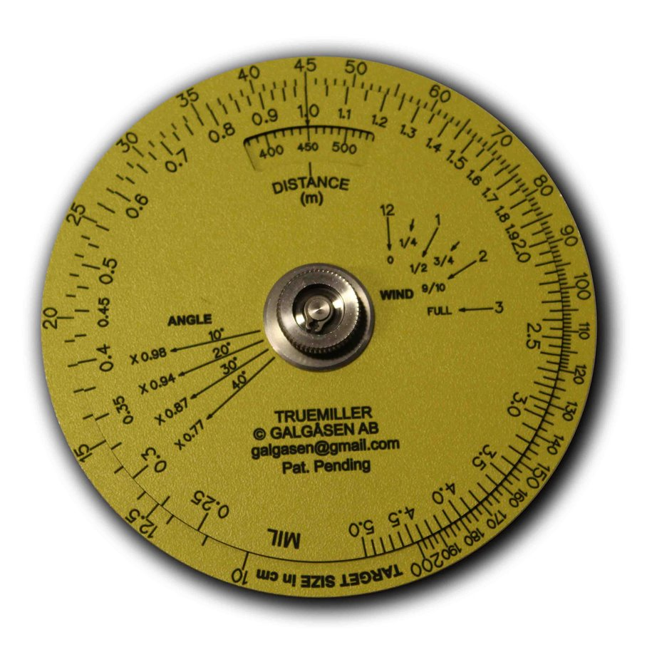

We usually have rules that make rangefinders obsolete and pretty much all digital tools are prohibited. In the Nationals you can be DQ:ed for using your cellphone.
So, before you even go to a competition you need to have printed range cards for both distance and wind drift. Almost everyone uses a "True Miller" which is like a mil-dot master but better.
7094886
So, on stages where the distance is not known (most of them). What we do know is the target size, so I do it like this:
Lets say the target is 45cm tall. Then I set the outer disc on the true miller as pictured. When I get the command "Measure target" I get behind the rifle, dial out parallax and measure the height of the target with the fine graded scale on the lower left half of my MSR reticle. Lets say I measure it to be 0.9 MIL. I then spin the outer disc to match that number, which gives me the distance. I then check my rangecard and dial the scope accordingly. Before I even lay down I have done my wind estimation and try to read the terrain, combined I have my firing solution and when the command "FIRE!" is given, Ill shoot my 6 shots (on a regular stage) and that is pretty much it. After the results of that stage is given, we move on to the next one and do it all over again.
With normal rules we have 2 minutes to measure the target or targets, as I described above. Which is plenty of time when you have your shit down and feel confident in your equipment. When you are new to this and still working on getting shit in order, those 2 minutes fly by. There are stages with 2 targets, which cuts your measuring time in half, so to speak. But its a good challange to see if you have good routines.
