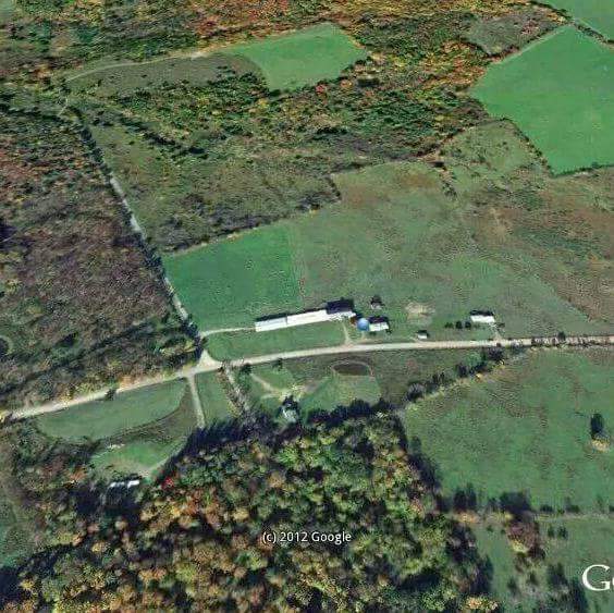

Have a local LR match run on a family farm that has increased in range over the past few years from 1,000yds to just under 1,200yds.
This past year they started playing around with overhead imagery of their property and doing some ground surveys and have laid out and cleared a path for a one mile shoot. Plan is to have a check target around 1,000yds and then one at 1,760yds.

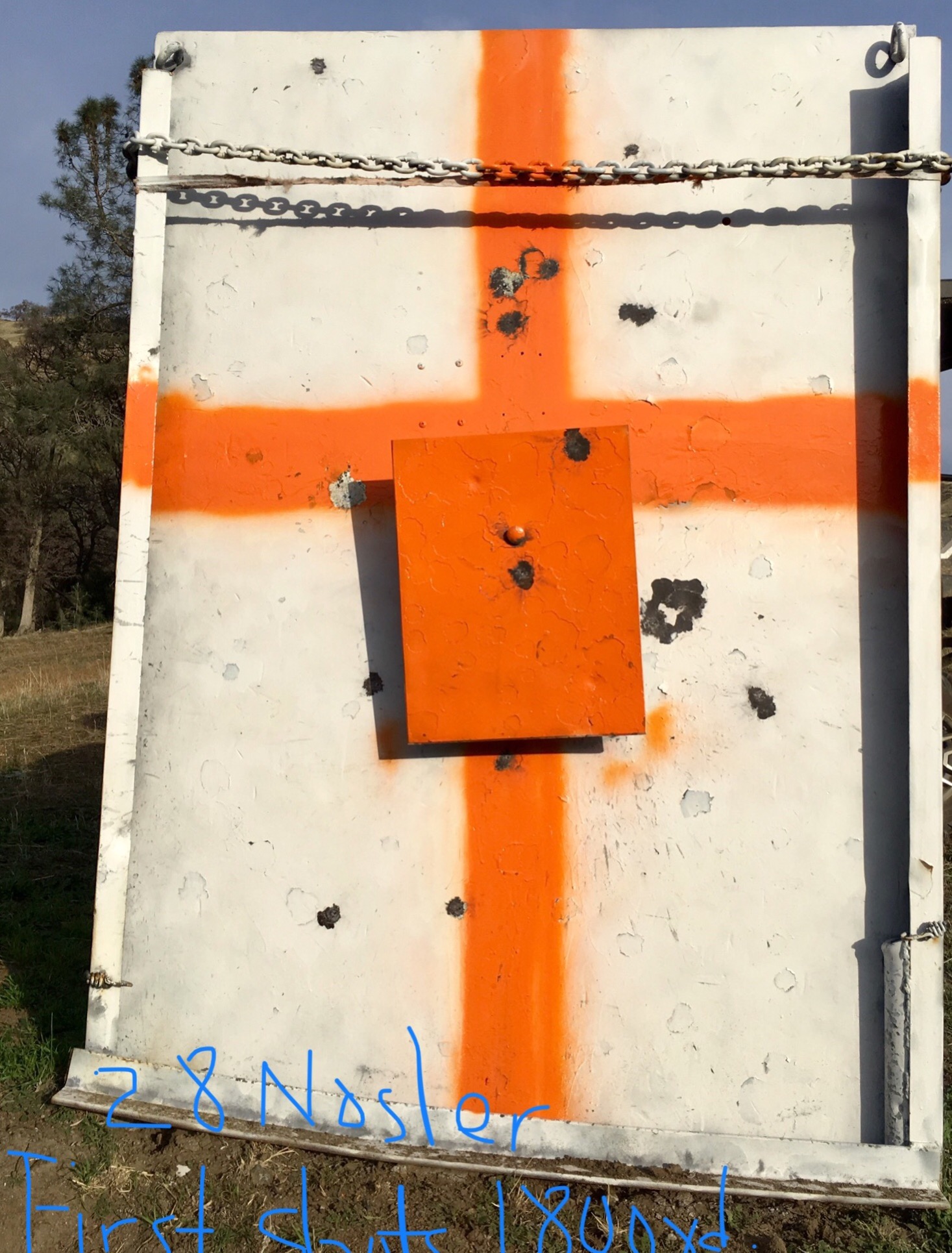

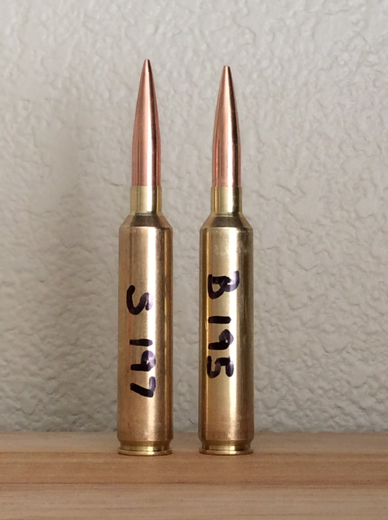

Of all the choices mentioned above, I can say the 28 Nosler shooting a Berger 195 @ ~3180 fps
does a real nice job @ 1mi.
It’s downside would be brass price & availability. I know everyone assumes barrel life will
be short & I’m expecting it. So what, when it goes I’ll get another one.
Single shot = no mag restrictions. Freebore on mine is .270”, I know others are at .300-.310”
to seat the Berger 195’s & Sierra 197’s way out there.
My buddy next to me was shooting a .338 LM. He was impressed with the accuracy & how
quickly (relatively speaking) the bullets reached the target vs. his 300 gr. / .338’s
The target is about 3.5’ wide X 5’ tall. Plate in the middle is about 12”w X 18”t.

Nosler case, CCI 250 primer, Berger 195, 84.9 gr RL33 powder is what I was shooting that day.
I’ve taken it to 86 gr. & 3225-ish FPS with no ejector mark or swiping.
Wasn’t sure how much the bullets could handle so, just went mild on the load that day. ~52 MOA up from 100 yard zero to the target which is actually at 1807 yards.
Loaded to just touch the lands. Still need to do seating depth/accuracy testing & tuning. Looking forward to trying
the Sierra 197 too.
