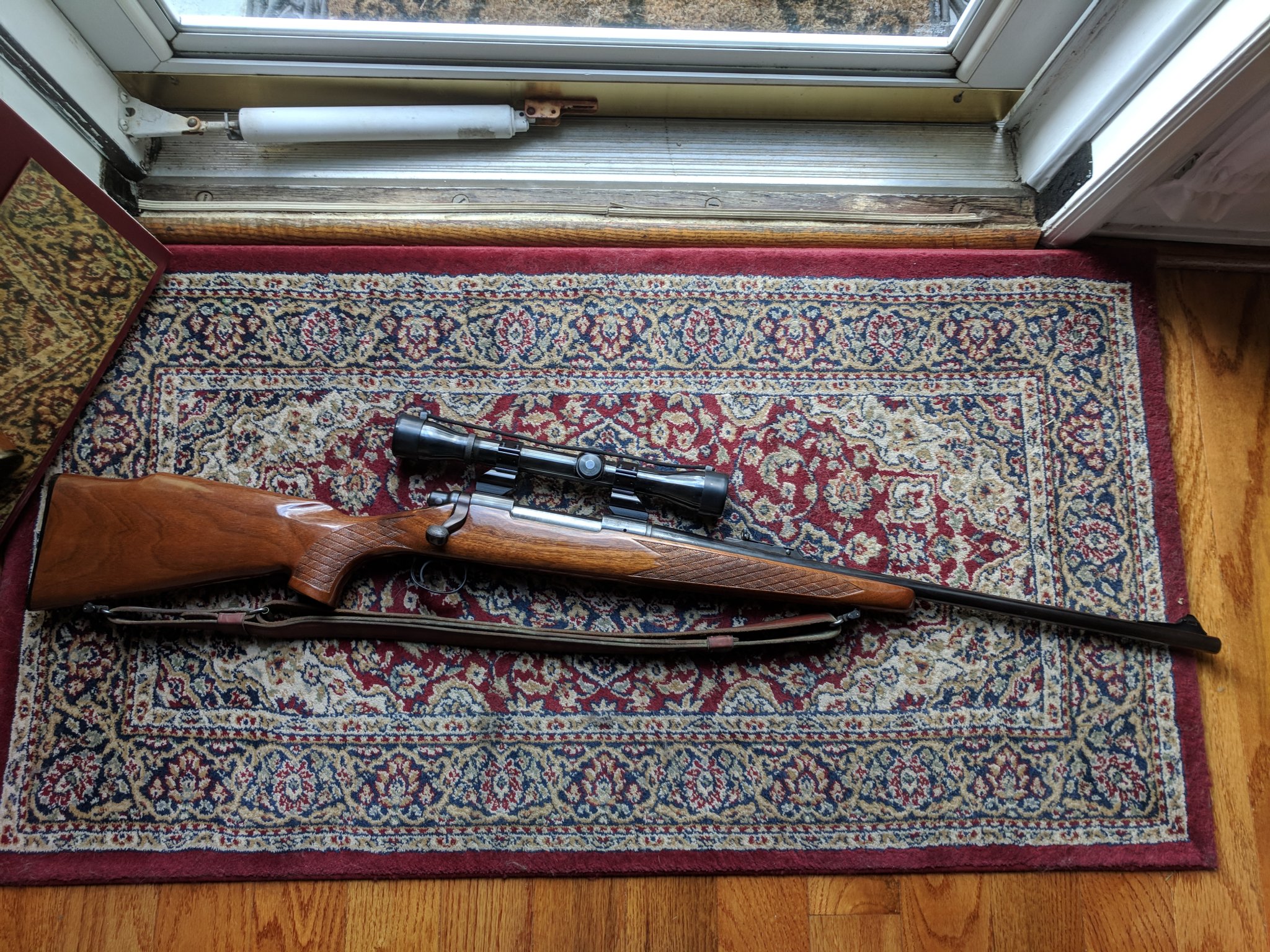

#26
The rifle is in pretty good shape. I plan on keeping the original barrel and stock if I ever wanted to put it back. I looked up the date code, it's a 1970 model. Is there much I can do about the wood stock, it is not helping things. I've seen the zero move with temp change.
Here's a photo, it's wearing a different scope and rings currently
spife7980
Feb 10, 2017
3,506
576
113
TX
#27
Sand out the barrel channel so that it free floats and pillar bed it. Your wandering zero issues will disappear.
If you want to save the barrel to put it back on later to bring it back original then dont true the action.
I actually like the wood stocks, they are just classy.
I didnt want to adulterate my first rifle too much either so I just had a new barrel spun up at pacnor and made the wood work for me, a bit of sanding, some pillars and a little devcon. This is my dads used-to-be-matching rifle next to mine. Shoots great and has gotten me a coyote out past 500 yards. Used to never imagine it being accurate enough for that in its original form and I can still go and put my original barrel back on if I felt the need.
Bradu
Aug 24, 2011
1,744
142
63
IL
#28
If you want to possibly reuse the factory barrel then don't have the action trued. The threads will be opened upon the action and will be too big for the factory barrel.
