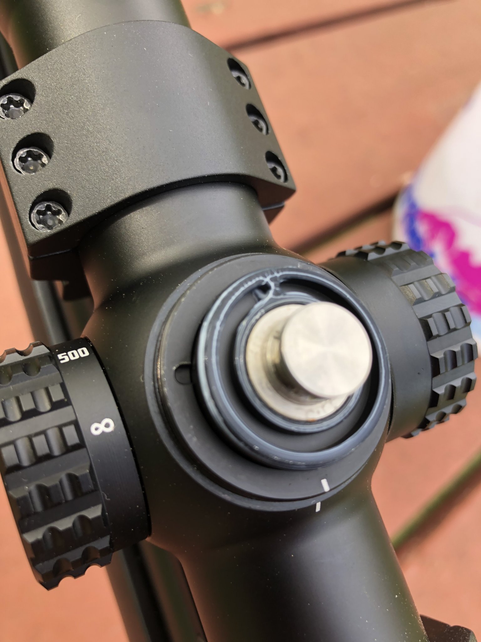

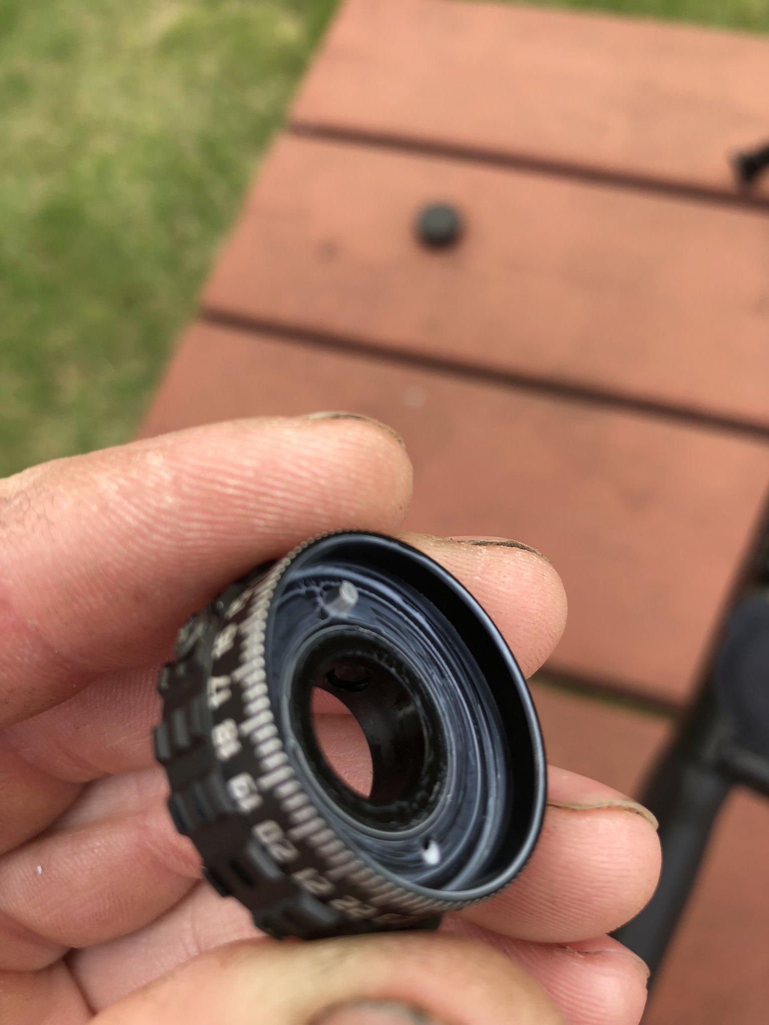

So I tinkered a bit this morning. I took off the elevation turret to see what it looked like in there. I saw how I was hard against the stop, but I could go past the stop and continue to dial down. So I dialed down till I got a 50yd zero. This isn’t on paper, it’s on a small Cabela’s steel spinner. I zeroed the turret and dialed up as much as I could. I should have about 23 3/4moa left with a 50yd zero. I’m pleased I now can actually dial to a 50yd zero. F7621B2D-DB36-43C9-9B45-D20333288941.jpeg53629AF6-400C-4131-B1BC-1A9104007014.jpeg
