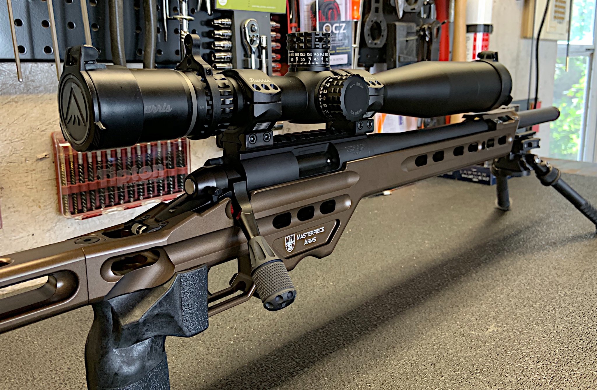

Now If I can just get my Masterpiece arms 6.5 creedmor to shoot. Best I can do with it is .60" and they guarantee 3/8". It's been a struggle and Ive been scratching my head. Starting to get frustrated with it.

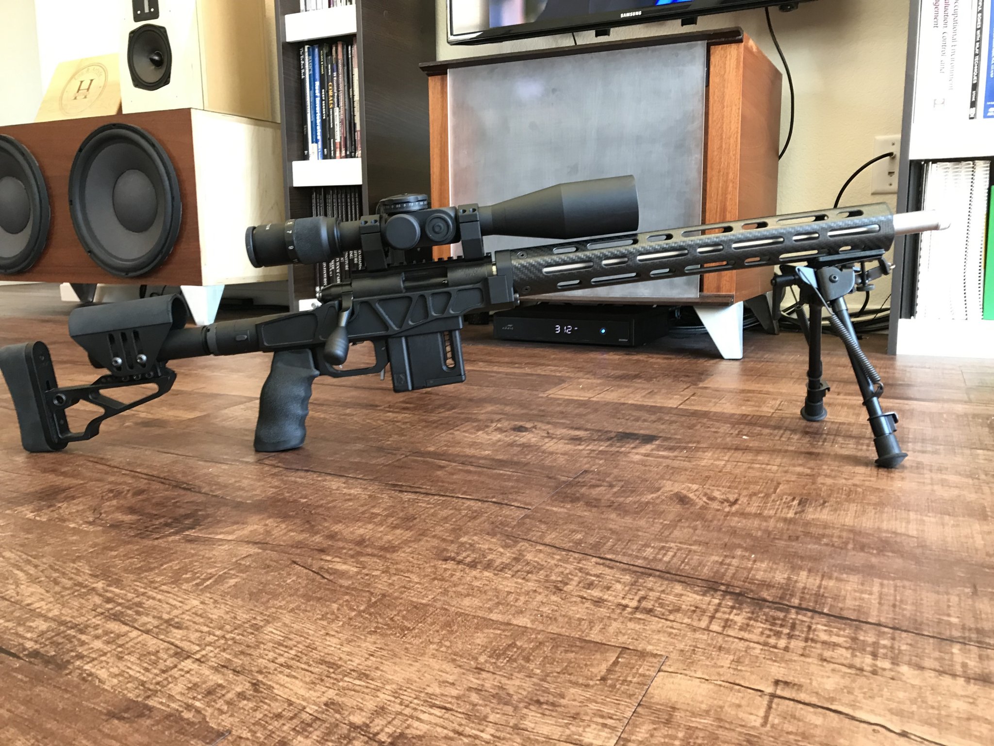

Here's my baby. I'm proud of this rig. I absolutely love it!
Vudoo V-22 with a Bartlein Barrel, MTU contour at 20"
XLR Carbon Chassis with a folding stock
USO LR-17 optic in Vortex rings
Jewel Trigger
Harris bipod
I stole all the parts from my .223 rig. Now all that I need is a can.
This rig will see considerably more range time. I just bought a KYL rack for it; 2"-1/4" plates in 1/4" increments. Me and my son plan on doing some shooting with it this weekend. I can't wait! The Vudoo is already my favorite rifle, and I've only had it out once to sight in the scope and shoot some steel. My wife, who had only shot a rifle once before in her life, was 5 for 5 on empty shotgun shells set up at 50 yards shooting bulk ammo. It is boringly accurate at 50. ;)

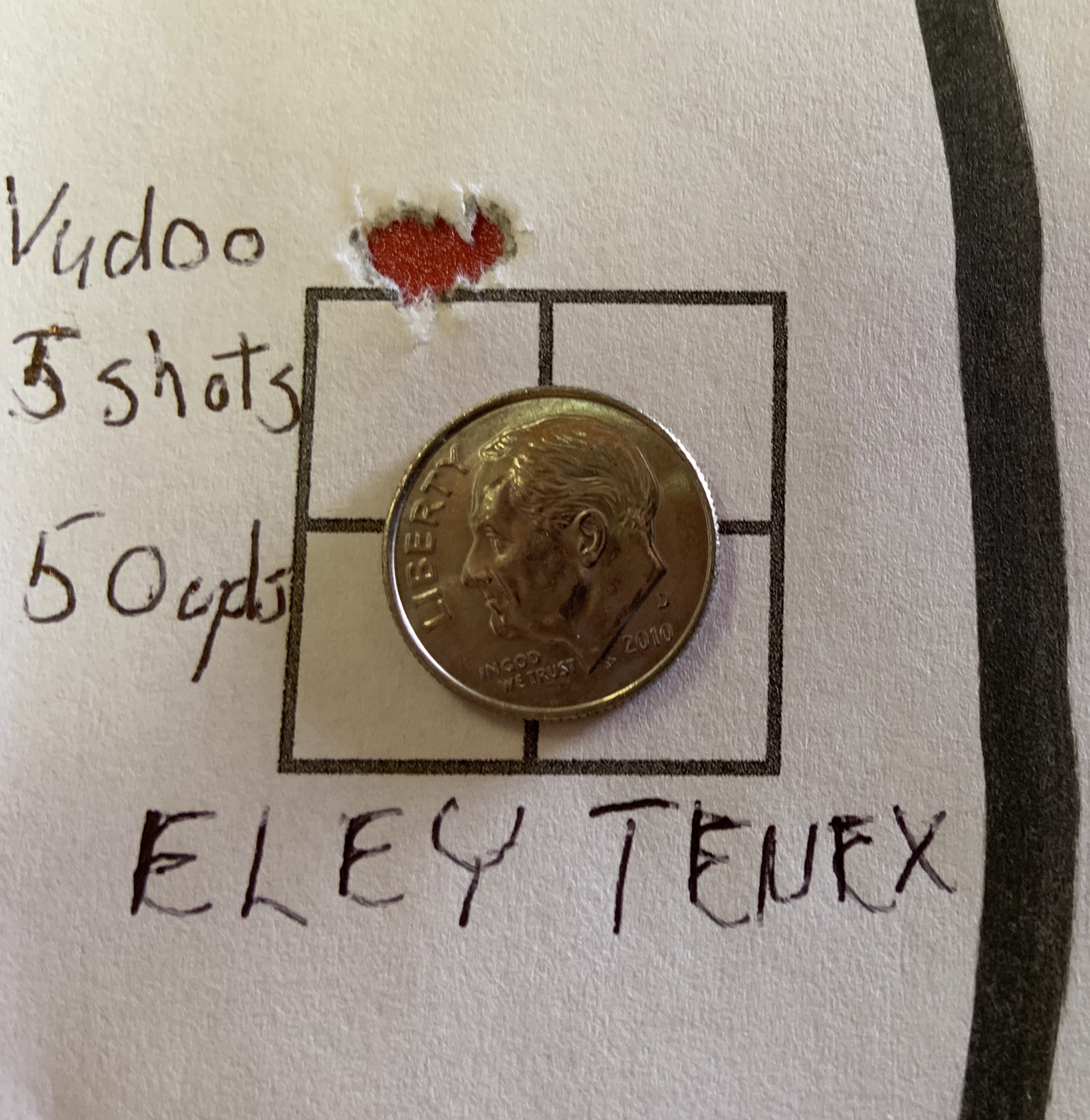

Received my V-22 XLR Element on July 26 and finally made it to the range today. First group of five shots at 50 yards measured .315" center to center (CTC), second group .285", etc. to tenth group of .275" (see attached). The average for the ten groups was .429" CTC (shooter error on two groups increased the average). Wind was 0-5 mph, humidity 71%, temp 84° to 91°, ammo SKS+. Vudoo is definitely a lot more accurate than the shooter. The only other .22LR that i have owned was a semi-auto about 40-45 years ago.
Reactions: rizzle and RAVAGE88
RDS51
Jul 15, 2019
11
6
6
Waco, TX
Did you guys shoot more groups than just those two?
I shot 10 groups of 5 each. All were similar to the first and last groups shown except for two bad groups that expanded the average of the 10 groups to .429". These were the first 50 shots out of this gun.

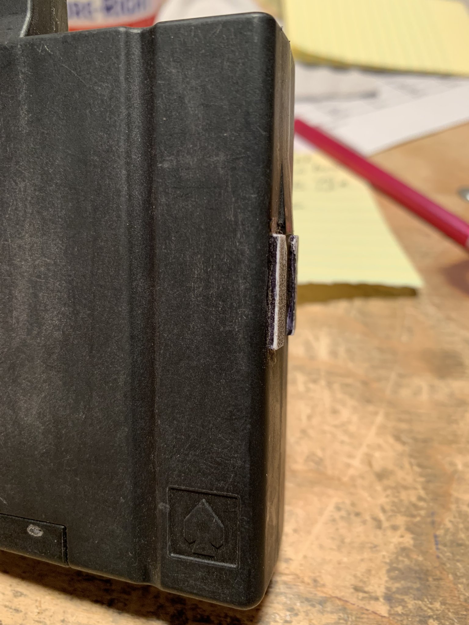

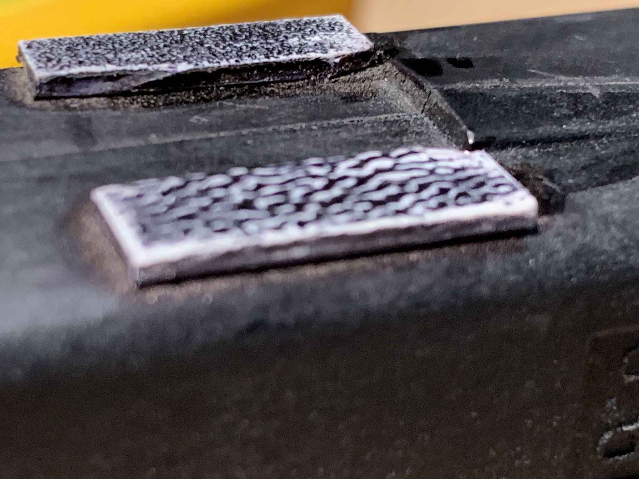

Ive heard it needed to modified mag catch lever? I wanted to try orange mpa for thisView attachment 7135286

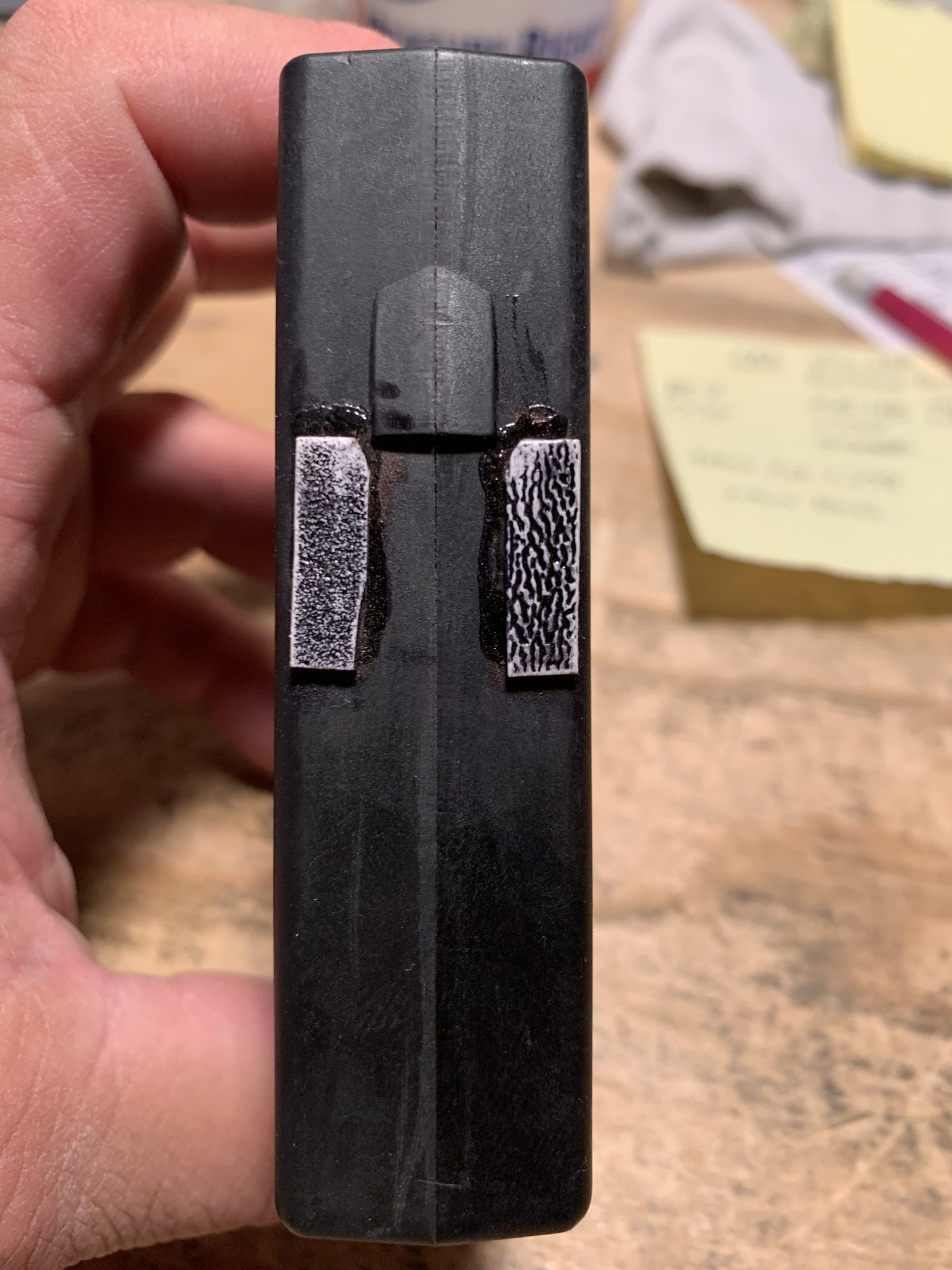

I have a vudoo in an MPA and the mags go in and hold fine...I had issues when leaning the mag into a prop...the mag tilted back toward the butt and rounds would nose dive.
I took plastic wall panel material I got at Lowe’s cut small strips and glued to the back of the mag and that fixed it.
