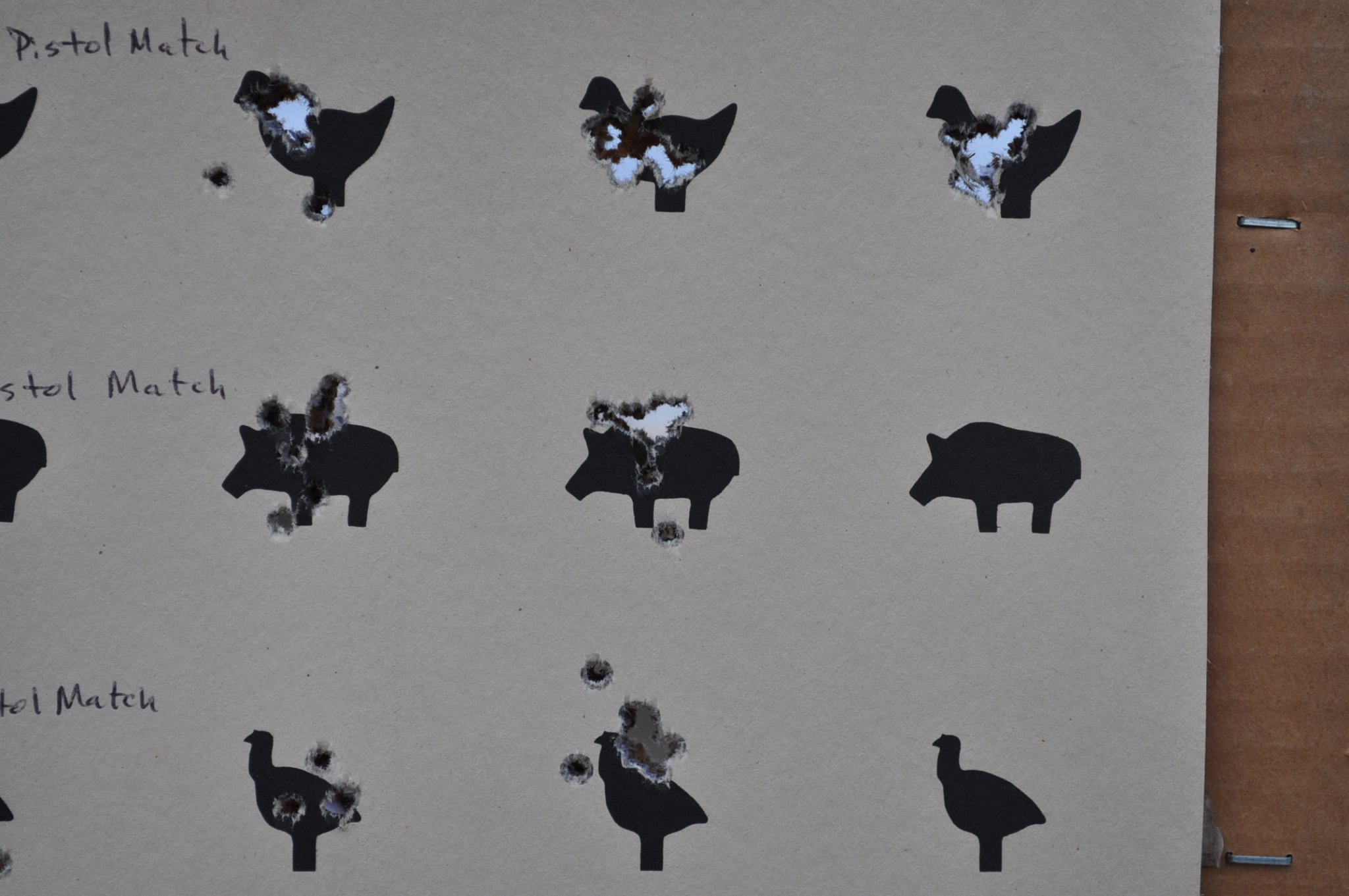

I believe someone in this thread asked me how well my V-22 ACE Ranch bbl'd action shoots a week or so ago, and at that time, I'd just begun shooting with it, and thought it wasn't quite as accurate as the V-22 Bartlein Kukri I'd ordered at the same time as the Ranch. Well, I'd had just about all this sitting around, cooped-up due to cold weather I could take, so I picked up the Ranch V-22 & several boxes of ammo this afternoon and went out to put a few more rounds through the little lightweight rifle. Didn't feel like robbing a bipod off one of the heavier V-22s or 40Xs, so picked up a Doggone Good Bag on the way out of the house, and shot off it instead of a bipod. It was only 30*F outside, so I didn't waste a lot of time shooting the 10-shot groups, but trigger finger was still pretty numb by the time I'd finished loading & firing the 60rds. Only took one mag out, so couldn't pre-load them in the warmth of the truck before getting out to shoot at 50yds.
From top left chicken: SK Std+, Lapua Center-X, another lot of Center-X. On the pigs: Lapua Polar Biathlon, another lot of Polar Biathlon, and on the middle turkey, Federal UM-22. The two shots out of the group on the 1st chicken were the first two shots out of a cold, clean bore. The 1st lot of Center-X was a random lot I'd tested in the 40Xs that didn't shoot good enough to warrant purchase in quantity, while the 2nd group was with some Center-X that I'd bought a half-case of. The 1st Polar Biathlon pig was with a lot# that I bought 4 bricks of, while the 2nd one was shot with a lot# that Grafs had only six boxes of - piss poor luck to spend that much on almost a half-case of the poorer lot & only get 6 boxes of the better one...and I could easily hear the softer report of the slow rounds of that first lot, relative to the louder pop of the faster ones, even with the TBAC 22TD suppressor on the rifle. The 2nd lot had a more uniform report for all 10rds, even though it looks to me as though there are 2rds between & below the pig's feet. I'd bought three different lots of the Federal from Midway a couple of years ago - not on purpose, that's what they sent to fill an order for 20 boxes. This is the best results I've ever had with any of that Federal, after trying it in both 40Xs & my original V-22/Krieger. Looks good enough to warrant further shooting in the Ranch, and perhaps the Kukri's Bartlein as well. Sitting here with a hot cup of tea, I'm glad I was able to get out and shoot a bit, instead of just sitting here in front of the computer, reading about all you other Hide members' shooting your V-22s...DSC_1175.JPG
From top left chicken: SK Std+, Lapua Center-X, another lot of Center-X. On the pigs: Lapua Polar Biathlon, another lot of Polar Biathlon, and on the middle turkey, Federal UM-22. The two shots out of the group on the 1st chicken were the first two shots out of a cold, clean bore. The 1st lot of Center-X was a random lot I'd tested in the 40Xs that didn't shoot good enough to warrant purchase in quantity, while the 2nd group was with some Center-X that I'd bought a half-case of. The 1st Polar Biathlon pig was with a lot# that I bought 4 bricks of, while the 2nd one was shot with a lot# that Grafs had only six boxes of - piss poor luck to spend that much on almost a half-case of the poorer lot & only get 6 boxes of the better one...and I could easily hear the softer report of the slow rounds of that first lot, relative to the louder pop of the faster ones, even with the TBAC 22TD suppressor on the rifle. The 2nd lot had a more uniform report for all 10rds, even though it looks to me as though there are 2rds between & below the pig's feet. I'd bought three different lots of the Federal from Midway a couple of years ago - not on purpose, that's what they sent to fill an order for 20 boxes. This is the best results I've ever had with any of that Federal, after trying it in both 40Xs & my original V-22/Krieger. Looks good enough to warrant further shooting in the Ranch, and perhaps the Kukri's Bartlein as well. Sitting here with a hot cup of tea, I'm glad I was able to get out and shoot a bit, instead of just sitting here in front of the computer, reading about all you other Hide members' shooting your V-22s...View attachment 6981862
Flatlander:
What are the size of the critters?
What are the components of your V-22 Ranch rig and what does it weight? Hopefully 7.0 to 8.0 lbs.

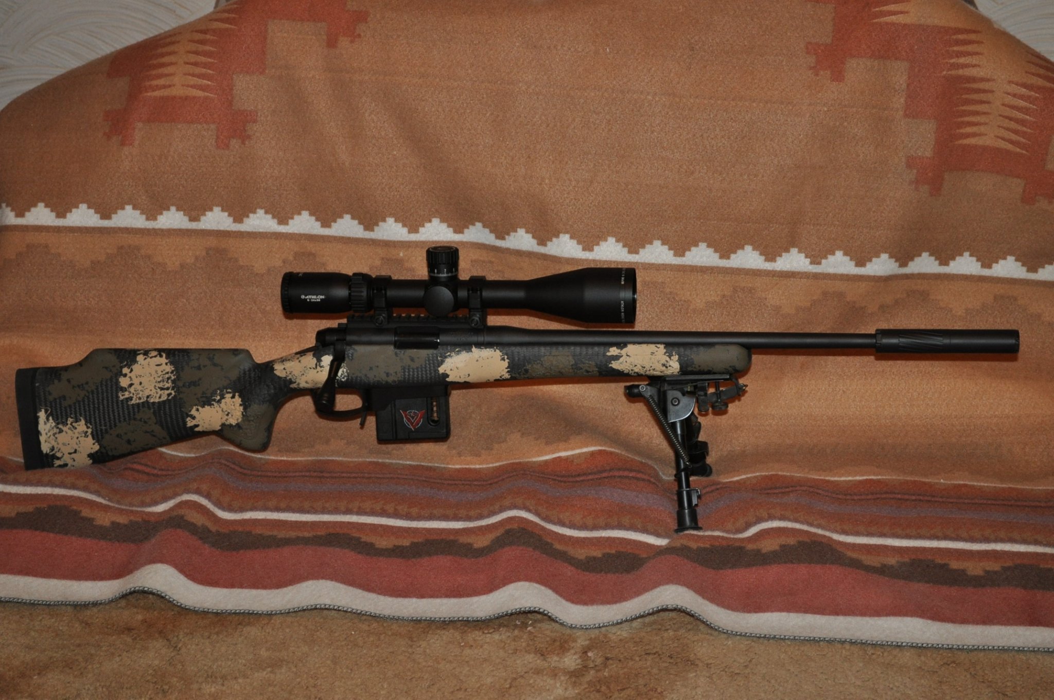

Rick - Size varies, but the chickens are about 1" x 1". None of them present as precise an aiming point as some other targets unless you're going to hold on the head, or a foot, or...you get the idea. I was holding center mass, or trying to.
The Ranch V-22 has an ACE 18" bbl, Manners EH2 stock, PTG Stealth DBM, TT Diamond trigger, 30 MOA rail, and Athlon Midas TAC 6-24x50 scope in TPS TSR low rings. Weight with an empty mag, w/o bipod & 22TD suppressor as shown in the attached photo is 8.75lbs.
Thanks Flatland for the info, that set-up is 1/4lb heavy over the 8.5lb limit for NRA Silhouette hunter class. I could probably get a 16.5" barrel and/or different rings/optic and make weight. Couple of questions:
Is the manners eh2 stock made of carbon fiber?
What is your zero distance with the 30 MOA rail? If 50yd, how much elevation do you have left to dial?
I'm kicking around the idea of building a ranch barreled vudoo action build for that game with an old 1980's SA remington ADL factory wood stock for a cross-over retro look-a-like but keeping it under 8.5lbs all kitted with a empty mag inserted is the challenge.

Tiger - Yes, all the Manners Elite series stocks have a carbon fiber shell; they advertise a finished weight of 25-26oz with a 1/2" pad, but mine has a 1" pad, so may be a tad heavier. I haven't bedded this stock, only glued in aluminum pillars. I kind of doubt you'll have much luck getting a Rem ADL walnut stock to come in lighter than the EH2, but not having a wood ADL stock to weigh, I could be wrong.
I zero all my precision 22RF bolt rifles at 50yds, this one's no exception. There's 18.5 mils of elevation left on the Midas TAC 6-24x50 with that zero. IIRC, the Athlon website shows this scope weighs 27oz.
The V-22 action just wasn't designed with weight savings in mind I guess - it's a pretty substantial chunk of steel, designed with accuracy as a priority.

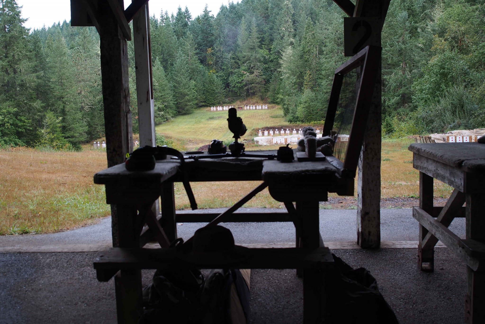

Since the 7 day schedule is for rain, despite the temp I had to go test Wolf Match Extra and SK Pistol Match and my Atlas Bipod vs Harris Bipod just for kicks.
Ambient temp was 39*, real feel on the fingers was worse, even occasionally using hand warmers in the pockets.
What the digits looked like after I got home 20 minutes later..... no, the yellow fingers aren't normal. :(
First row is Wolf Match extra Altas bipod, second is with Harris. 3rd is SK Pistol Match with Harris, 4th is with the Atlas.
Remaining rows are SK Pistol Match with the Atlas. Appears the 18" Ace barrel likes Pistol Match despite a few bad set-ups and pulls on my part.
Distance was 50yds, overcast with some ground fog and next to no wind.
Again...... this Vudoo rifle is such a pleasure to shoot. (y)
Now if it just had a heated stock! :)

Outer is 1". Started at top left and finished with the "sighters", Center POA, no scope adjustments, rows 2 & 3 used a different bipod, rows 1-4 bipods legs were on the painted plywood benchtop, on the remaining rows the bipod legs were on carpet.
IMO some of the variable impact is on me influencing the rifle. Grip position and pressure, trigger pull angle and follow through, shoulder pressure, and head position. Some of it is shooting over the top of different bullet lube. Some is bipod leg position being neutral, forward loaded, or torsional influence along with torsional influence that can be applied with the rear bag.
.22lr is sensitive and thus easy for the shooter to negatively influence. To me it's very similar to golf, doing it well is not simple. Posture, position, muscle control, grip position/pressure, tension, mental imagining, and more all influence the shot. There's mechanical fixtures to test firearms and ammo, and robots to test golf club and ball performance. To do your best in competition you have to clear your head of mechanics involved in training/practice and focus on your target/objective...… and accept that some days will be better than other. ;)
