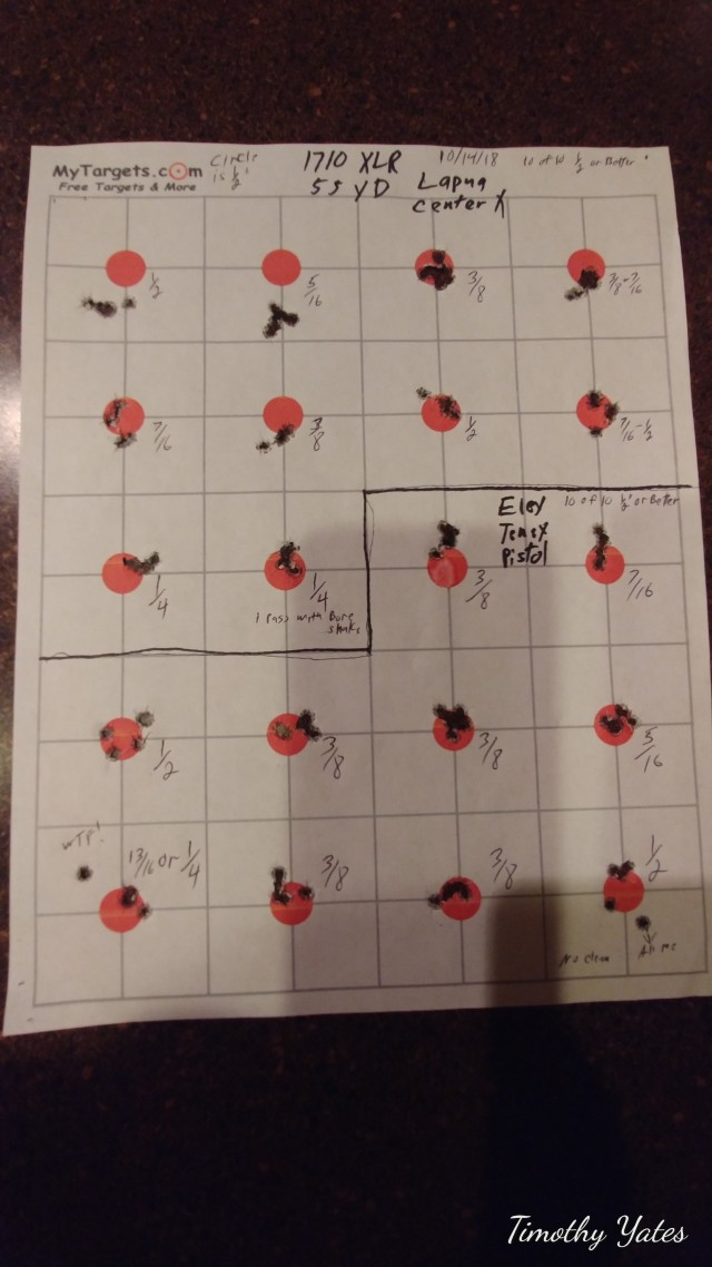

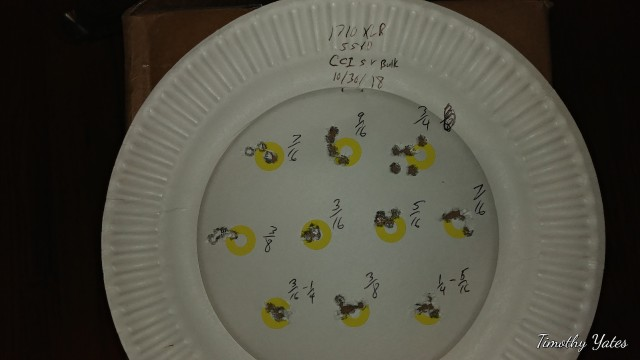

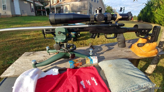

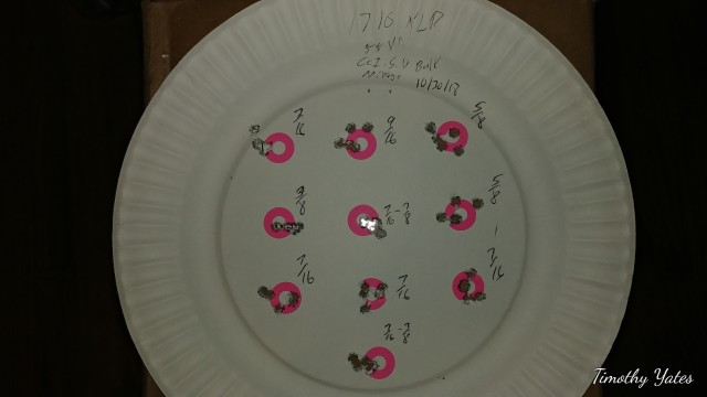

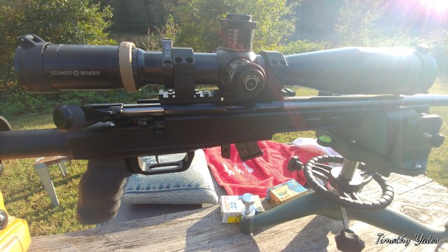

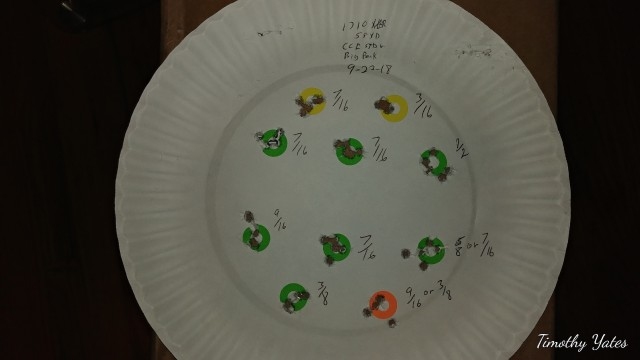

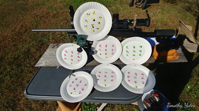

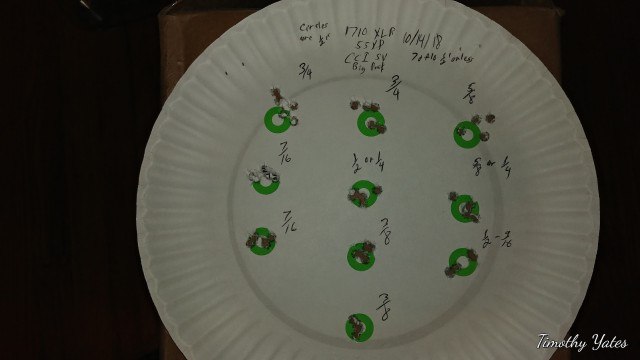

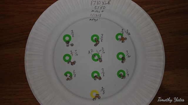

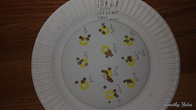

Check out this price per round performance. This is $2.00 a box CCI SV. Shot on multiple days .
1541465977361.png1541465998469.png1541466015525.png1541466024188.png1541466068529.png
If money was no object I would shoot this all the time for its consistency.
Over the past weekend I did a 5 Lot test with Center-X which is all the red dot targets. The green dot target is the Midas + above. The yellow dot target is CCI SV Case ammo that I have about 12,000 rounds left.
Shot with this Anschutz 1710 XLR. Sorry Vudoo guys for crashing your thread. :ROFLMAO: :coffee:
View attachment 6966371View attachment 6966372View attachment 6966373View attachment 6966374View attachment 6966376
Shot with this Anschutz 1710 XLR. Sorry Vudoo guys for crashing your thread. :ROFLMAO::coffee:
View attachment 6966383View attachment 6966384
Lol most Everyone I saw, Including myself, shot their Vudoos like that off a bipod, not a benchrest! ;) Kidding aside, no drought Anschutz have been the gold standard pure 22 precision.
Just incase you missed it, these are not just about the groups they produce; but the fact that we can run our same exact centerfire trigger, stock/chassis setup or even interchange them.. Havening the AICS style mags also inserts very fast and stows in our normal mag belt pouches..
I don't think it is capping on the thread, just completely missing the true VALUE of the V22s

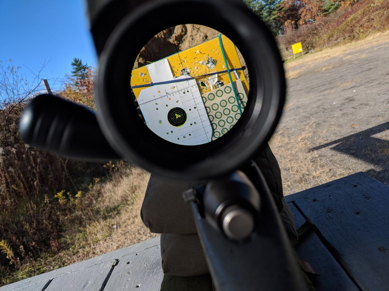

FWIW - I did a quick 200yd ammo test today. 20 rnds each brand, no cleaning between brands, kept the times at 10-15 minutes per 20 rnds. Dealt with some mirage, shot through most of it unless it was a major boil. Got tricked a few times and made 5-8 questionable pulls.
I was shooting to somewhat replicate our 100/200yd matches that are 10 minutes for 10 rounds, unlimited sighters, two targets at 100, two and 200. I wanted to see what my average groups might look like with each brand.
Left to right, top to bottom: SK Rifle Match, SK Pistol Match, Center-X, RWS R50, and Tenex.
Ideally additional fouling rounds would have probably tightened all the groups, on the Center-X group (top right) I made a couple of questionable shots considering mirage and wind conditions. Didn't have flags out to verify, just seat of the pants. This range has tricky swirling wind conditions that will make you crazy at times.
Happy to say the most expensive ammo wasn't the best performer....... today. ;)

That Center-X and R50 looks pretty good. How big is the center red bullseye?
Bull is 2". The Center-X looks real good if I was responsible for 3 or 4 of the extreme shots. For the price the SK Pistol has potential, though my rifle shoots CCI SV close to that.

Most interesting results. I presume the POA was center of bullseye in all cases. What strikes me is not only the differences in precision but the differences in the offset of the group centers from POA for different ammunition. Any thoughts on relative importance of mirage, wind, muzzle velocity and BC ?

POA is center of the dots I wrote POA on. The last smaller target when shooting Tenex I used the lower dot.
I forgot to add that I did a 1 moa right windage correction after shooting the first two targets. :(
Elevation setting didn't vary. Rifle is zero'd at 50, +6 moa for 100, +24 for 200. I shot a 100 yd target after the first two 200 targets.
Reading mirage is a challenge though it effects rimfire and centerfire the same. Wind can be anticipated with flags and effects rimfire much more than centerfire. Extreme spreads in muzzle velocity are what justify $20+ a box for .22lr. BC doesn't vary dramatically between most decent target ammunition.

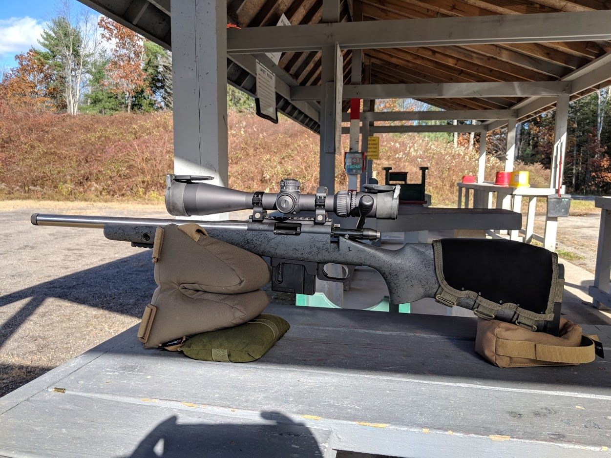

This Vudoo has become my favorite rifle, for so many reasons. Finally snuck out today to run a few types of ammo to check zero-shift.
Windy day, but some fun at 50yds and needed buniges to hold the targets on.
Rifle likes SK rifle match, Norma Tac, and R50 rifle match, but probably gonna stick with SK as it seems less overlubed.
Really hoping that NRL22 ramps up in ME soon!

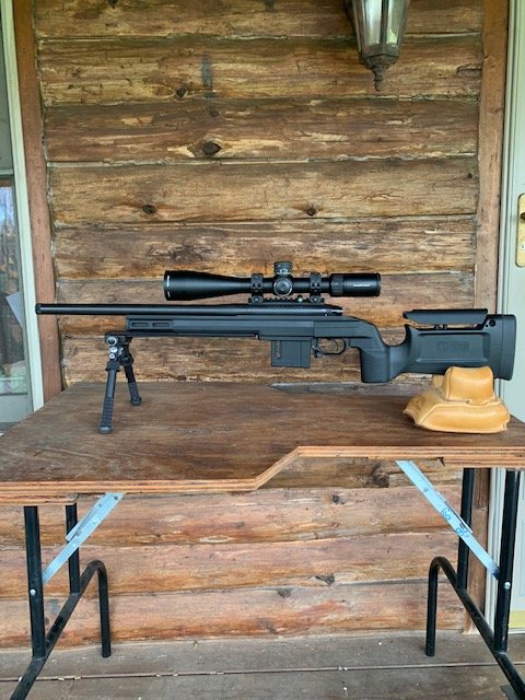

Received my V22 yesterday and mounted it into my MPA BA with a Timney CE (straight). I’m building this rifle as a practice tool to simulate PRS work. Zeroed at 40 yards (apex) with CCI 40gr Standard Velocity (1070 FPS) Round Nose today.
The resultant groups are amazing. I am super happy with fit, finish, and function.
It is money well spent ... if you’re on the fence I suggest you get yours on order.
As an added bonus it arrived 2 weeks earlier than estimated and Jill is a pleasure to work with.
Excellent work Vudoo Gun Works ... A+++
Like that stock and color,Is that the greyboe terrane? How do you like that stock.
