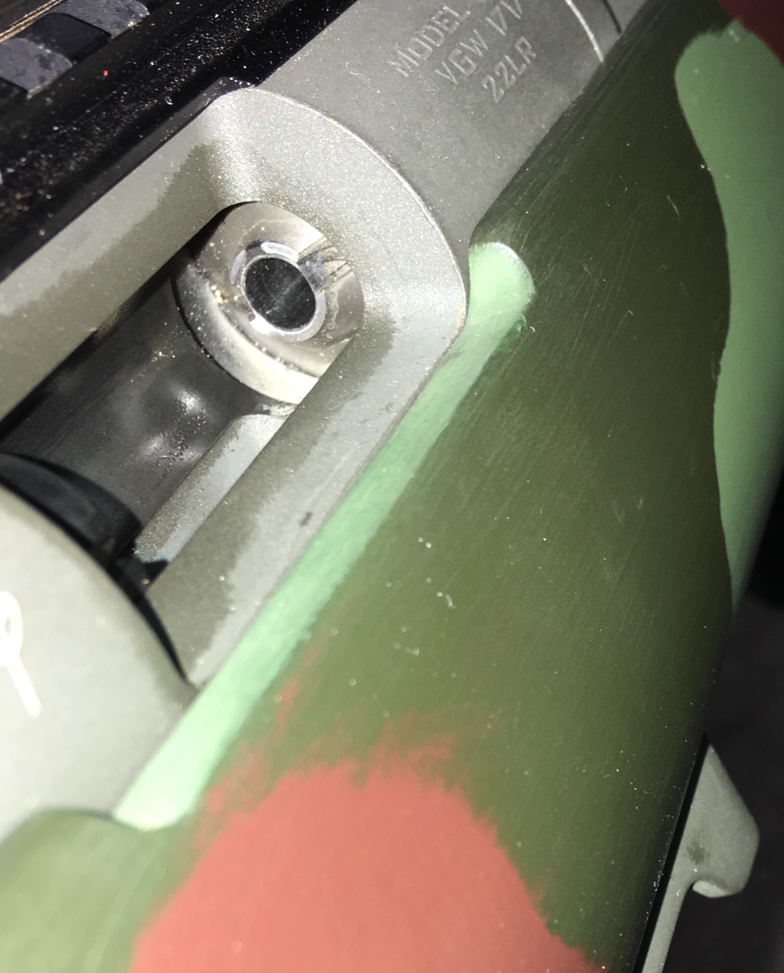

RAVAGE88:
For the great unwashed like myself, would you please explain why the hybrid cone breech barrel is superior to the flat breech barrel. How much does it increase the accuracy if, in fact, its purpose is to increase accuracy.
Rick,
The Hybrid Cone does nothing more than provide space for the crud. Most, these days, are shooting suppressed, A LOT, and the 22LR suppressors have their own little internal weather system. The environment within is of very little heat, so condensed air (rich in vapor) is much higher than centerfire, where heat is much greater. The benefit of the heat is it burns off the byproducts more efficiently, but in the rimfire suppressor, the byproducts remain and build up as loose particles. When the rifle is carried muzzle up or stored in vertical racks at the range, the excess crud falls down the bore and collects at the front of the bolt.
Basically, I'm not a fan of the coned breech because they're fragile, so we have what I term as a Hybrid Cone (it still has extractor cuts). The Hybrid Cone provides more material around the case head and allows the rifle to remain dry-fire safe. It does not increase (or decrease) accuracy. The tolerancing is unchanged between the bolt and breech.
Not all rimfire suppressors exhibit the crud issue, so not everyone will (or has) experienced the crud problem, resulting in harder-to-close-than-normal-bolt-operation.
I created the Hybrid Cone shortly after introducing the V-22 and beat the crap out of it for just over a year to test and evaluate. It's perfect for dirtier environments and running suppressed. Nothing at all wrong with the flat breech, but it doesn't appear to like most rimfire suppressors.
Thanks for the question....hope this helps.

RAVAGE88:
It's more for trash handling. The bolt face and bolt have very close fitment. So any grit, carbon, crap, dirt will contribute to the bolt not closing like it should.
Mine has remained smooth, I clean the bolt and breech face after each shooting session. The real test will be the west Texas varmint trip, which you may as well bury your rifle in sand when you get there as it will be full of sand quickly. Ammo selection sucks for those trips as you can't run wet lubricated bullets.
I'm going to wait until I get some time with the Dead Air mask and one of my own mono core cans before I look into changing the breech on mine.

First let me say I absolutely love this rifle but read below.
I purchased a V-22 about 1 month ago and it has just started shooting poorly with SK Pistol Match. I have about 2 bricks of ammunition through it: SK Pistol Match, R-50. Federal Ultra Match, and Eley Match. Before the last 2 trips to the range it shot in the .2's and .3's at 50 yards. I found yesterday that after pulling a cleaning patch through the barrel, the accuracy returned to normal for two five shot groups then ceased to be accurate again - same box of ammo. It has cooled off about 15 Degrees during these last range trips.
Yesterday I used a brush to clean for the first time and then bore scoped it and found a few 45 Degree angled scratches about 6 inches into the barrel from the breach (cannot fathom how they got there) and the barrel was not as well finished internally as I expected it to be with the Bartlein barrel after only about 1000 rounds. To the Range tomorrow to see if this cleaning helped.
It was completely built by Vudoo and is in an MPA Competition stock with a Bartlein barrel and I shoot it using a SEB front rest with a bunny ear rear bag off of a concrete Bench.
Ideas?

By not as well finished what do you mean? Or maybe I should ask what are you seeing in there? And I’m not talking about the 45* scratches you mentioned, more so the overall finish.
Some barrel makers lap to a very nice polish (almost a smooth finish) & some are of the opinion that too fine of a finish will be more apt to pick up copper. I spoke with Krieger about this years ago as their barrels I have used had more of a course finish. I stopped looking in less I had an accuracy issue.
I’m always paranoid about Lapua ammo picking up dirt (abrasives) with the lube they use.
Keep is posted & good luck.

I'm talking about the bores, not the exterior finish.
Most "custom" barrels I have purchased and had installed on my rifles were very smooth and shiny inside, but this one is not as well finished inside I know that this gun has been fired a number of times. It, like my custom centerfire barrels, cleans very quickly and with only 3-5 patches.
As far as the accuracy degrading it now is shooting ,5"-.7" groups as opposed to the previous .2"-.3" groups. What I find strange is that the errant rounds that are causing the enlarged groups are at 2 and 7 o'clock POI. It shoots lights out then "throws" one out then back t lights out.

Check for a carbon ring. I rarely focus on cleaning the bore of my Vudoo and instead give the chamber a little maintenance after each range trip.

The five shot CTC proof group for three Anschutz Mod 54 22LR hunting rifles roughly measures 0.4", 0.4", and 0.5". The 5 shot proof group for a couple of CZ 455 hunting rifles are 0.9" and 1.1". So 0.2" and 0.3" are spectacular.
The two factors that come readily to mind are the ammunition and the shooter since you did not mention the environmental conditions. The carbon ring conjecture is interesting. It would be a threshold effect, presumably building up slowly until the threshold was reached. Cleaning removes.
Were a doctor, I would prescribe positional shooting as the cure. Why? Because in one conventional expression, the total effect of a number of causes of dispersion equals the square root of the sum of the squares of the individual components. Use 0.2, 0.3, 0.5, 0.7 for everything but the marksmanship and 4.0, 6.0 or whatever you like for the marksmanship and compute. The conclusion is spending more time dry firing and live firing in the sun and clean air at the range.

RAVAGE, QUICK QUESTION: I have a v-22 in a MPA Competition chassis that has started having periodic grouping problems so I want to check the action screw tension torque. What is the recommended torque?
Why did you wait till you had 1000 rounds through the barrel to clean it?
Ideas?

Back to the range yesterday after a thorough cleaning. It took 6 rounds to be back at the previous accuracy level (.2" to .3" groups at 50 yards in the wind) and I'm a happy camper again.
Thanks for the suggestions.

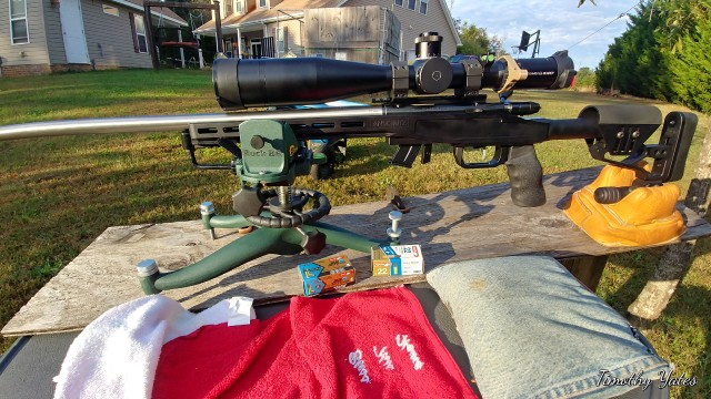

My friends 7 year old daughter was shooting the rifle I build her. It’s a Manners MSA-CS with the Vudoo 22lr , her dad stuck a Kahles 624i on top. She hit steel out to 215 yards, hit the 215 target 3 times in a row. The cool part is the stock is adjustable, so dad can shoot it too. Badass rifle for a Badass Shooter.

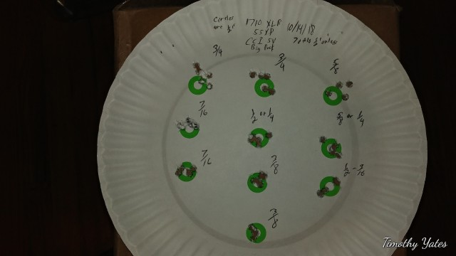

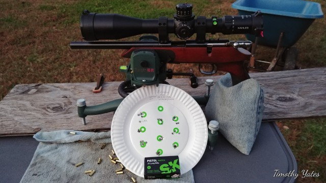

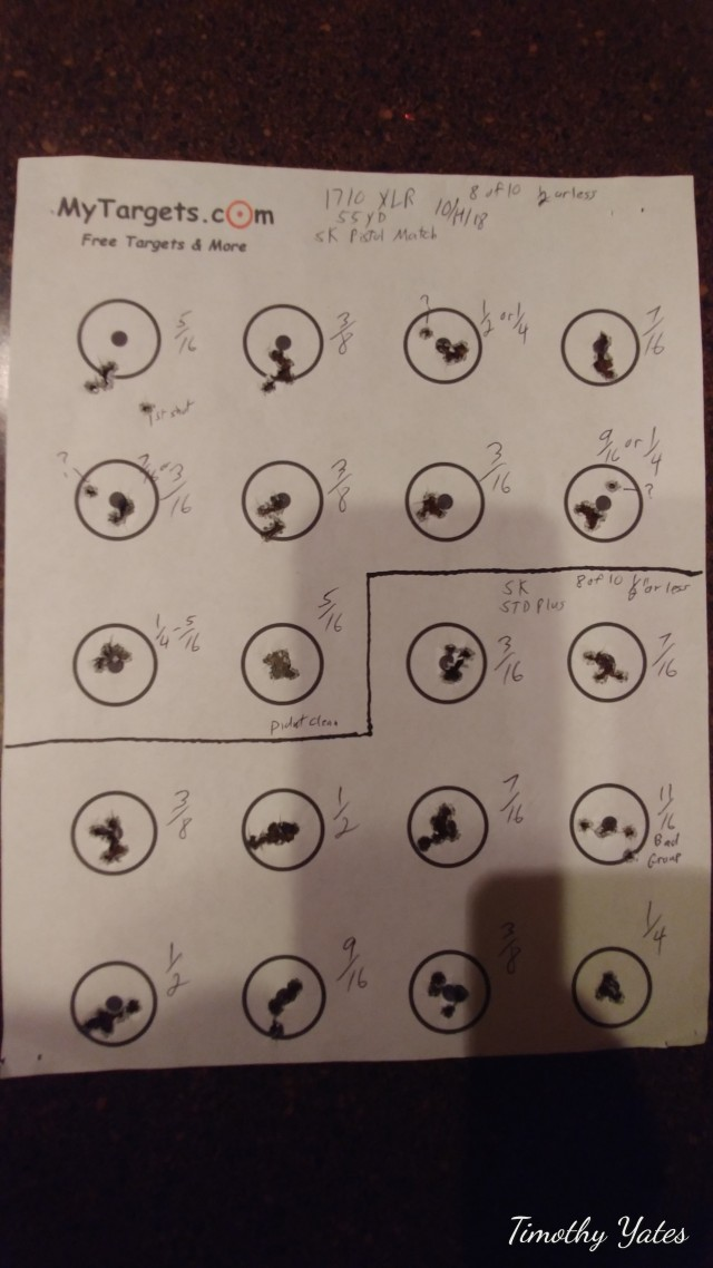

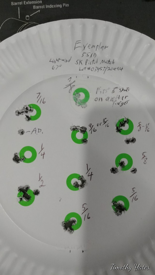

My Vudoo outshoots most of my dedicated benchrest rifles. Just did the first thorogh cleaning and it did before and odes now shoot in the .3" five shot groups at 50 yards. Saturday we were shooting a 200 yard centerfire match and in between relays we took the Vudoo to the line and first group at 200 yards was under 1". The following groups did nto shoot as well due to the wind . Just saying...........
Shooting SK Pistol Match
I just shot my 2nd 200yd prone match with the Vudoo and the only reason I am not winning the match is my poor wind reading. The match is 3 legs of 20 shots, this month shot a 589/600. Also shoot at 50 and 100yd benchrest competitions. These guns will shoot.

Why would SK pistol match shoot well in a rifle? Not intuitive but perhaps that is the way or rimfire rifles.
The most expensive 22LR ammo does not mean it will shoot better. My Vudoo likes Wolf Match Extra and Center X along with SK pistol and rifle match with pistol being a little bit better. I personally have tried a LOT of 22 ammo out of my 22s and each one likes different stuff. MY current lot of Wolf Match Extra is terrible in my Vudoo while the last lot was amazing and better than Center X even. It is the way rimfire works. :)
