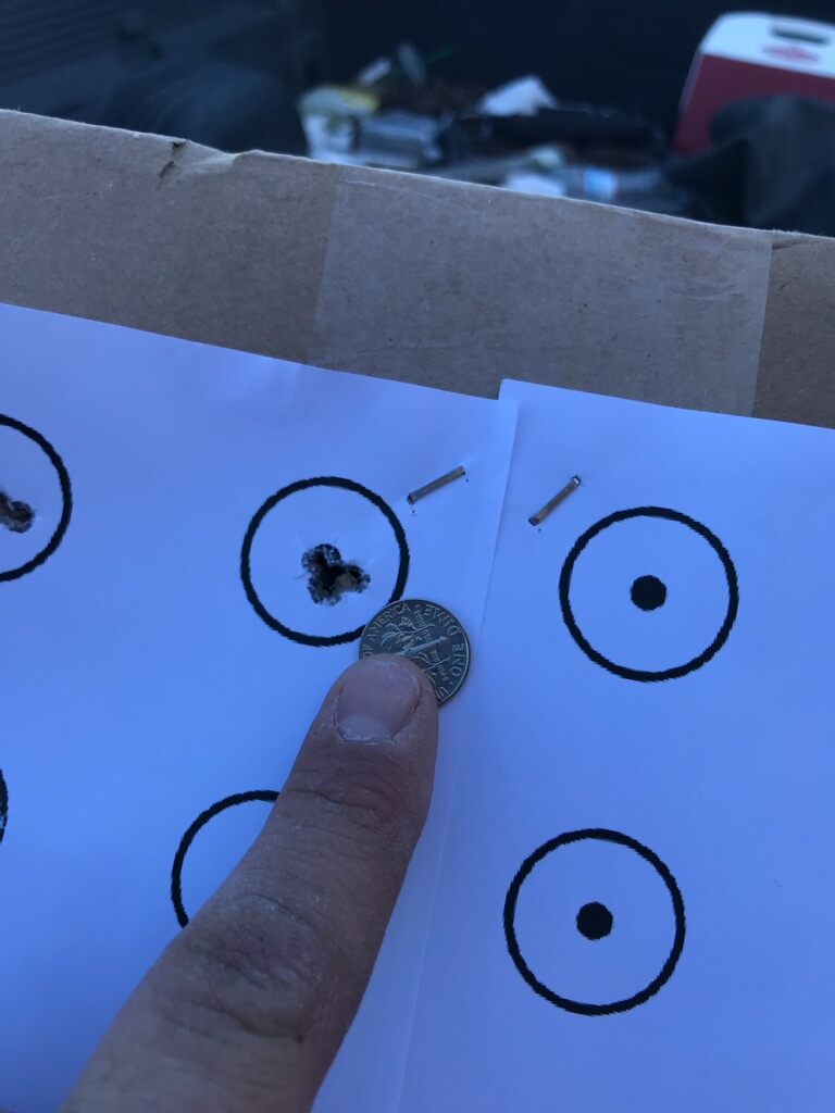

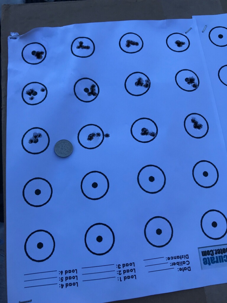

I've got 183 logged rounds of various "better" ammo shot in 2 outings so far with this rifle. (SK+, SK Rifle match, Center-X, ELEY Edge, RWS-50)
I would be happy if the April Colorado winds would die down for just an hour or two, or just stay consistent from one direction, please? It's frustrating trying to get an accurate baseline
These were shot with gusting winds at 7:30 to 8:00 5-12 MPH, switching to variable gust again but from 3-4:30 at 5-12 MPH
For the amount of wind variable involved, I'm actually happy . 5 rounds per bull shot left to right at 50 yds, bag supported off cement bench. Center Bull is 1/2" diameter, standard ARA test target.
