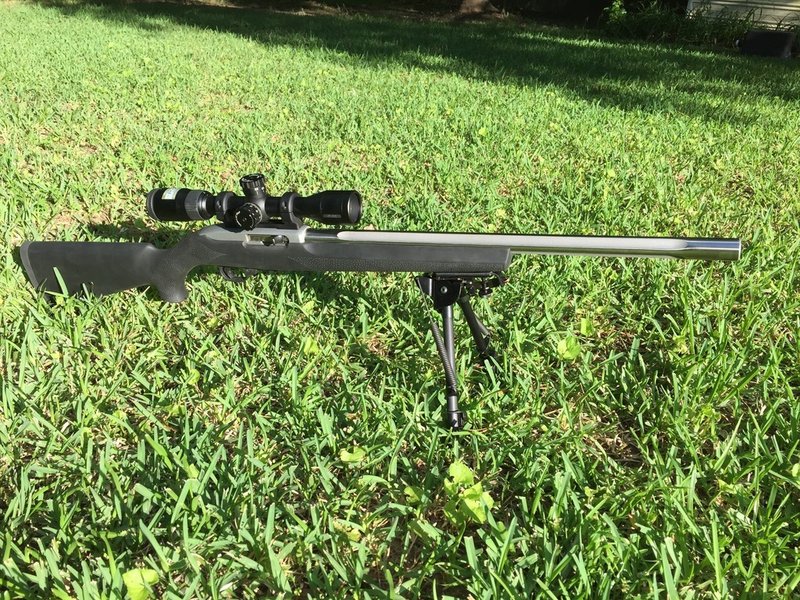

Luv my Titan, and the anchor on the rear is nice addition, no rocking in the stock. On my raptor stocks I added an anchor using the cleaning hole in the rear of the action.

From an engineering standpoint it is job well done. The ridgidity of the stock along with the bedding blocks make for a stable and solid feeling interaction between the shooter and the barreled action. The feel of the rifle in various shooting positions works well with the pistol grip and forearm gripping surface. I needed the cheek riser kit to make it functional from the prone position but the design and mounting seem to be well thought out and done. Coming with both sides, forward and rear quick disconnect points for a sling along with the basic sling and bipod mounts under the forearm were a nice touch. I added the Mini-Pic rail at a cost of $40...ouch but it works well with an Atlas QD bipod.
This is a very solid and versatile stock the feels familiar and lends confidence to handling and shooting this rifle. Right now I'm close to $250 with mine setup to be usable in a Tactical Precision rifle role.

I mounted my Kidd barreled action into the Titan and torqued to 20in/lbs. Went out shooting 2 or 3 times. A few days ago I was mounting a new scope and felt the action moving in the stock. The screw was loose. I retightened to 20 and then decided to go to 25in/lbs. It just felt better. I'll keep an eye on this over the next while. If it loosens again I may apply a little thread locker to the screw, let dry and then remount and torque.
