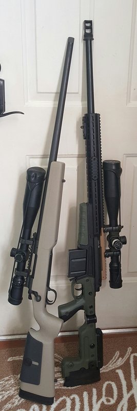

#17
You need that extra distance in a 700 action so the bolt knob doesn’t come off when you have a hotnround get stuck. Friend kicked the knob off his trying to get a round unstuck from an M40 in Central America.
If you can’t rebarrel an AI you have no business being a sniper.

#18
The McCann rail was the initial answer, but I agree with what yours saying. As I have both, I have a clear favorite BUT I don't run a clip on.
The MIRS is a cunthair closer to the center of bore than a typical chassis with continuous rail but it isn't a whole lot and it's still enough where you're going to want an adjustable riser. At that point it doesn't make much difference in how much higher it is so long as you're not talking inches.
The chassis also gives the user far greater flexibility for mounting IR lasers and illuminators vs a traditional stock.

#19
The chassis also folds and is much more durable.
On an AI you can take the whole thing down and put it in a small case. Talked to a military user that needed that sort of thing once. When you need it you need it.

A2 Probably a NSW turn-in BTDT version
Mine was built for me two years ago, before the BTDT stocks were out. If I was doing it over again, I'd have bought the stock kit here. You save a shit load of time, save some money (as it has everything but the barreled action) and these stocks have providence. A bargain for those building a mk13 mod0 or a 700/300 (if they just use a m24 scope rail instead of the McCann).
edit:

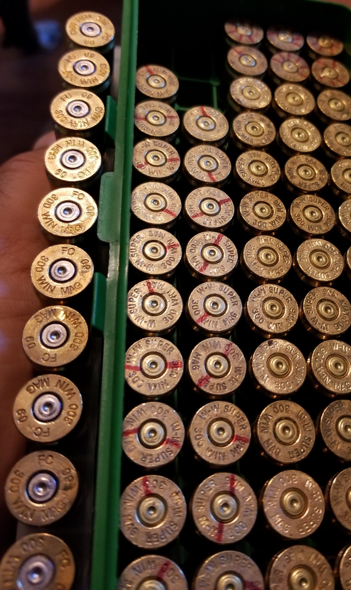

to expand on what Chad said, here is a pic of some of my handloads and some mk248 mod1, shot in my A191 chamber (m248 mod0). The 10 of the left were Mod1. The two rows with red are a 230gr Berger OTM load at 2780 and the ones on the right are a test with Sierra 210 SMKs at roughly 2810fps.
I shot these all at 1k on an IPSC. The 210 and 230s made a nice round ~10" group . I then loaded of the mod1s, made no corrections and shot 6 rounds. Every one of these was 9" higher than the group average and that ammo held 1" of elevation at 1k fir 6 shots. Group was ~ 7" wide, waterline. I was ticked shitless until I looked at the brass. Junk. Every one of them flowed into the ejector and had a slight crater. For a fire and forget case, no big deal but I would have to tweak my chamber and throat to get the pressure down.
something else to consider. Carl Kovalchik still holds the 1k Prone Any Rifle record with a 300wm shooting 220gr SMKs. Old 90s profile. This record has stood since 1996.

That is a McMillan A2 Inlet for the mk13 L shaped recoil lug. I ordered it to be exactly like they provided Crane in the 90s. I guess the Anschutz rail was added at Crane.
Looks slick, love the color. Great looking rifle. Those classic stock styles just scream "theres a badass behind this thing", instead of the newer and more common, "theres a video game, computer nerd, internet ballistician, wirelessly controlling this expensive, ridiculous, ( albeit accurate), comic book rendition of a rifle" and before I forget to mention....nice rifle.

My win mag is in a B&C sendero stock, and fielded with empty mag, its 12.3lbs with 26" tube. Want to change stocks and this mk13 bit is right on my radar. Just dont want to add significant weight
