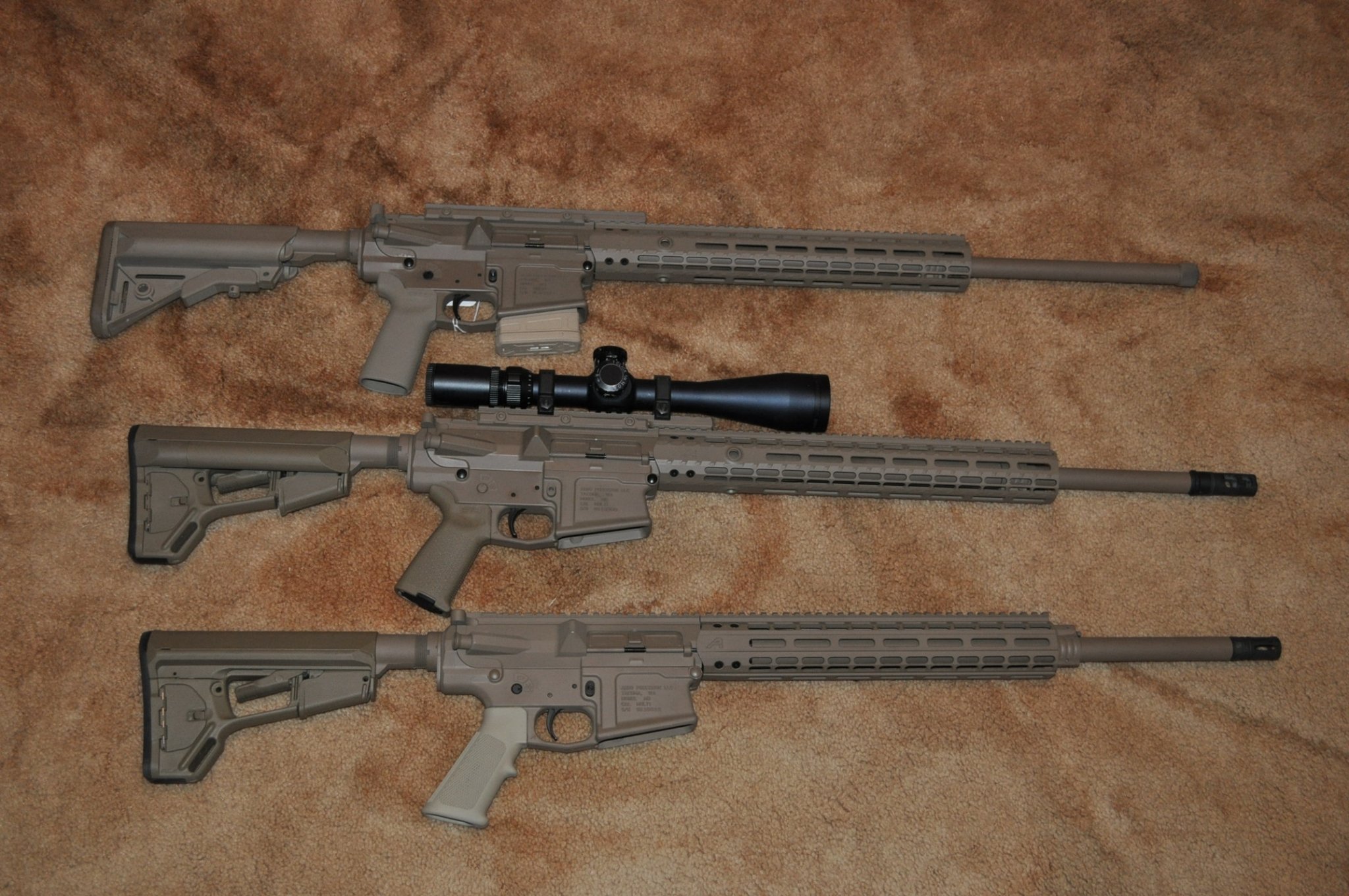

I like the Aero Precision M5E1 enhanced upper for the way the handguard is attached. Have put together for resale several of these using Aero Precision/Ballistic Advantage 22" 6.5 CM bbls. For a very reasonable charge, you can get the upper/lower/handguard CeraKoted in Magpul FDE. Also, they announce builder sets done in custom CK or HydraDip patterns every month.
These are the last three I've finished, from top down: 24" Krieger; 22" Krieger; 22" Ballistic Advantage. Top two have 15" enhanced M-lok handguards, bottom one is a 12" M-lok.
@flatland1, how do the Ballistic Advantage barrels shoot? I'm about to finish my creedmoor build with the 22". Couldn't find much info about them.
I haven't spent any time behind one of the BA 6.5CM bbls myself, so all the info I have is 2nd hand from customers. So far, I've not had any complaints on the accuracy, and the two guys who've bothered to let me know how theirs' shot were satisfied.

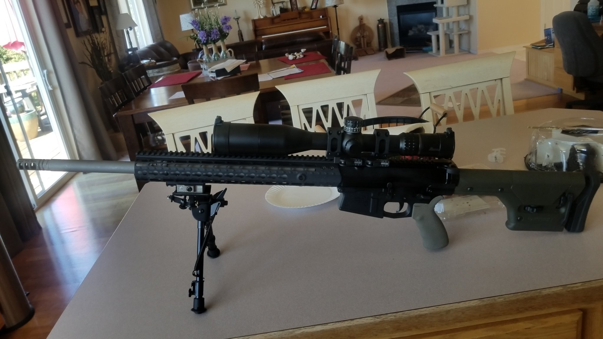

Here's my MEGA/22" 6.5cm Rock Creek Cut Rifled +2 Gas / SLR 16" Solo Ultralite and you can see how the entire AGB is exposed
Here's my MEGA/22" 6.5cm Rainier Ultramatch +2 Gas / JP MKIII Rapid Configuration 17.25" Handguard that covers the entire gas block
