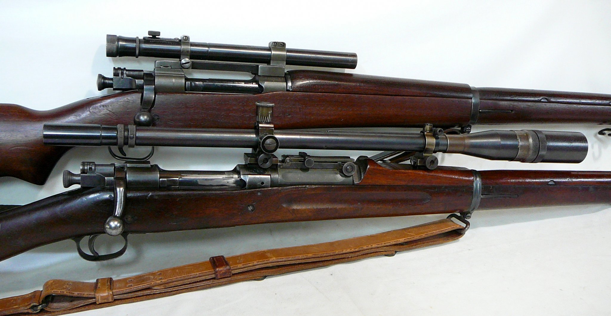

You'd have been better off shopping around for a Marine Corps 1903a1 mock up... They were equipped with Unertl 8x scopes I believe.

The main issue if you get the Unertl style scope is, they do mount on the 03A4 base. See the Unert scope has to be mounted at 7.2 inches from center to center of the blocks. So the clicks of the adjustment on the scope are 1/4.
See the 03A4 M73B1 is an internally adjusted scope. But the Unertl USMC scope is a fixed tube, and all adjustment is in the micrometer that mounts on the rear block.
I don't know of any way to mount it on your A4 without drilling and tapping the receiver and barrel. There is only one hole in the front nose for an A4 redfield mount, and the Unertl mount takes two. So you would have to ad for sure another hole in the reciever, plus drill the barrel. And just remove the Redfield style A4 mount, and add Unertl O&E blocks.
You would be better to find another internally adjusted scope.

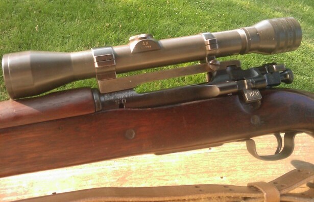

To answer your question, the Leatherwood scopes are good and brighter than the original Unertls. However the Chinese screws used on the mounts are too soft and need to be replaced. The turret clicks are iffy, and typically better on a real Unertl, but for $550 the Leatherwood is a good scope and mine has worked well since 2012 (I replaced the screws around 2015, as a pre-caution).

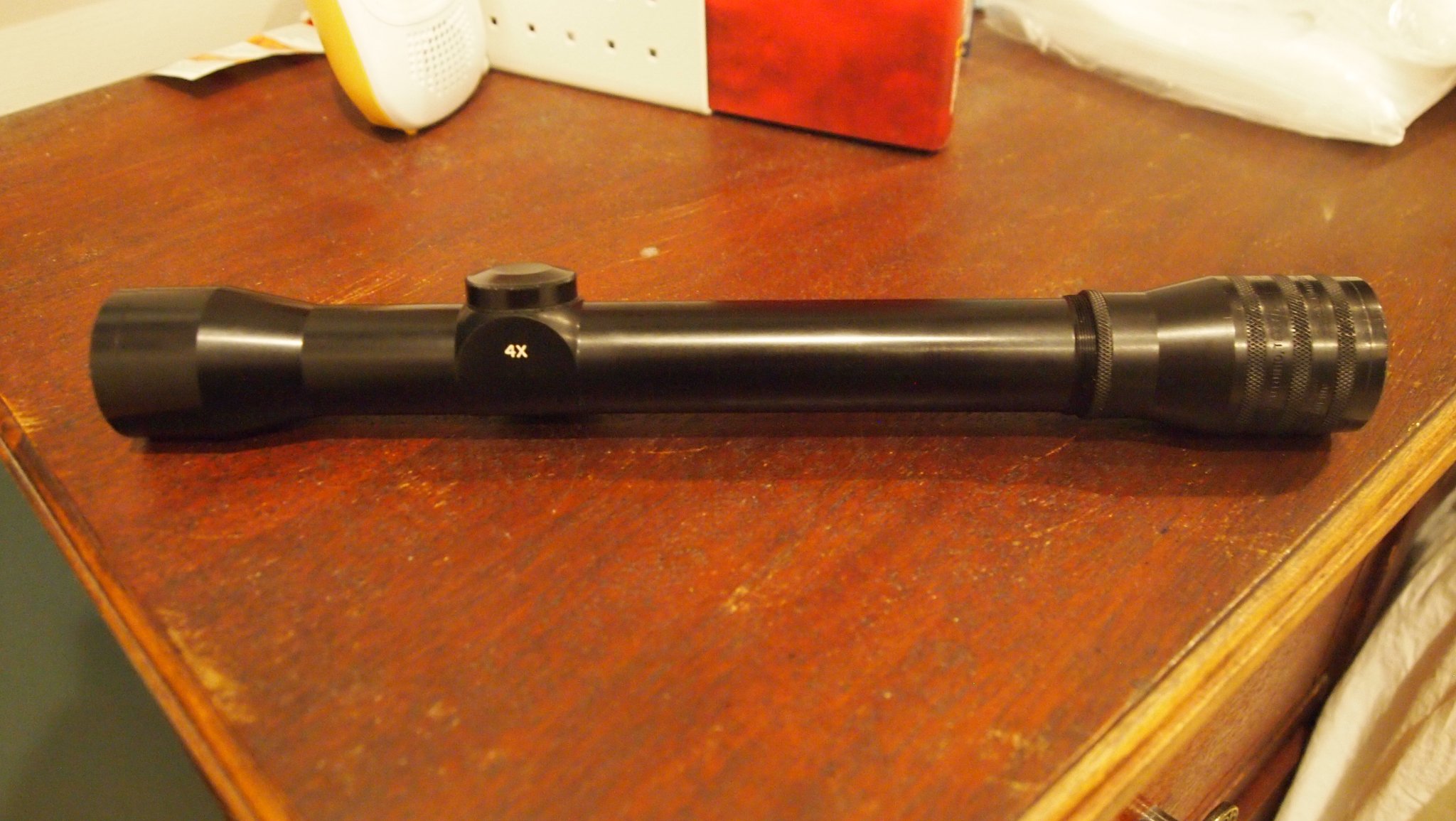

Years ago I spotted someone with a 1903A4 but with the civilian version of the 4x Bear Cub. That scope can be bought for $150 or so, and is is decent for the money and its a real 1950s era scope. They even have a nice dark grey finish (tube is 26mm diameter, and aluminum). The USMC used a similar scope called an MC-1 but they are $4k scopes with large, click-adjustable turrets. Very rare.
A lot of guys think this 4x configuration is not historically correct as only C.J. Harrison's book makes any reference, but my guess is some Marine made 1 or 2 for testing back in the 1950s and Harrison saw it, or heard about it so he put it in his book.
Anyhow, I noted that the front handguard was sanded down/notched to allow clearance for the front bell. Not crazy about that, so I think the slightly higher rings would look better. It is possible that CMP might allow this configuration, but its controversial.
Personally I would not put an 8x Unertl or 8x Leatherwood clone on an 1903A4 as it would look really odd as the military never fielded an A3 with that long scope. I suggest a 4x scope with taller rings than shown above as an option if you can't stand the 2.5x scopes.
BTW, I have seen guys shoot at Quantico with a vintage 1903A4 with a vintage 2.5 Lyman Alaskan with a cross hair reticle and make good hits at 1000 yards. In 2017 this guy let me try 2 shots after the competition with this rifle with that 2.5x scope, and much to my surprise - I hit the 9 and 10 ring at 1000 yards that day with those 2 shots(!) I think it was mostly luck, but I wanted to mention it nonetheless, as this configuration at least looks "correct". The reticle is pretty thin in the vintage scopes, possibly thinner than current reproductions.
Good luck with whatever you do, but a 4x "vintage" scope with internal adjustments would look much better on a 1903A4 replica.

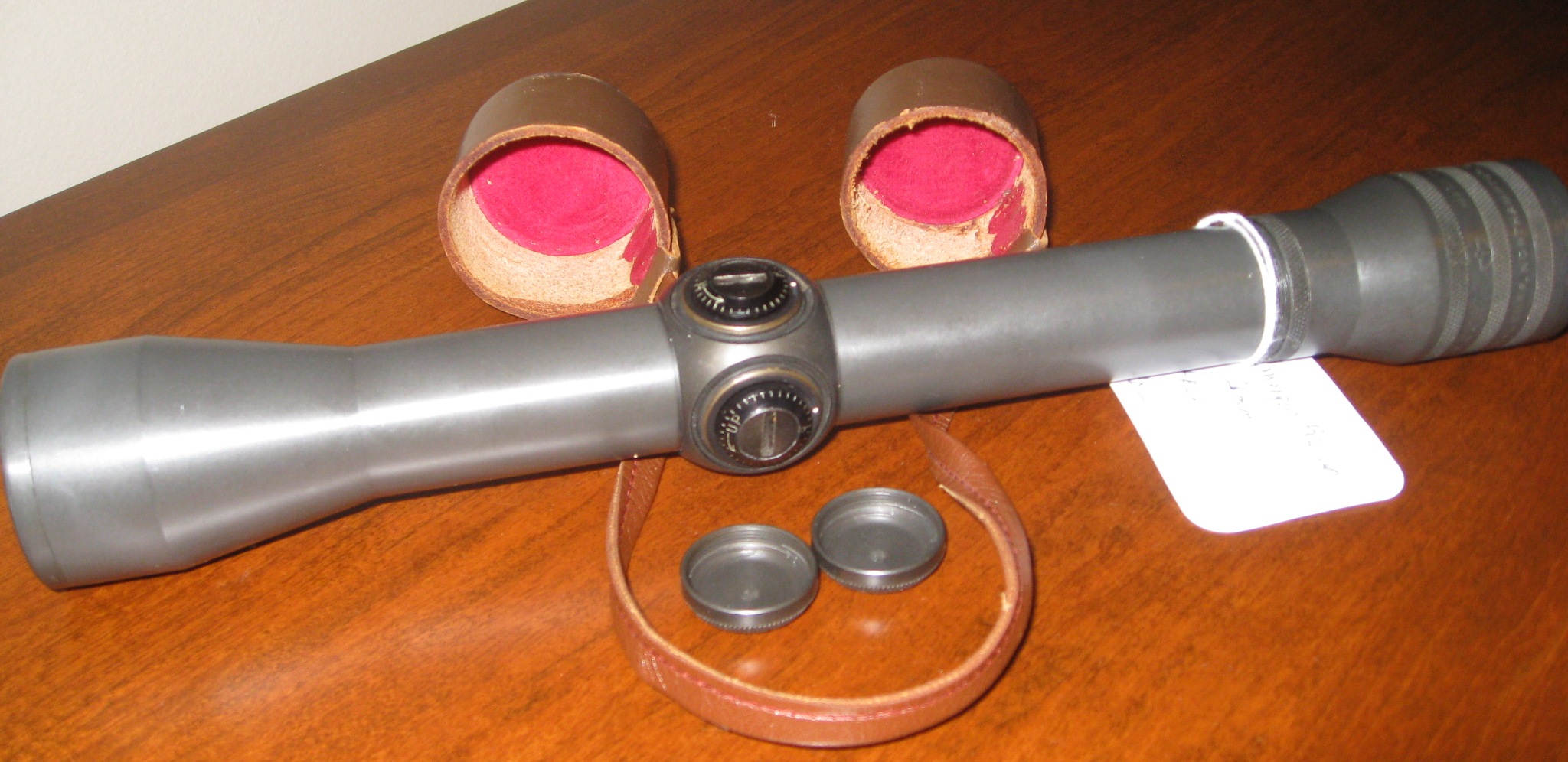

I have a 4X Kollmorgen with the commercial capped coin slot turrets.
It is vey clear and exudes quality.
Lots of brass in manufacture.
I'm thinking the adjustable turrets used the coin slot somehow just as an add on to the commercial scope rather than a complete new assembly.

I think they are different. Don't quote me, but I remember in those documents from Kollmorgen they talk about the bear cub and USMC style scope and there was a big price difference to the Govt between them. I don't think it was a simple conversion. But it's been at least two years since I read those docs, so I might be wrong.
Here's some pics of it. I'm not that familiar with the commercial one, other than in passing.

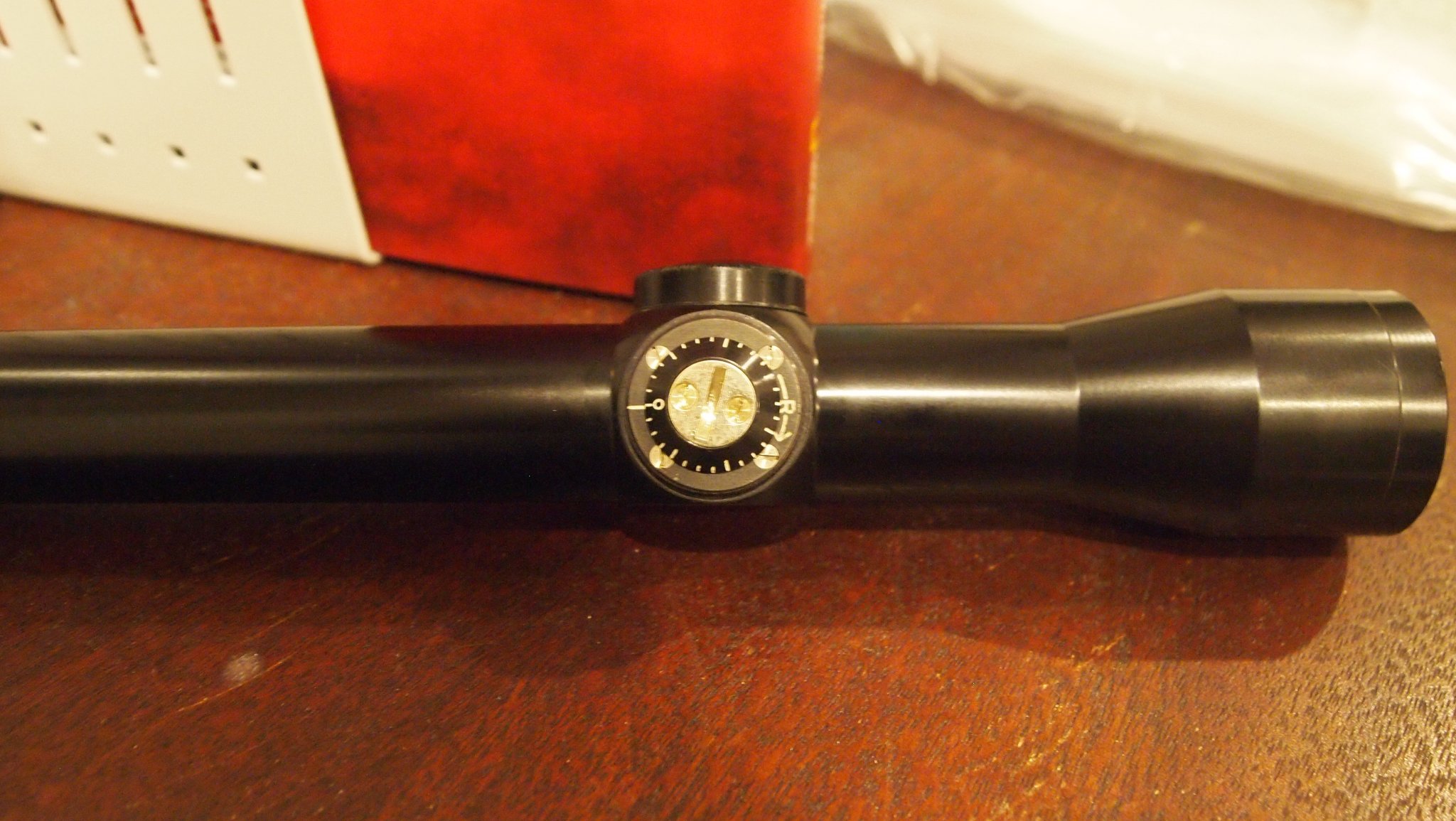

Body of commercial looks similar, erector housing may be closer to center, and If I recall right when you open the caps there are two screw on the brass coin slot system.
I'll go down and get some pictures after dinner
I'm wondering if bottom cup screws down on existing cap threading than marked adjustment cap fits over and gets screwed down onto adjustment mechanism.

The civilian Bear Cub has simple "coin slot" turrets that have no detents. The USMC turrets have click adjustments with all kinds of springs and small bearings to give it both audible and tactical adjustments (1" inch per click at 100 yds for both windage and elevation). Very different turret design b/t the military scope and civilian scope....

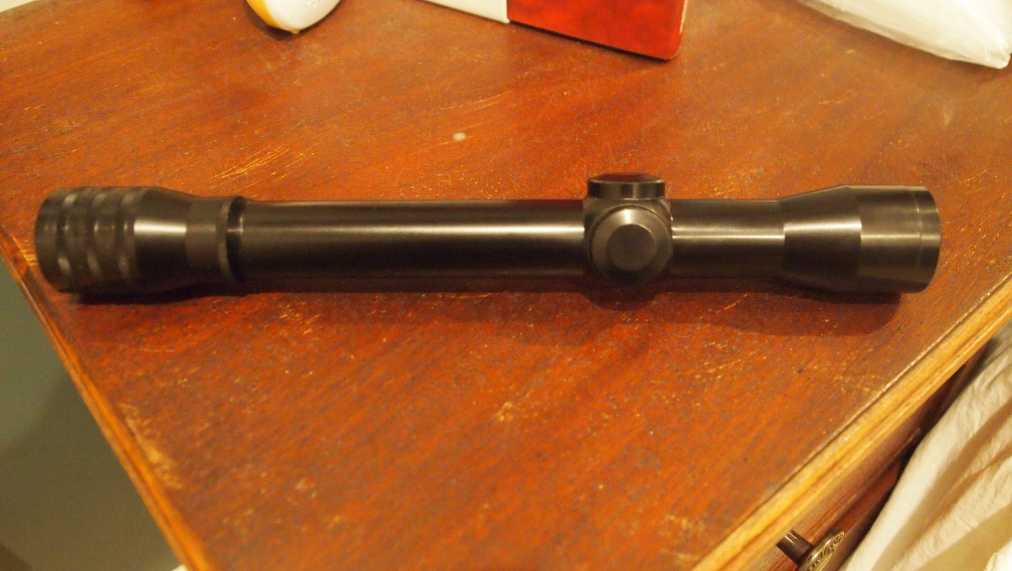

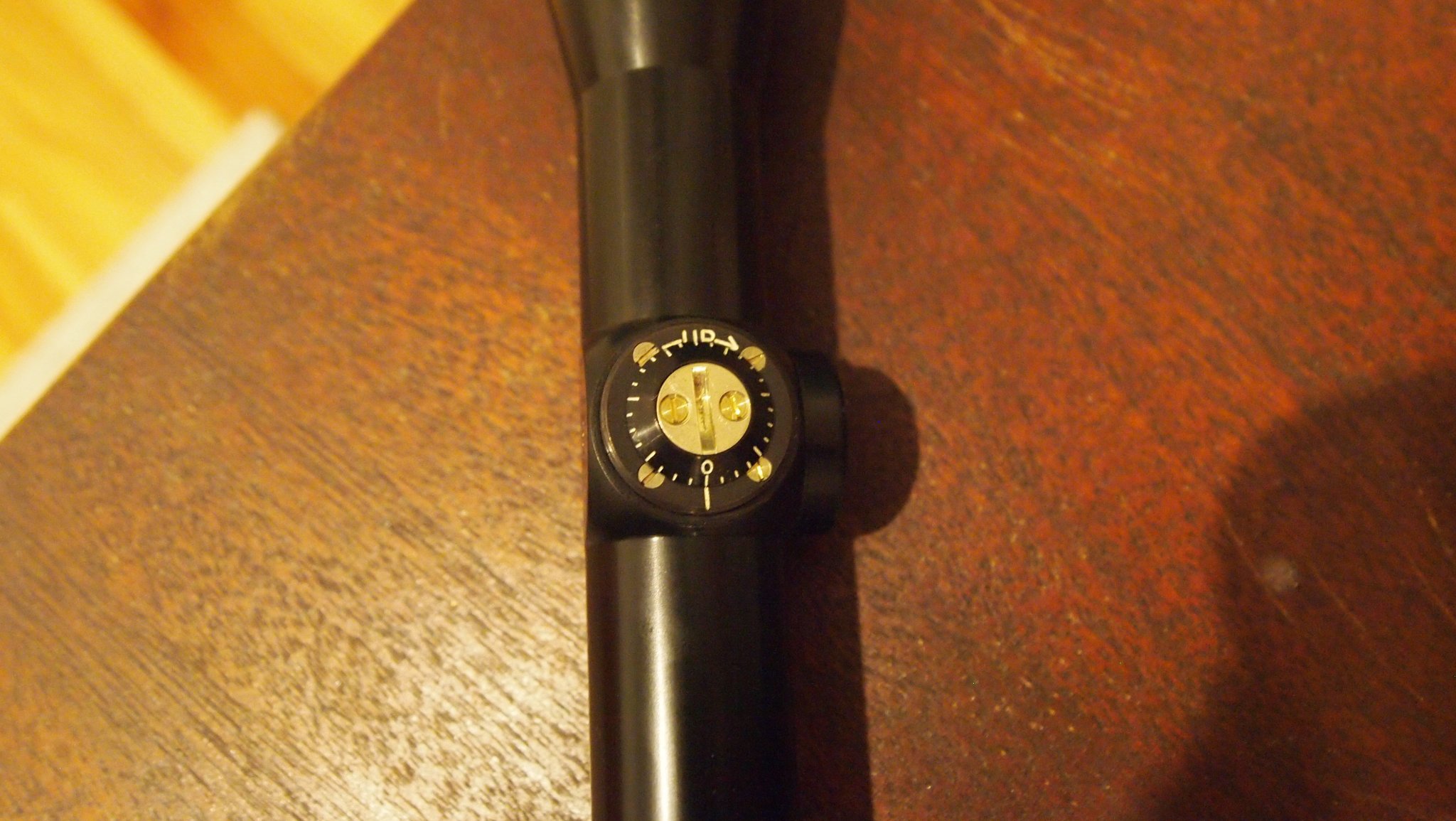

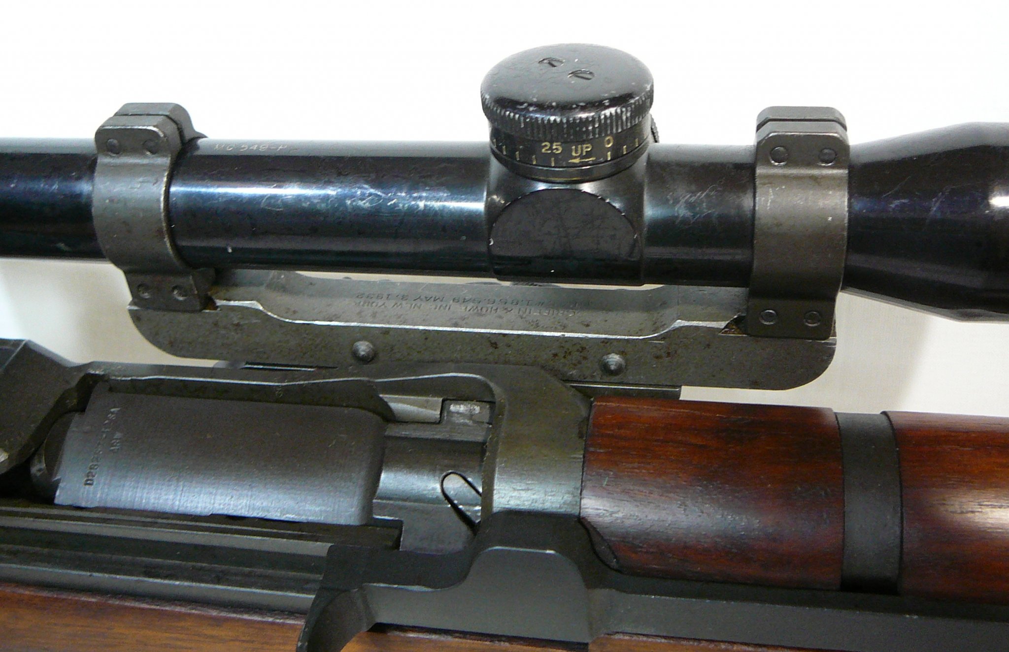

Here is my Stith Kollmorgen.
The outer profile matches the USMC scope despite my memory thinking the erector housing was closer to center.
Its a tank of a scope. Clear view and razor sharp thin crosshairs.
and the turrets.......
Elevation
windage
Note the screws on the adjusters.
Im guessing this scope and the USMC scope have a lot in common.
I dont know whats under those MC-1 scope caps but Im thinking a gear and a toothed clicker is all.

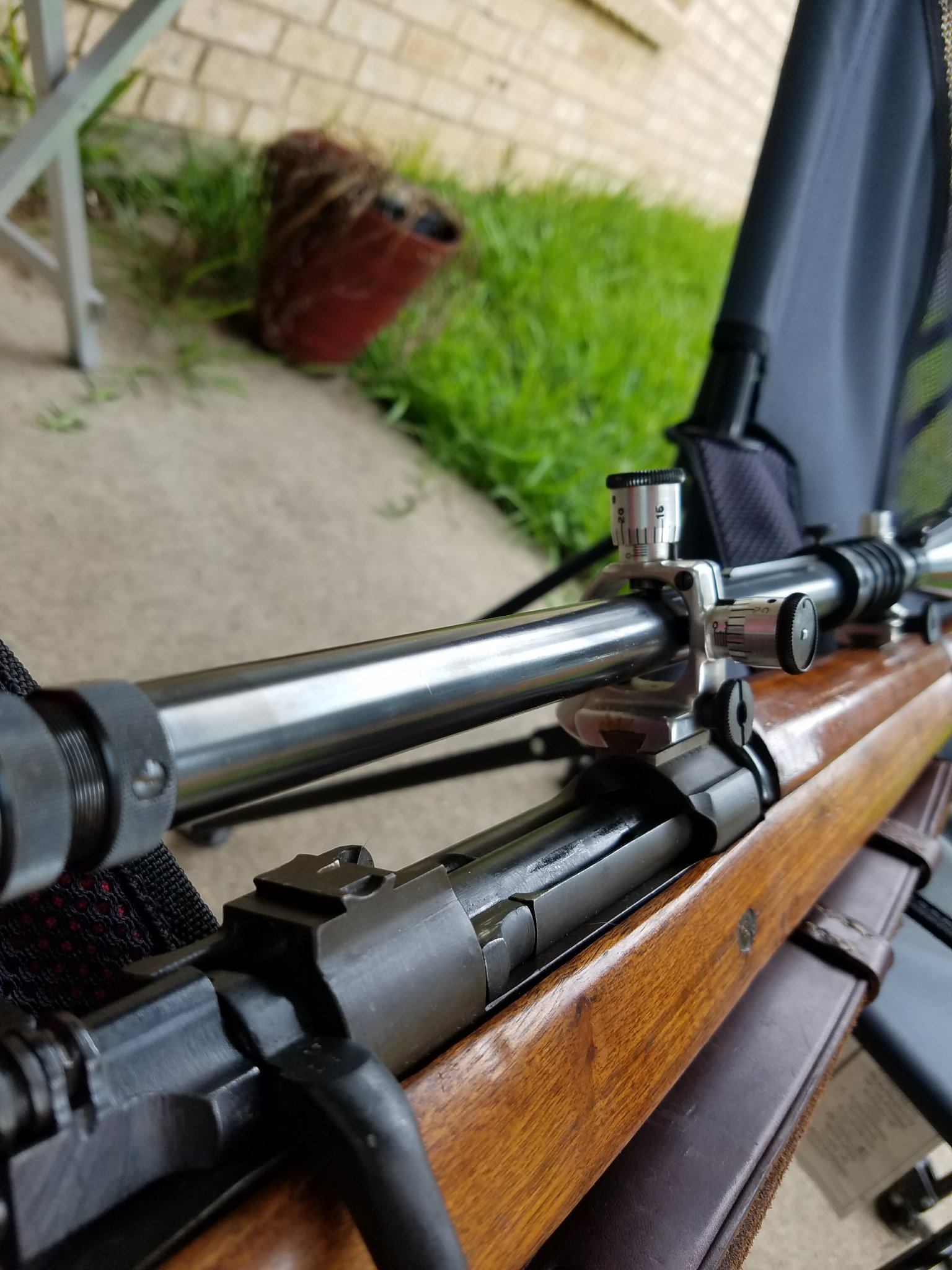

I have a leatherwood 8x on a 1903A1 and an Unertl 15X Ultra Varmint on a Model 70 Bull Gun. While the leatherwood scope is good the mounts are terrible if you do anything other than leave them zeroed and the bases are soft and deform easily. The unertl mounts with the clicks are vastly superior in construction and operation to the leatherwood. If your just looking for a shooter my recommendation would be to find an unertl with a 1" tube as they are much clearer and brighter than any of the 3/4" ones.
However if you decide on nostalgia and go with the leatherwood scope DZ Arms makes a set of mounts that match the quality of the unertl mounts.
